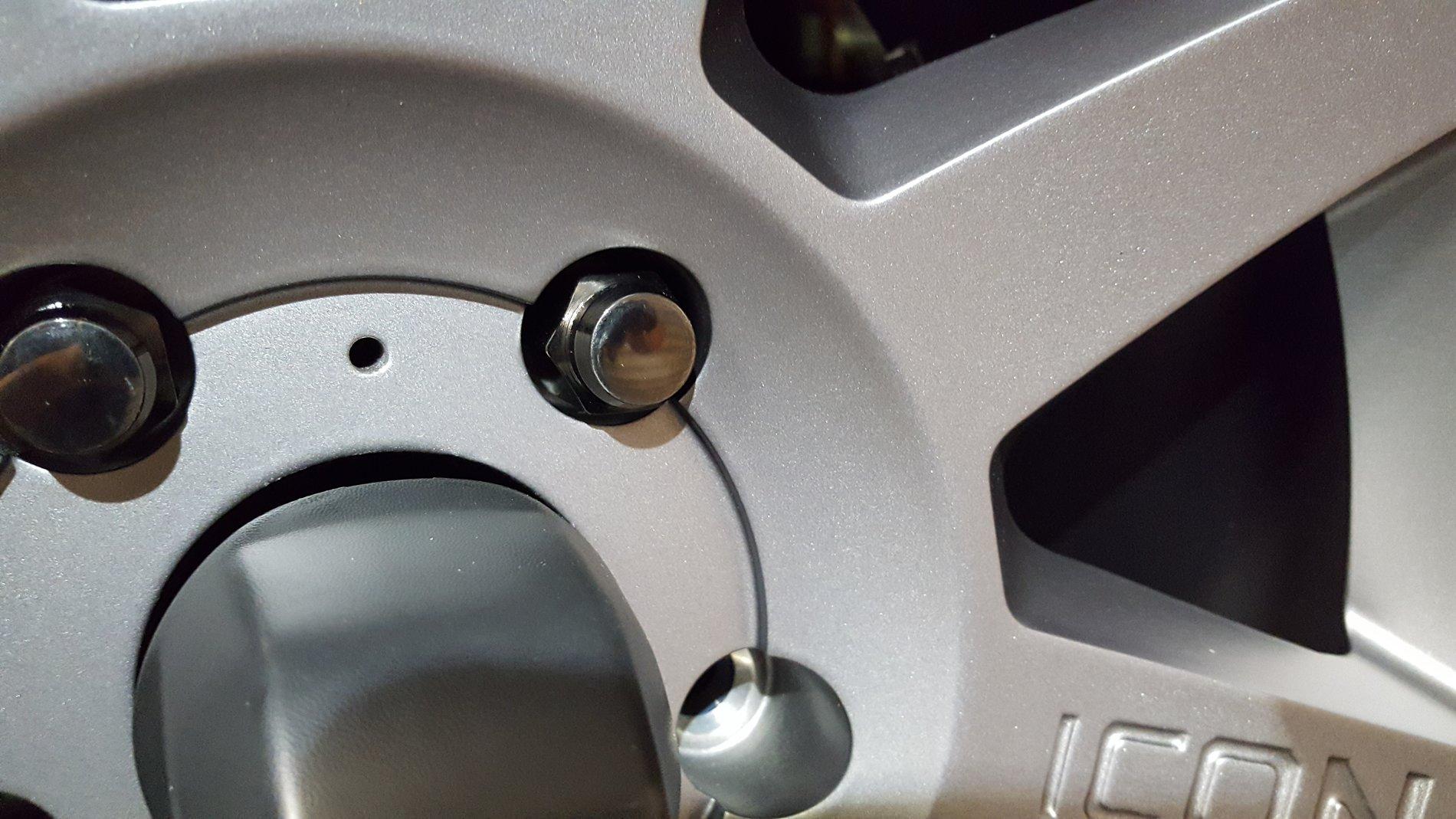

I was considering purchasing this set of Gorilla's from Quadratec:
https://www.quadratec.com/p/gorilla...-23pc-kit-78-hex-14mm-x-1-19-jeep-wrangler-jl
Here's something for comparison. I have the Mcgards with a 22mm hex head (0.866") and 1.6" long. The Gorilla's are 7/8 (0.875"). Both have the same M14x1.5 dimension. My ICON Rebound's lug nut hole has a 1.15" inside diameter. A 13/16" and 21mm socket are the largest socket sizes that will fit. I started to order an extra thin walled 22mm so I could keep the Mcgards but I doubt if that would fit. You can see what I mean from this pic. I'm getting M14x1.5 spline nuts tomorrow that are slightly thinner and longer. Got my fingers crossed.

Keep me updated as I believe this is the exact scenario I will be running into. Looks like I will have to order a set of spline lugs as well to make it the easiest to work with and to maintain my sanity.
