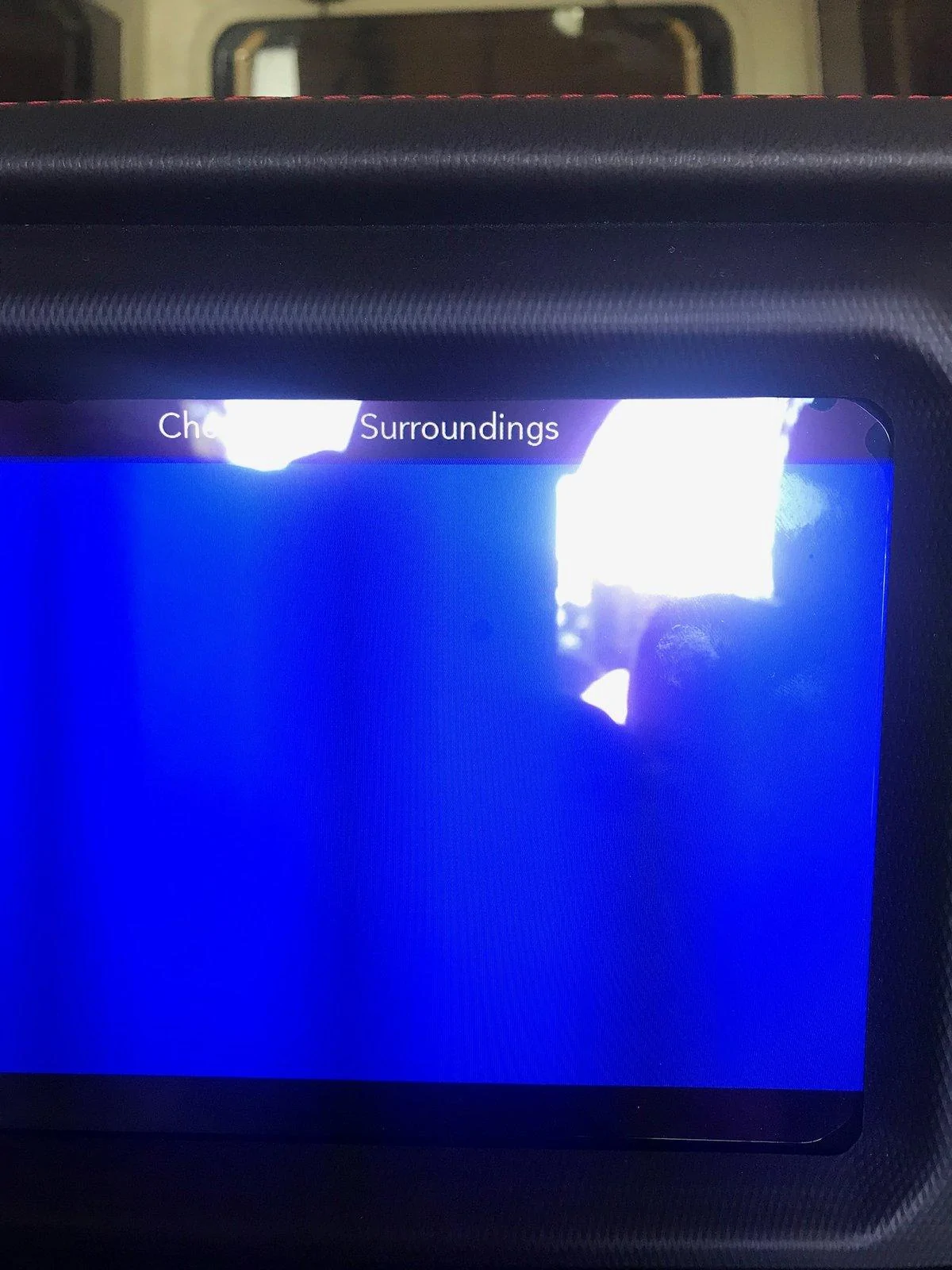

View attachment 227648 View attachment 227648 Beautiful day in Pa today so I took my Rubicon out for a ride, it had been sitting in the garage for about 3 weeks. I put it into reverse and got the ā€œblue screen of deathā€, radio volume was 1/3 of what it should be and intermittent audio, 5 seconds of audio 1 second of silence repeatedly.
I guess they’ll document it for me when they change the steering damper.
The third time I shut the Rubicon off and back on the backup camera worked and the intermittent audio stopped however volume remained low.
1,940 miles
1,940 miles
