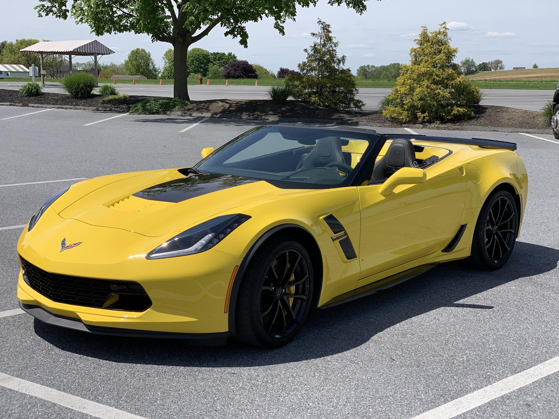

I sold the 2019 Jeep Rubicon JL that I ordered. one year old and 2,500 miles and they couldn’t fix the infotainment system. One day its the sound and the next it’s the camera....tooo frustrating for me. What makes this worse is the fact that they knowing sold me a Jeep with known issues and continue to sell them. Bought a new C7 it can’t be driven in the colder months and it may not go over rocks very well but THE INFOTAINMENT SYSTEM WORKS! I have the mopar tube doors if anyone is interested.
