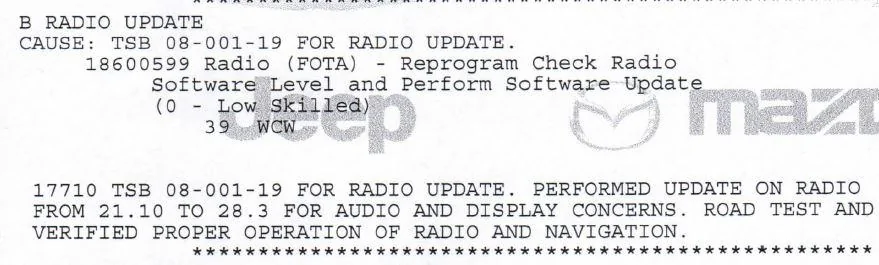

Update 1/27/2020:
Radio updated to the following versions:
Software version
Old: 18.23.29
New: 19.11.4d
Application version
Old: USA-IR-21.10.0-20180605-I09W
New: USA-ASO-8.4-MR-28.3.0-20190314-M0G3
BootMicro version
Old: 18.10.01
New: 19.11.01
EQ version
Old: 3.4
New 4.1
Work order invoice
Jeep Wrangler JL Weird uConnect/Radio issues/fix InvoiceNotes

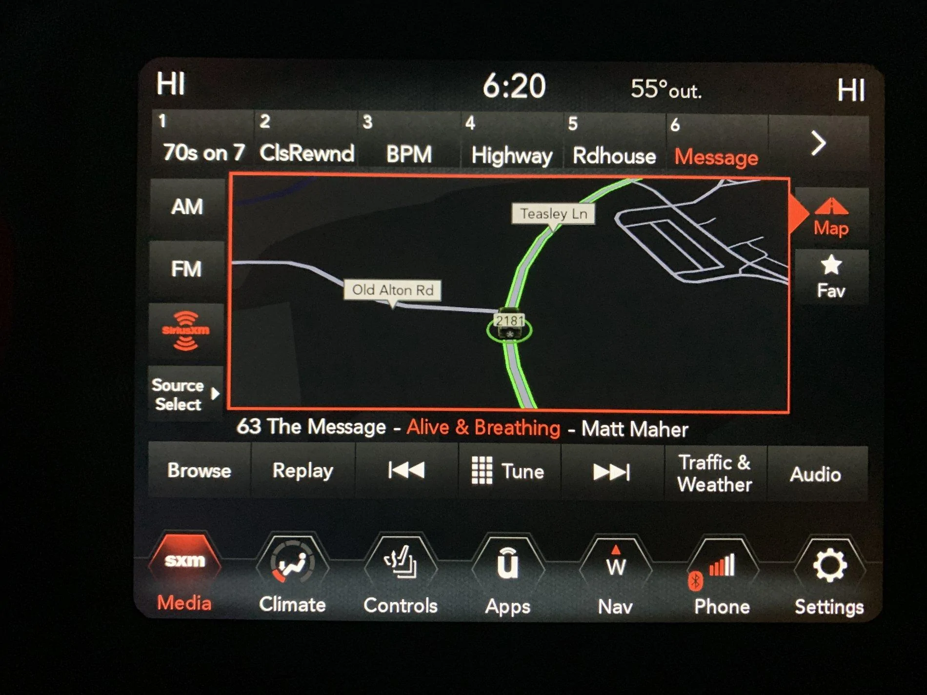

Visual differences I noticed right off
Jeep Wrangler JL Weird uConnect/Radio issues/fix newmapvi
Only time will tell if this update has fixed all the issues I've had with my uConnect radio. Especially the extreme low volume problem.
