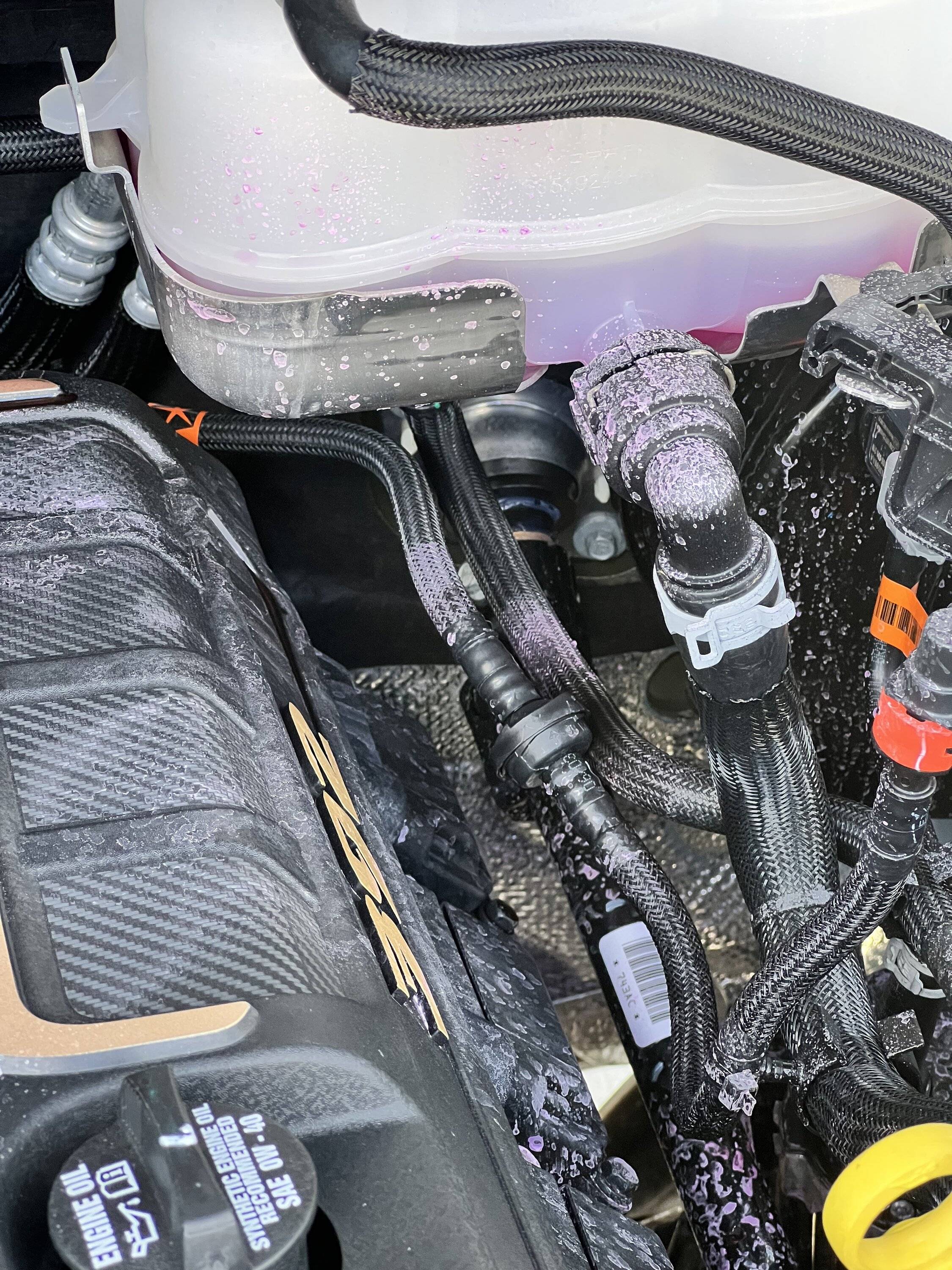

Update. Not what I/you expected...
I opened the hood to install hood struts and saw coolant fluid splatter all over the hose connection and engine. I sent a pic to the dealer, who asked me to rush to service. Turns out the reservoir has a hairline crack in it. Part ordered, will be replaced on Tuesday. I was bummed about not taking it off-road yesterday more than the problem itself, but all in all, it's better I discovered it 5 miles from the service center and not 100 miles into the woods. It happens, and I'm not too upset about it. Hopefully, nothing else down the road.

Good thing you popped that hood, OP. Those struts may have kept you from accidentally running it out of coolant. ?
