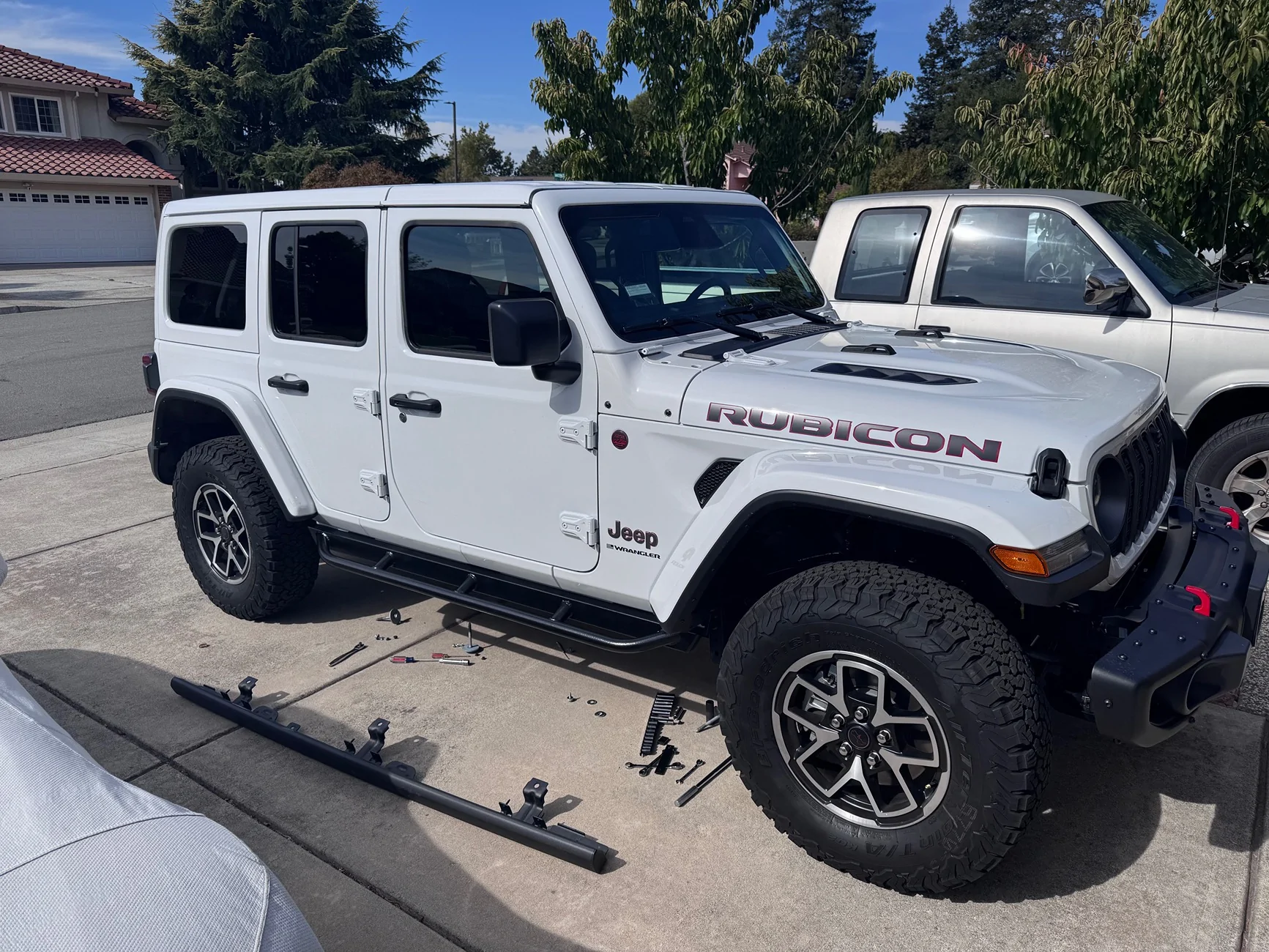

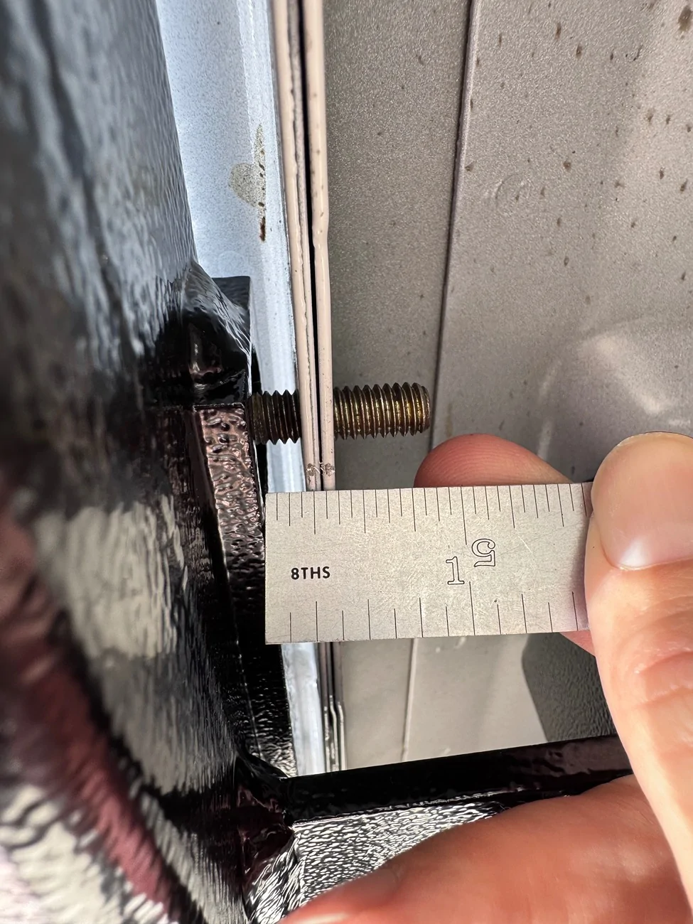

Hi folks. My first post - just bought my 2025 Rubicon about a month ago and I’m installing some rock sliders on it. I decided on Rock Hard, ordered them a couple weeks ago and attempted installing them today. I am disappointed.
The big problem is the fitment. There’s a significant curve to the main rail. With one nut tightened on each end of the pinch weld, there’s a 3/16” gap at the middle. I called Rock Hard and the guy said I should just tighten up the middle nuts to close the gaps. Really? 3/16” seems like a big gap to just tighten up… if it closes at all I think it’ll distort my body panels.
Jeep Wrangler JL Underwhelmed with Rock Hard sliders IMG_7505
The stock rail fit fine. The pinch weld is straight. If I hold a ruler up to the new slider I can see the same gap. It’s obviously warped.
There’s also a 1/8” gap under one of the body bolt mount points. Have others had this problem? Do you just crank down on them and not worry about it? Or put in a few washers as shims?
Also, I have a problem with the low-quality hardware that comes with the kit. Why would they provide class 8.8 bolts to replace the class 10.9 body bolts? 8.8 won’t handle the 79 ft-lb torque spec (not like Rock-Hard tells you the torque). And people seem to have enough problems breaking the factory body bolts, do we really need to downgrade them? Whatever, I can buy the correct bolts from McMaster.

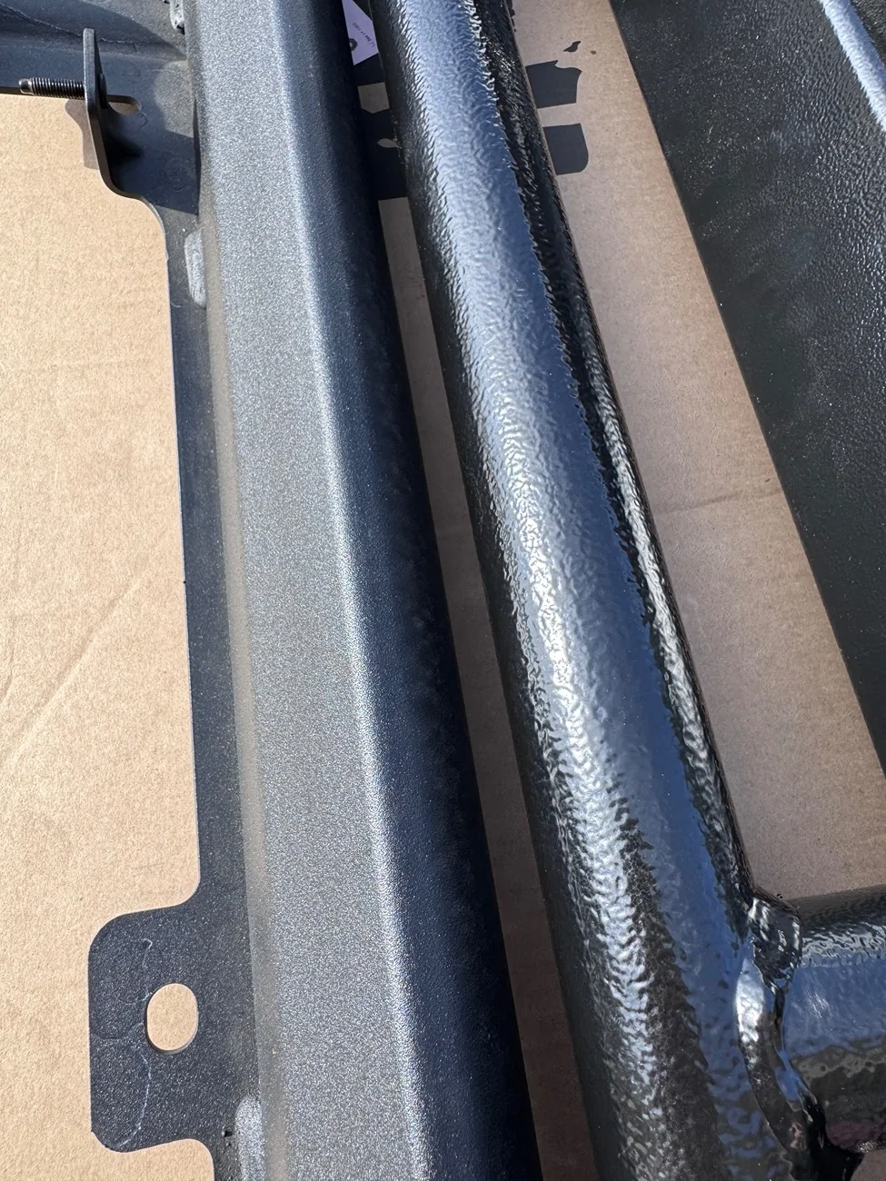

And finally, are you guys happy with the color? I find it to be a really coarsely textured, glossy black that contrasts with the other black trim on the car. It doesn’t look like the factory rails or the bumpers at all. Maybe it’ll look better when it ages a bit?

No issues with set I installed. Solid design (3/16 thick rails) that's held up well with a lot of hits. I reused the factory body mount bolts. There's supplied spacer to install if there is a gap with body mount. Sequence the bolt tightening in stages the pinch weld metal is easy to flex

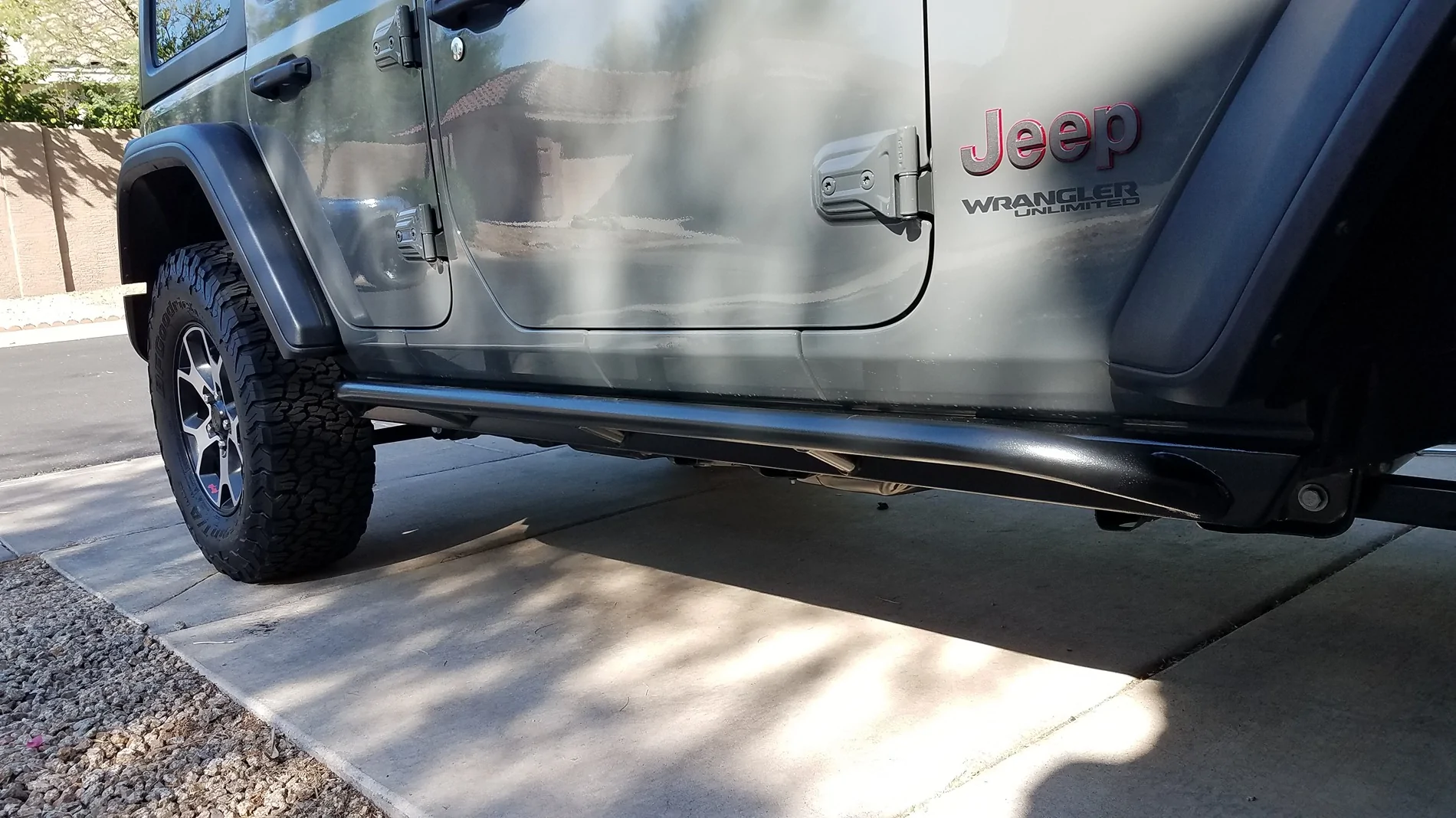

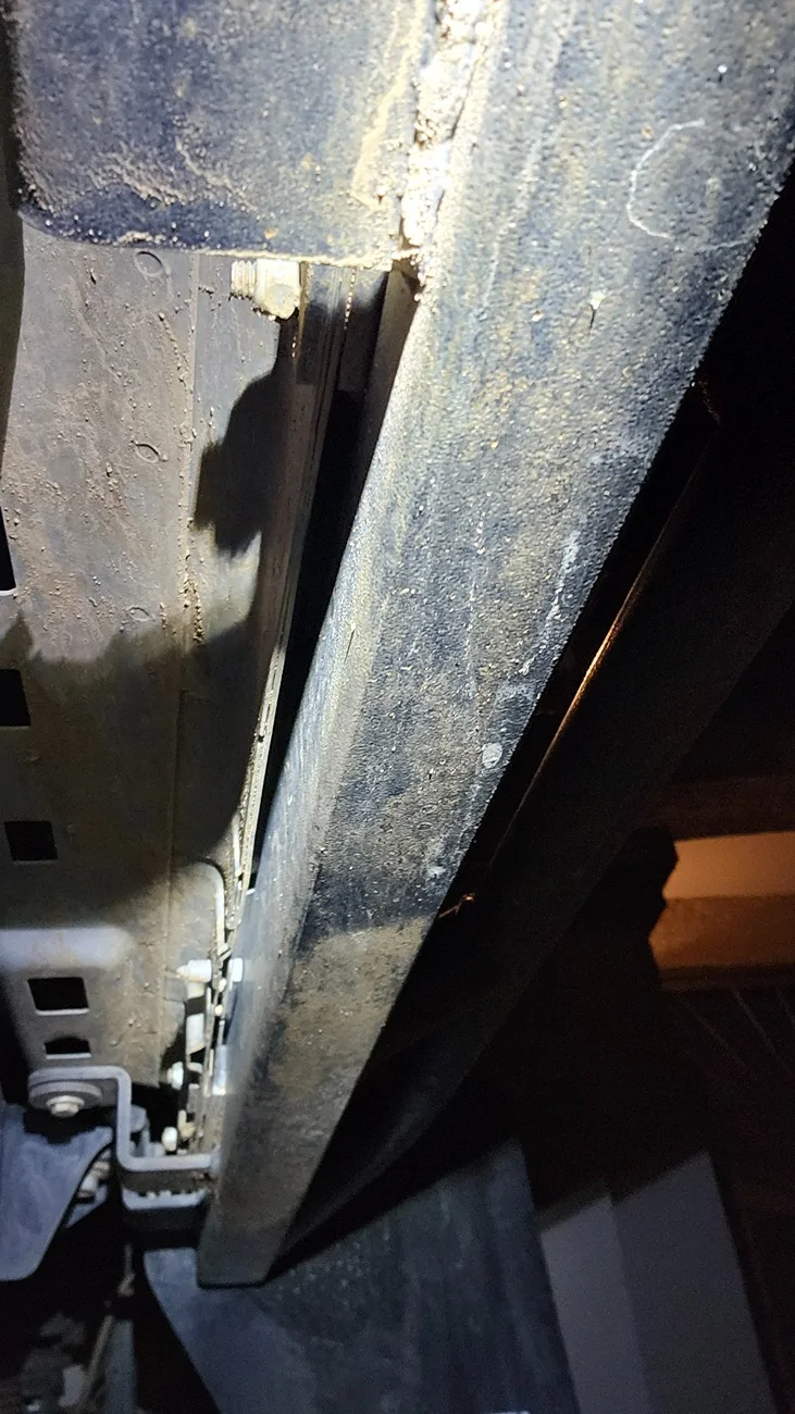

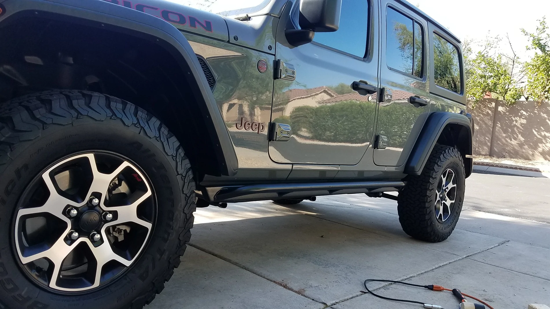

It's been a few years so i can't remember, were there shims that came with the sliders? And are you sure the sliders are curved and not the pinch seams? I recall the pinch seams being pulled against the rails when tightened but don't recall how much.
The quality of these, at least mine, are amazing. The only thing is over 4 years the powder coat in front of the small cross tubes has been pelted by stone enough to wear it away a little which is expected.
Id buy them again tomorrow if i had another jeep.
I'll look under mine when i get back to town and take photos of where mine mounted up

3/16" isn't horrible. I would still shim it.

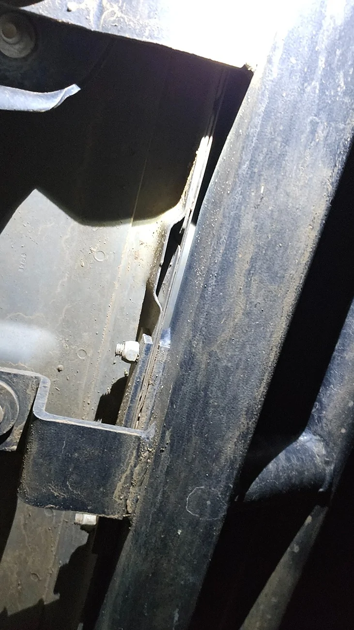

Just peeked under my jeep tonight. Looks like i have no additional spacers/ shims being used on seams, just the rectangular part welded to the rail and the rectangular washer.
Question, are the front and rear mounts flush and just the middle isn't? And are both sides like this or just one? Do the body mount holes line up correct when you have the gap? I know on the instructions/ video and from the parts provided the are thick shim washers for the body mounts, can't recall if there were for the pinch seam mounts.
Also if you have a laser level, or even a 4' level you should be able to see if there is actually a bow in the rail as opposed to the pinch seam being a little off straight. For 3/16 though i would just go with some stainless thick washers for that area and not be at all concerned. These are truly solid and when snugged up they really become one with the jeep.
