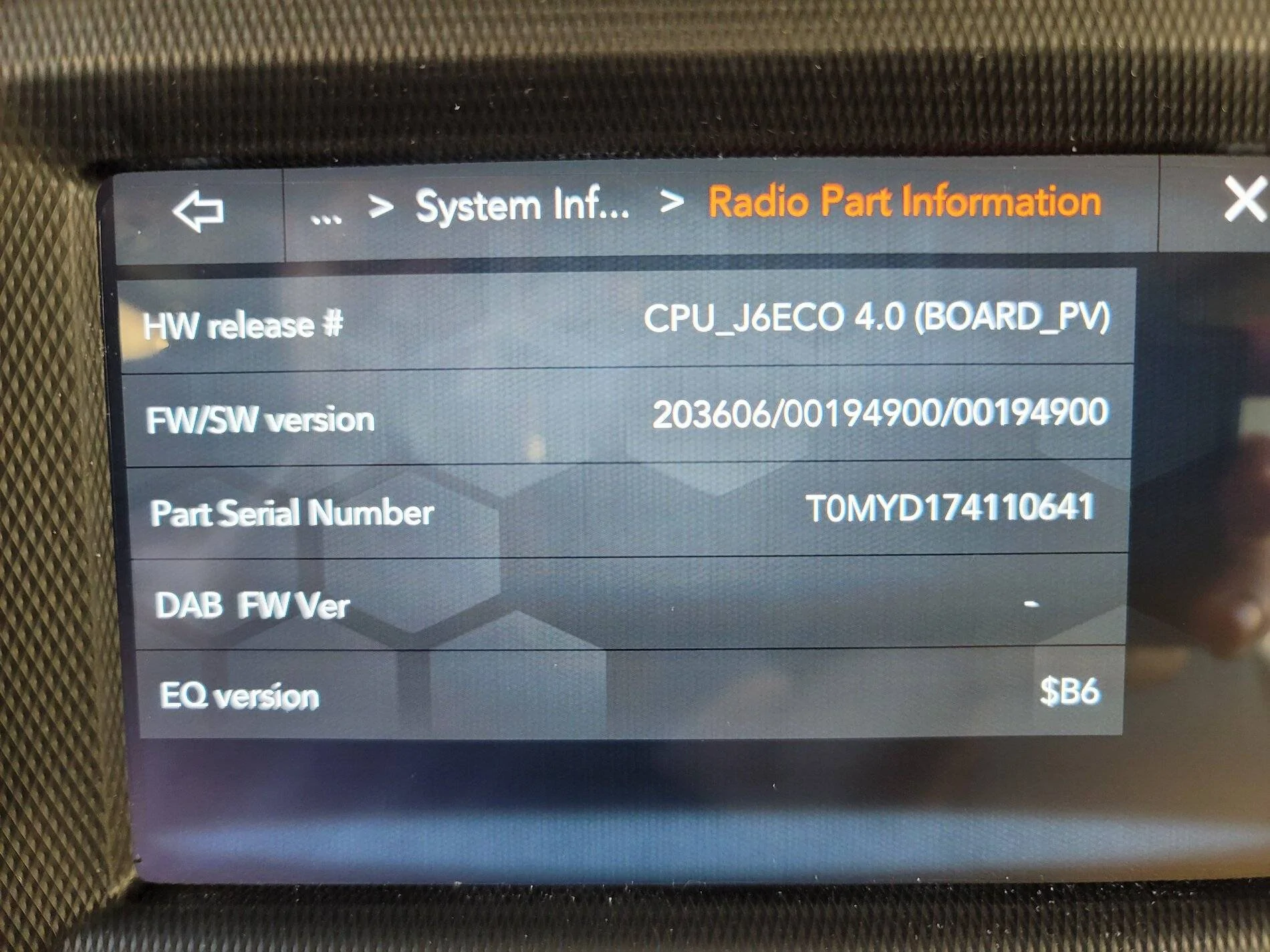

Hi, I have a newish 2021 JLU Sahara that was built on June 29, 2021. I did the 3 button push to find out the software version and my screen looks very different from everyone else's. It's the 7 inch screen without the navigation. If it helps, I did get the upgraded Alpine system with subwoofer.

Thanks for the clarification! Where would I go to see the latest updates for the 7" version? My Jeep was built on 6-29-21 if that helps.
I wish I could help, but I have no idea. You may want to start a new thread, so 7" owners can see it.
