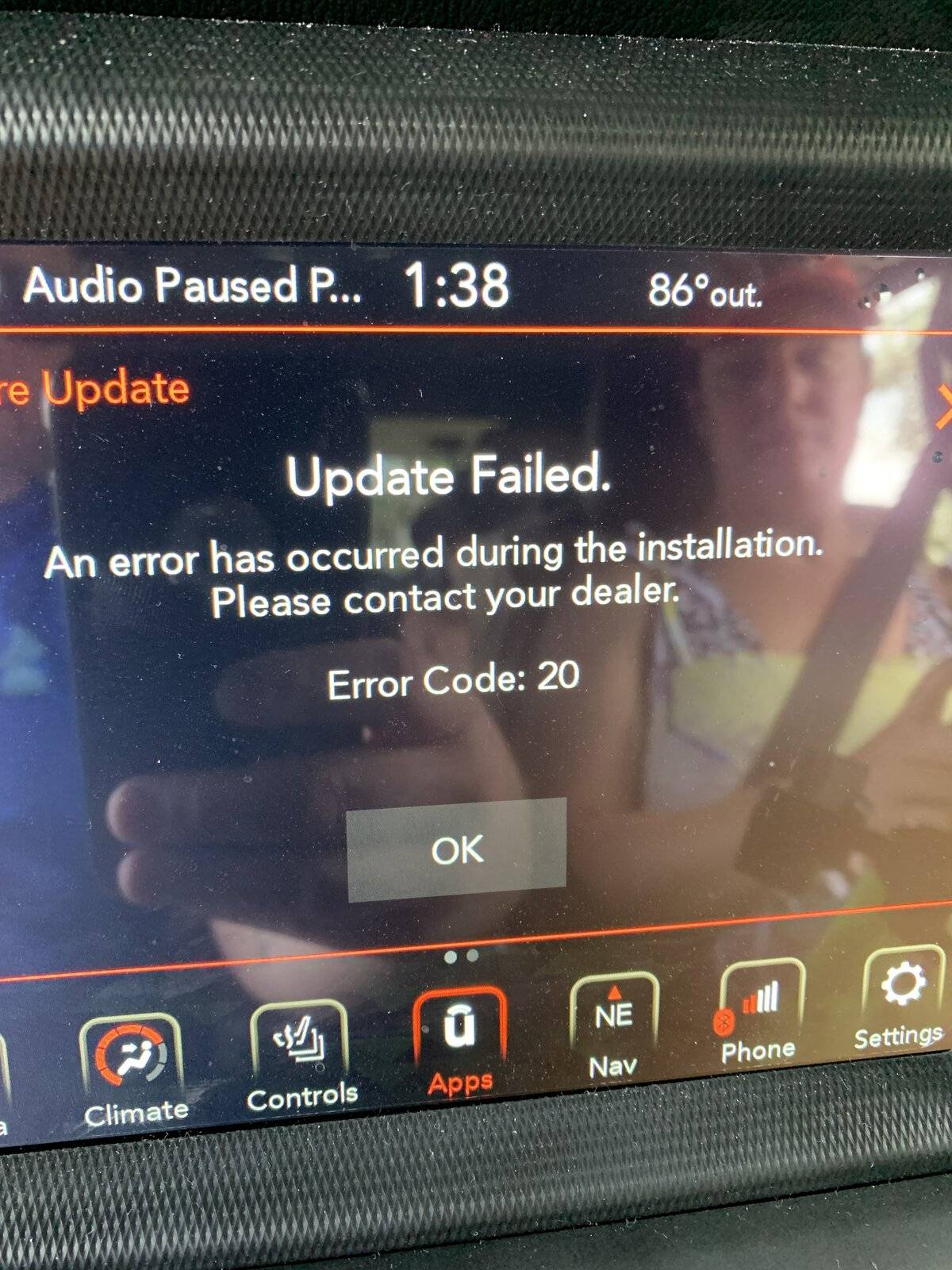

Are you still seeing this "Error 20" message? If you are and you're in need of assistance, please send us a message.

My update failed, talked to Uconnect and tried to see if they could just resend the update to my unit. They said, yours is up to date. Uh what the heck are you talking about. I am 20.53.10 updating to version 21.blah.blah to fix backup camera lines. Sir, there is no evidence that this update fixes those lines. Please, just try and send the update one more time. We can't, your dealer has to open a "star" case??? to figure out what you're talking about. Little bit frustrated at this point.

I was a little stunned when they told me they had no idea what I was talking about and that my unit was up to date and that everything should be working DESPITE having an open case with them. That's a little disheartening. Then I mentioned the new software version shared on the forum and they heard the word forum and equated it to diagnosing yourself medically on google. Poor form in my opinion. Granted some information that comes from a forum needs to be taken with a grain of salt, HOWEVER, there is a lot of pertinent information on here that has helped and continues to help a lot of people.
