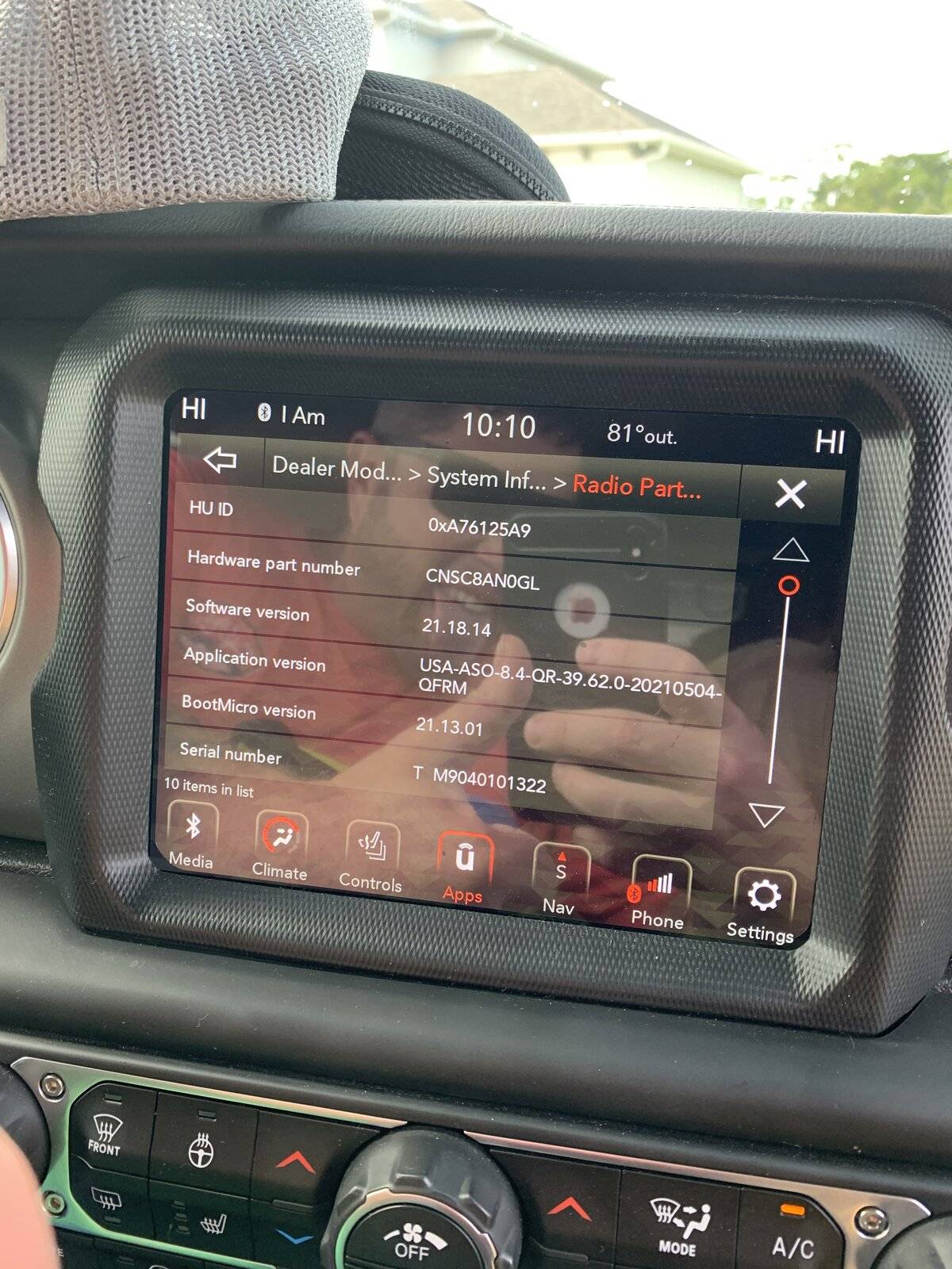

If knowing where to download USA-ASO-8.4-QR-39.62.0-20210504-QFRM flash file, please PM link. I would really appreciate it.
I have a refurb 8.4 with USA-ASO-8.4-QR-37.4.020200715-Q0F1

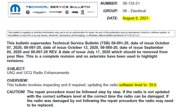

I wouldn’t try that. Too high a likelihood of “error code 20,” and then you have to explain what you did. Better to have your dealer do it. Here is the TSB. If you have the missing backup lines and random reboots, they really can’t say no.
Jeep Wrangler JL UConnect Updates EE7E4254-4348-496F-8C17-6C6662B4BABA
