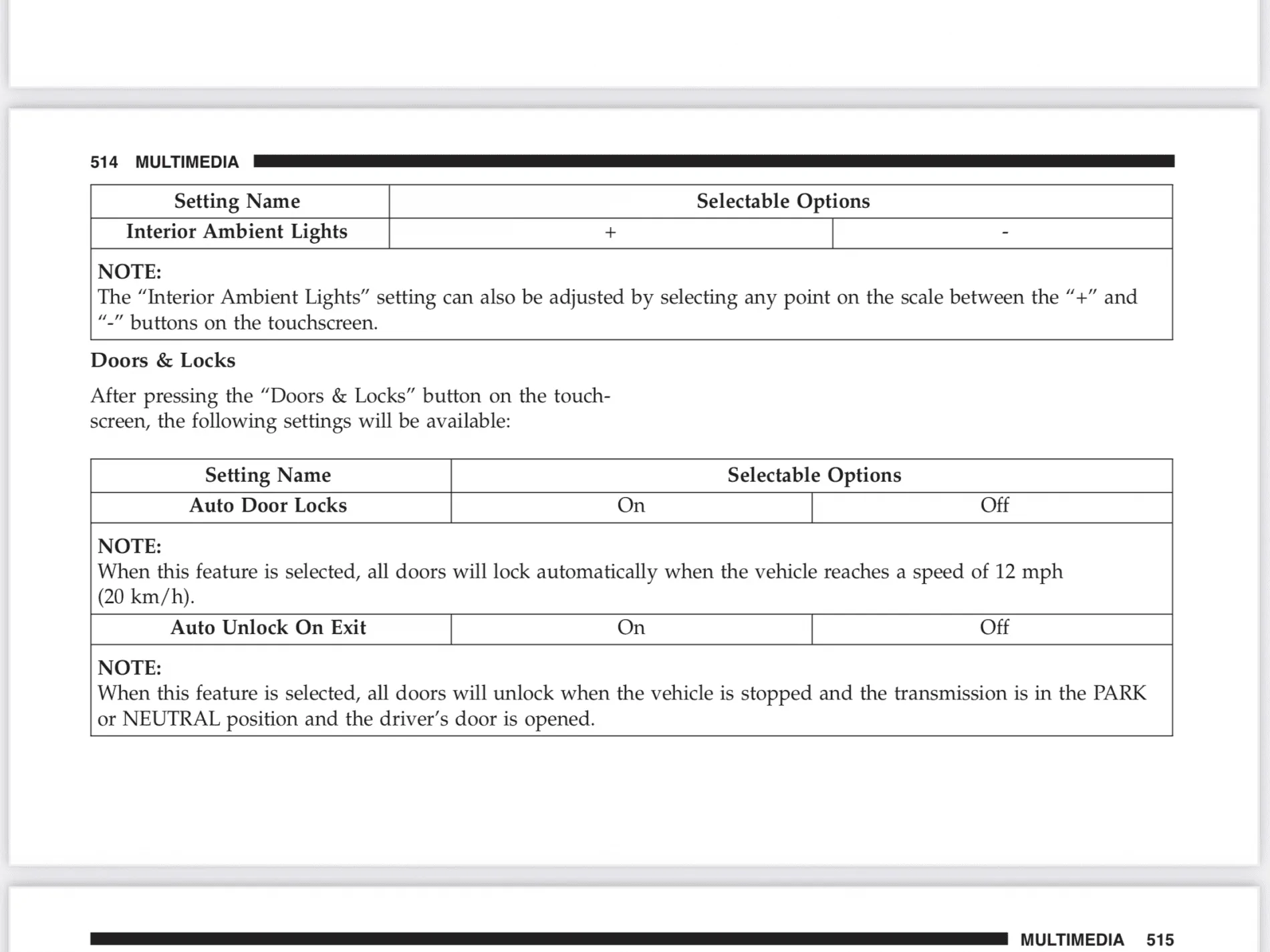

Not sure what’s in your owners manual but here’s a clip from mine
Jeep Wrangler JL Uconnect Auto-Lock feature not working 9E58F468-0150-47E0-9F21-1A20A9AF0FBE
