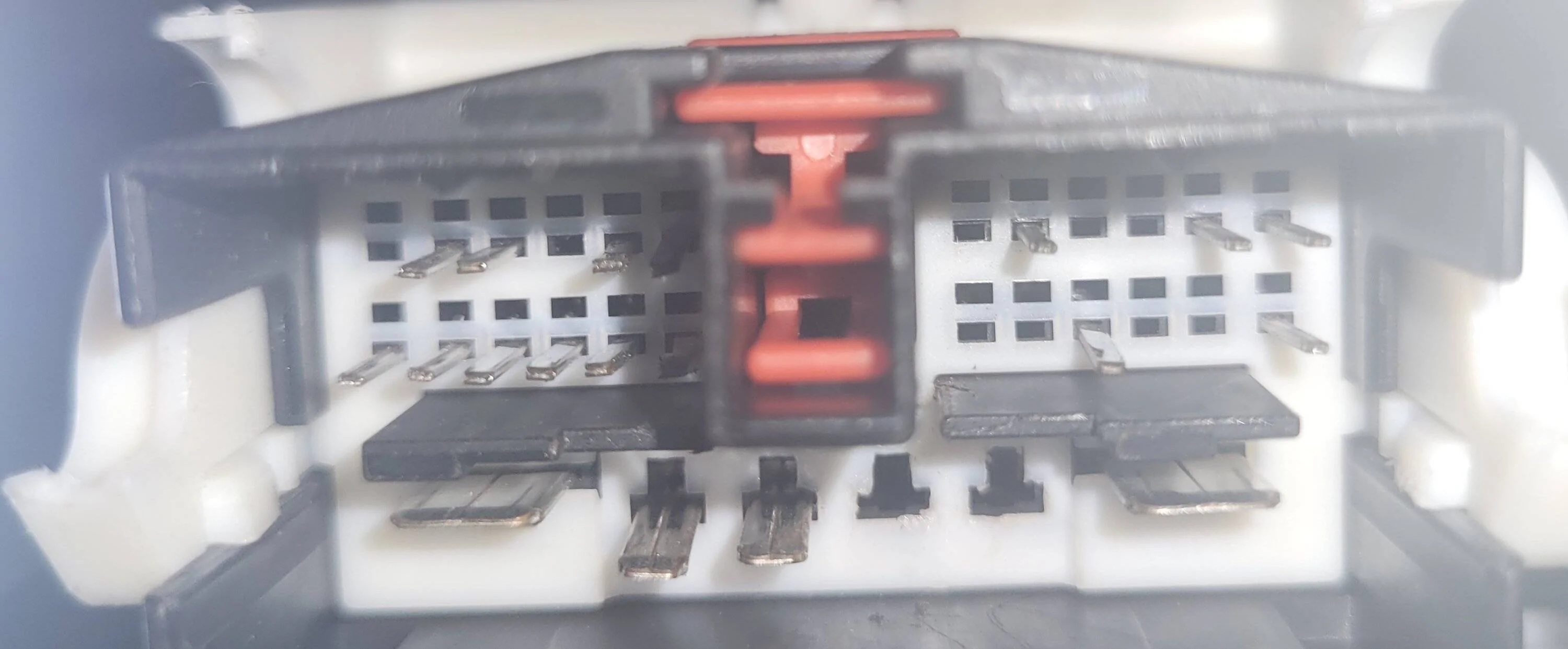

Did you or anyone else take a picture of the bent pins? I am having the same problem after replacing my doors and I can’t tell if any are actually bent. It has affected both mirrors on mine as well.

I just fixed mine this morning but didn’t take a picture. The remote start and power mirrors weren’t working but door locks and proximity worked.
I had to detach the connector from the inside body of the Jeep so I can see the pins. Some of the smaller pins were slightly bent upward compared to the others but it’s not something very obvious. I bent them back with a tiny screwdriver so that they line up with the others and everything worked when I reconnected. Both of my doors had bent pins.

Best picture of the pins I could get. I have a few other angles but not as good on clarity.
Driver Side:
