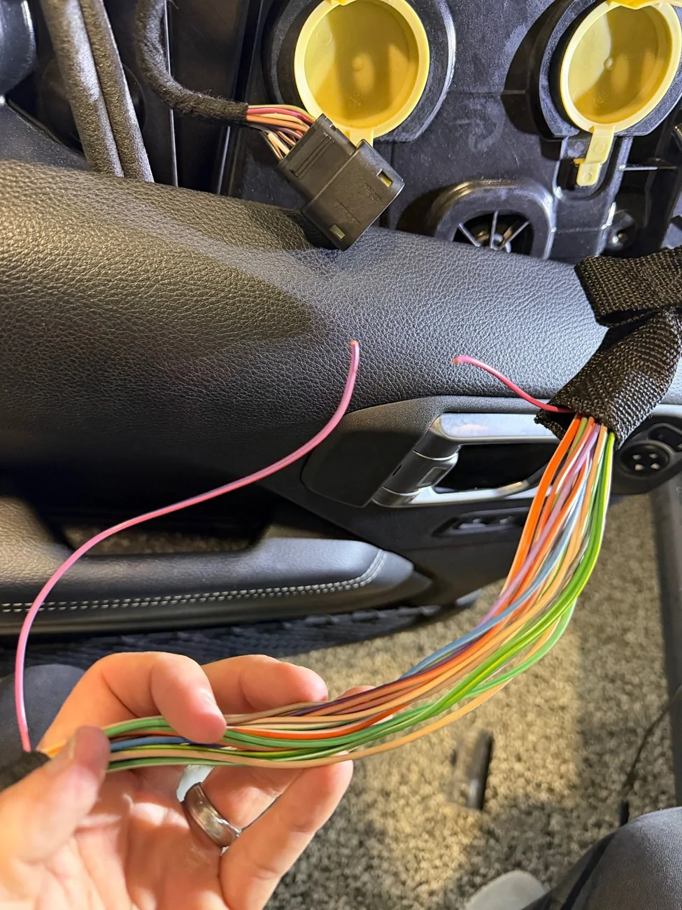

Sorry for another one of these mirror threads but I’ve read all the others and haven’t nailed down my issue. I have a new to me 2018 JLU Sahara and neither of the power mirror work, but all other features seem to. I’ve replaced the switch on the drivers door, checked the harnesses and pins on both doors, cleaned both harnesses, confirmed the fuse in 96 is good, but still no luck. The door locks work, dash door indicator working properly, proximity unlock feature works, dome light works, it’s just the mirrors not working.
Seems odd that both mirror motors would be out. What am I missing?

What do you mean you’ve checked the wiring? With your eyes or with a meter?

Thanks for the feedback - seems obvious about the wiring and I definitely should've thought about that. I'll pull the wiring harness to the door this weekend and check the wires and report back.

Nah the wires get cold, hard and dry, and just snap at the bend. It’s extremely common.

Turns out the main power wire for the mirrors in the harness on the door was broken/pinched in half, so I fixed that and they're working again. Good call on the wires, can't believe I didn't check that. Here's a pic for anyone else who runs into this.
