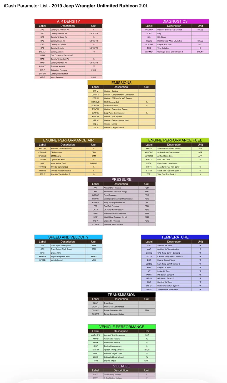

Can anyone with a Scanguage or other comparable device, provide us all with this excellent info ?
I have a Banks iDash gauge connected but there isn’t a BID for anything turbo temp related. I haven’t tried JScan as someone suggested but might do that. I figured if that data was on the CANBUS the iDash would be able to display it. But since I can actually display more information when I specify an ecodiesel it’s very possible JSCAN can show it.

correct, there isn't a BID specifically for the Turbo Temp for a 3.0 either.
Banks suggested the EGR1/1 for monitoring EGTs, and they do have Turbine Inlet & Outlet Temp options for those who care.
https://docs.bankspower.com/bids/files/PID_2020_Jeep_Wrangler_3_DOT_0L_V_311_E.html
