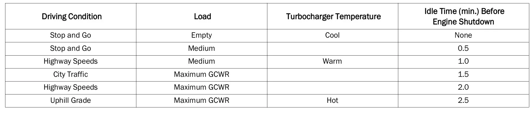

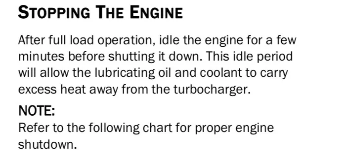

This is in the manual for my EcoDiesel and is in line with what I’ve seen regarding turbocharger cooldown for everything I’ve had with a turbo in it. When I come off the freeway to fill up the 2.0T I let it idle for a few minutes before pulling up to a pump and turning it off. On the diesel I let it idle while I fill up, then move to a parking spot to shut down.

there we go; someone who RTFM!
almost every truck on the highway is spinning a turbo; they've routinely been doing this for decades already.
follow a guideline like the one shown here (from your Users Manual!) and you won't have any problems.

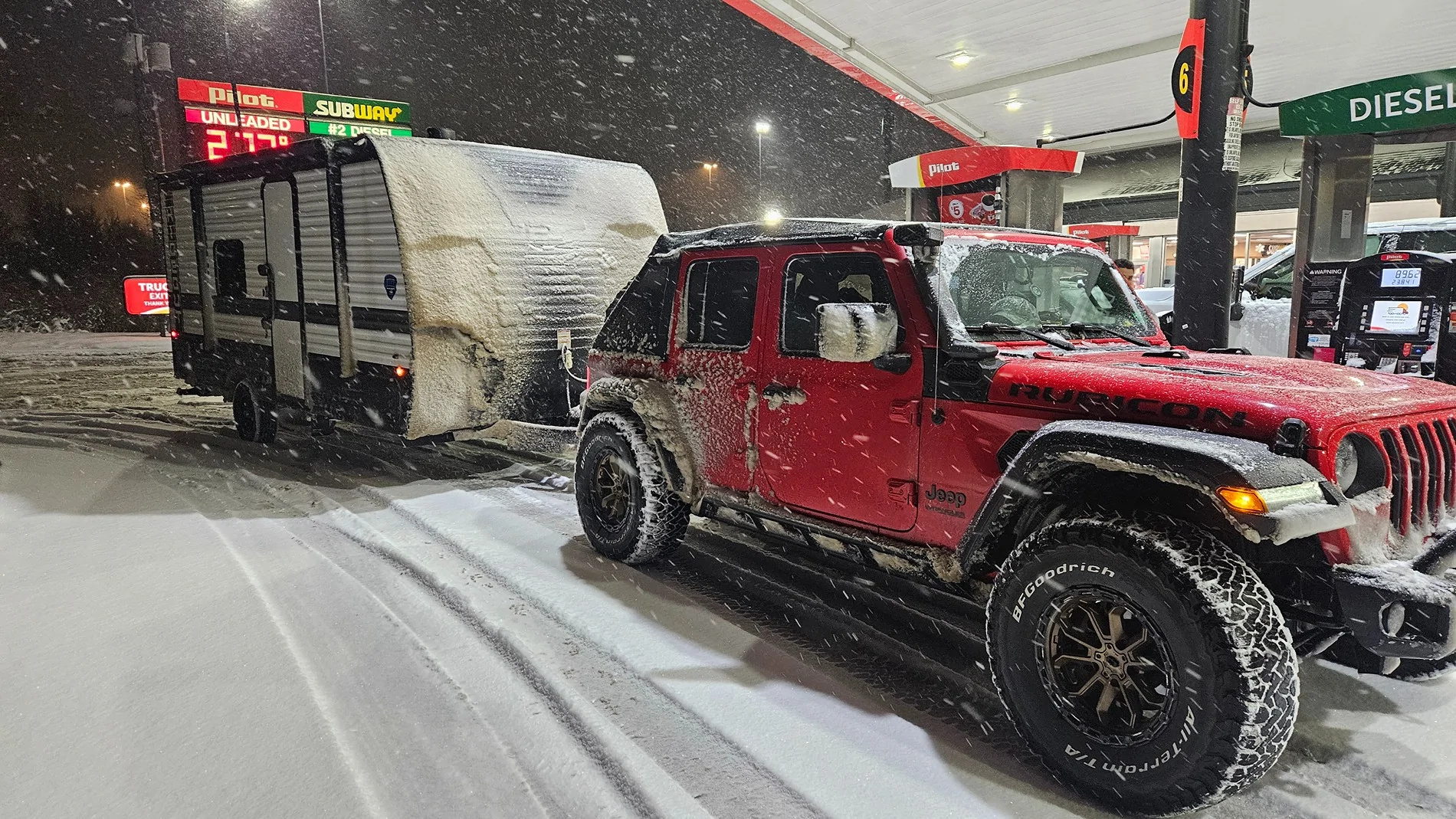

This is my first turbo vehicle ever and have a question(s). I have a road trip coming up with a majority of the trip is on the interstate for approximately 421 miles out of 529 70-75mph cruising. Does the turbo require any down time after so many hours of driving? I usually take a break every 2.5-3 hours.
Just send it. It can handle it. Have driven mine between VA and IL multiple times, including towing our 3k lbs dry weight camper once, through a blizzard. It does extremely well.
To be fair, the diesel has a big heat soak problem because the radiator can't shed enough heat. That engine generates a lot more heat than the 2.0 by a long shot. So the 2.0 doesn't need as much cool down.
Still, following that chart for the 2.0 won't hurt anything.

We do a lot of road trips. Show me how to go from the freeway to the pump without at least that recommended 1 minute cool down? Take the off ramp, roll up to the stop sign, even if there's no traffic there's 15-30 seconds. Turn and cruise into the station and pull up to the pump. There's another 30 seconds to a minute. Even if you're extra worried let it idle for another 30 seconds. You've now doubled the recommended cool down time just driving like anyone else on a roadtrip. If it's a busy truck stop, odds are you waited at the stop sign or light getting off the freeway for a few minutes. You may even of waited for a pump to open up for several more. That 1 minute cool down from highway speed is already built into living in normal society.
