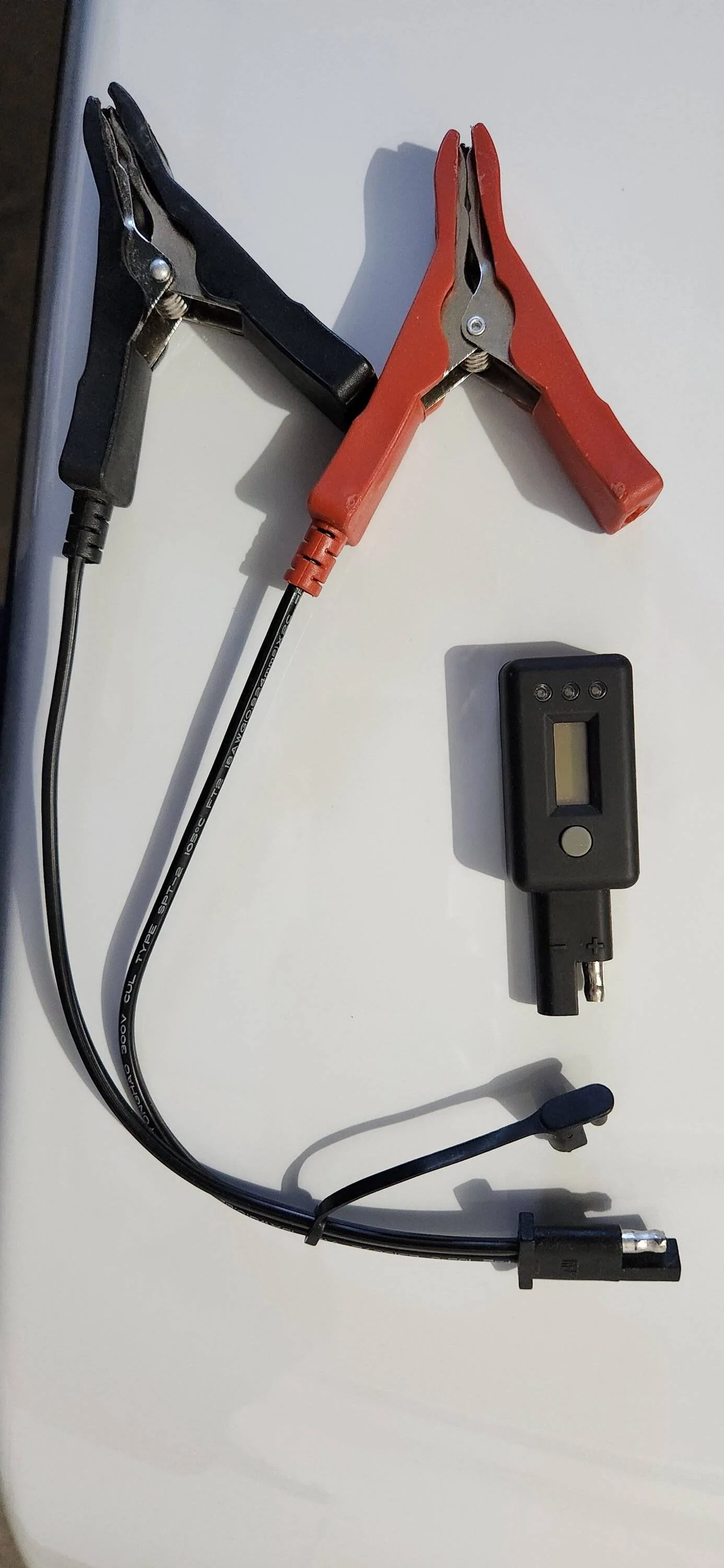

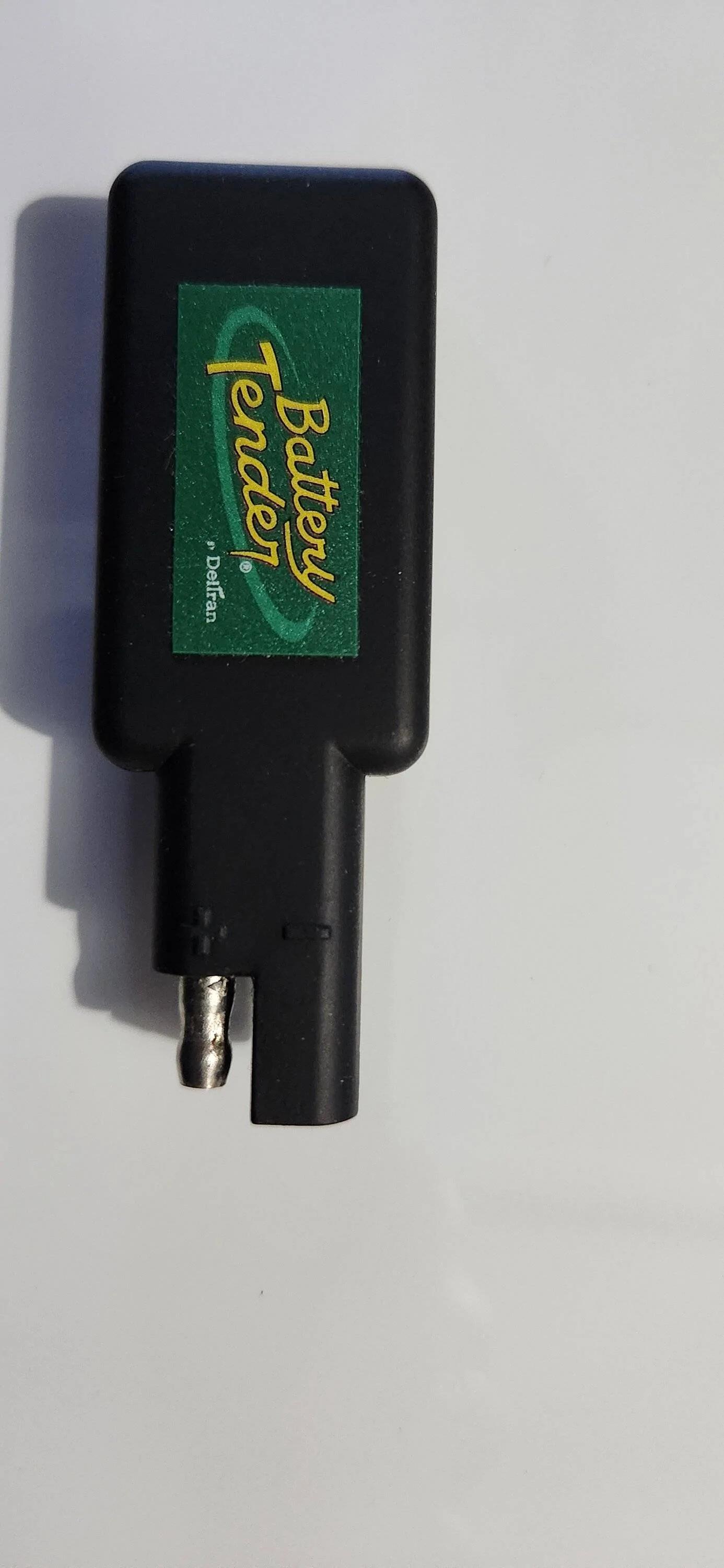

You could for the next few weeks spot check voltage.. Use a meter or simple hardware like this.
I keep one of these around so I do not have to take out my pricey meter, say when I want to spot check voltage on the zero turn mower, tractor, etc..

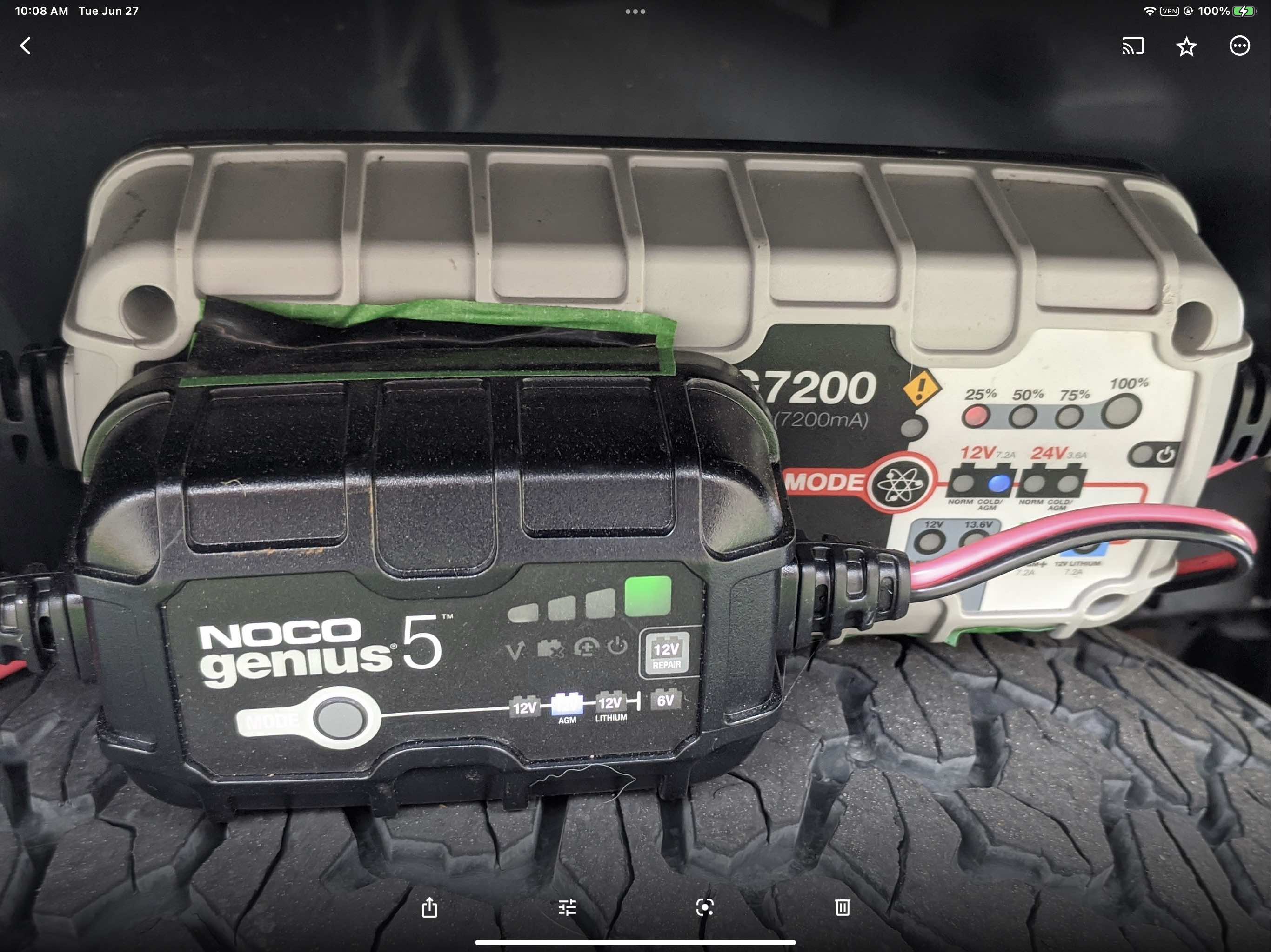

Does it make sense to keep my Jeep on a trickle charger between starts? My daily trips are less than 10 miles and I usually get to where I'm going in less than 15 minutes. I have a motorcycle on a trickle charger and all has been good for 4 years. I just don't know about the pros/cons of a charger on the JL. Any help would be appreciated.
Short answer yes.
Long answer:
You will hear many anecdotal ideas what to do
This has worked perfect for us over the past 20 years
2 CTEK smart chargers + 4 NOCO smart chargers
Used on 6 different 12V batteries load tested
Oldest original battery around 10 yo - still fine
JL batteries OEM 5 yo - still fine especially the tiny aux
Do not charge different amp-hr batteries in parallel
Never allow your battery to ever fully discharge to zero
Since it will then kill your other JL battery in parallel
NOCO 5 is fine to use on the tiny aux
NOCO 7.2 or newer version 10 is fine to use on the main
Smart charge each battery separately as described
Regularly NOCO repair each of your AGMs separately
Have done this for years extending battery life
Just finished a 2000mi road trip in the JL
Batteries were perfect - SS always works after 1 min
Comprehensively research all this - then you do you
If you hook up as prescribed - expect no problems
My OEM main is slightly weaker than my OEM aux
JL forum is overall good - but some posts are BS
Especially to do with the 5 yr JL corrosion warranty
Battery comments by OGNJ however - seem spot on
