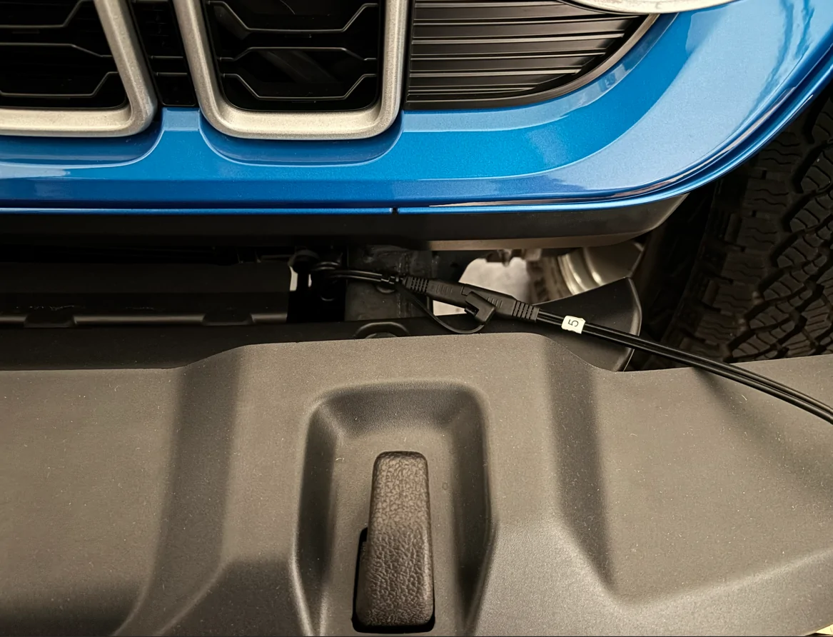

In today's day & age of a million modules & "intelligent" battery charging that never fully charges a battery in deference to gas mileage (theoretically) I consider maintenance charging a must if not a daily driver. To that end, install a battery tender lead with a 6ft extension & route it out here. I plug in every time the Jeep will sit a week or more. Do not even have to open the hood. I used a cable tie with a Christmas tree push pin built-in then stuck it in an empty factory frame hole.

Make sure that the Tender is a smart AGM compatible Tender. If it isn't, you need one that is AGM compatible. AGM batteries require a specific algorithm to prevent from damaging the battery.
