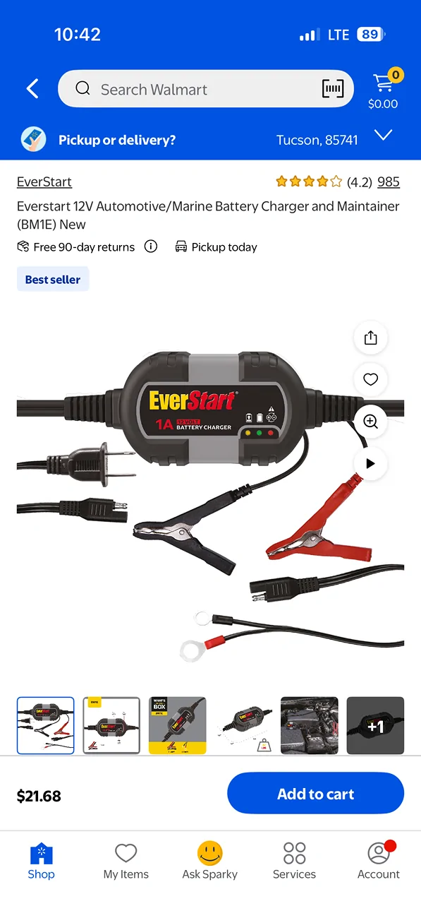

I’ve used the 1A Wal-mart EverStart tender for the last five years. It’s inexpensive and charges slowly (which I like). I throw it on every few weeks in the winter months because the Jeep sits for long stretches. It may not work for a fully depleted battery, but it works well for how I use it.
