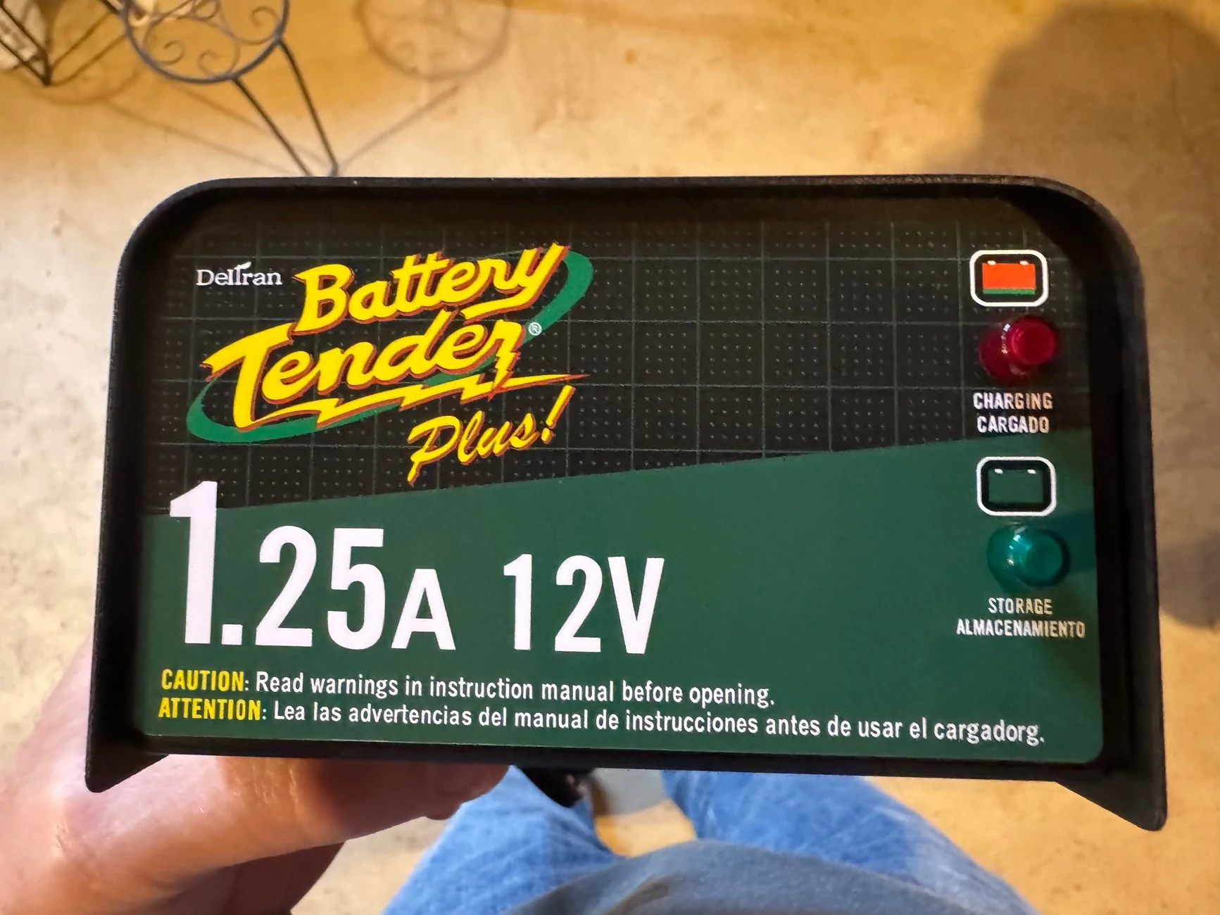

Per the Battery Tender website for product specifications on the 1.25 amp unit:
The Battery Tender® Plus is perfect for all lead-acid, flooded, or sealed maintenance-free batteries (AGM and gel cell).
It also says:
EXTEND BATTERY LIFE
Compatible with all 12V lead-acid, flooded, AGM, and gel cell batteries. Complete 4-step charging program (Initialization, Bulk Charge, Float Mode) allows for optimization of battery power, without overcharging. Smarter than a trickle charger.
BATTERY COMPATIBILITY
AGM, GEL, Standard (Sealed or Flooded Lead Acid)
Like I said, at 1.25 amps it’s not fast but it does the job. I used it first on my dual battery 2003 Silverado diesel, then on my dual battery 2019 GMC Denali HD diesel. I’ve used those vehicles primarily for camper hauling. We store the truck from late October to mid May each year and the 1.25 amp unit has kept the batteries charged on both vehicles.

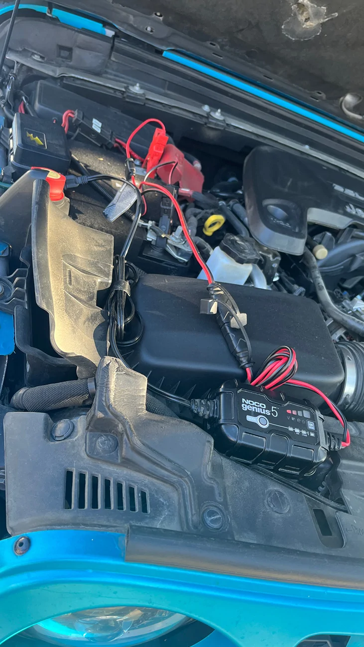

Thanks all for the suggestions! The Noco5 arrived from @Terrymo yesterday and I got it all setup this morning and ran the cord awkwardly to the garage.

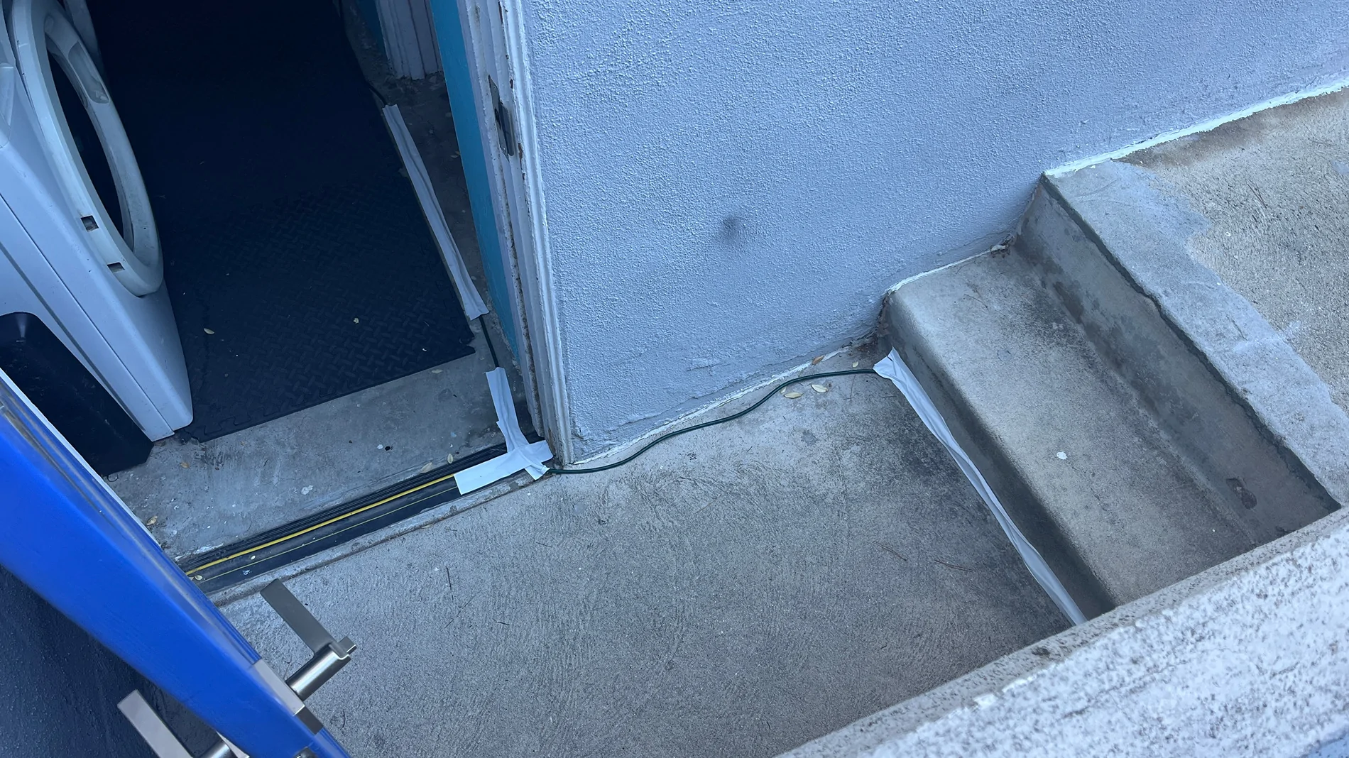

Doesn't look pretty but it'll get the job done for now.

Now you just have to remember to unhook it if you have to move the Jeep. :LOL: I try to run the cable over my driver side mirror or through the door handle so I remember to disconnect it.
SadRobot
Aug 31, 2019
144
7,492
20,073
Los Angeles
2025 Prius LE
Ha well the "good" news on that front is this Jeep ain't goin' nowhere without a new front axle so it shouldn't be an issue.

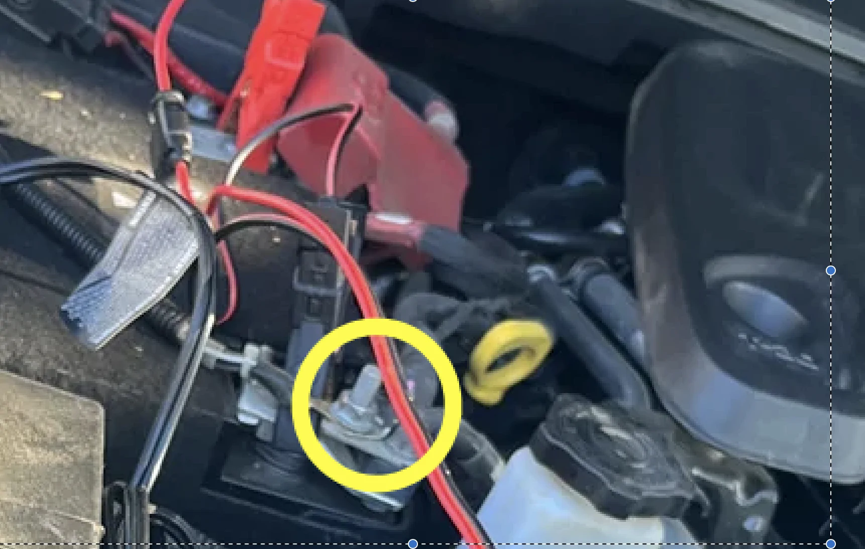

To keep the IBS calibrated, the negative clamp should be on top of the IBS.
Jeep Wrangler JL Trickle Charger? {filename}
Like here on the post? Or is it better to not have it on the battery and all and run it to a ground on the frame somewhere?
