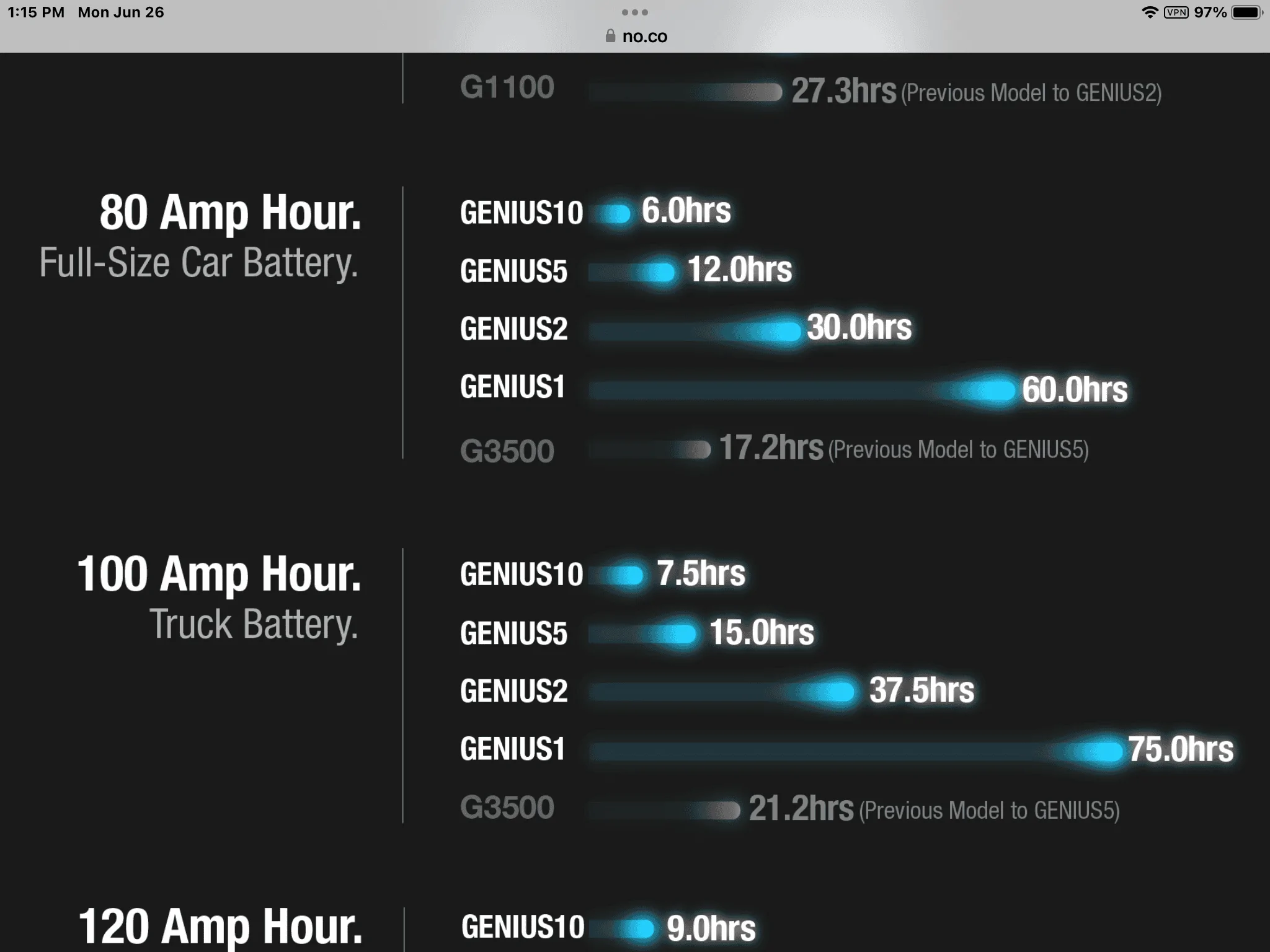

I have both the 5 and 10 amp Noco. I use the 10 amp for the Jeep and the 5 amp to maintain other batteries.
Here’s a general comparison at 50% depth of discharge from Noco’s website
Jeep Wrangler JL Trickle Charge JL Battery Recommendations IMG_0048
