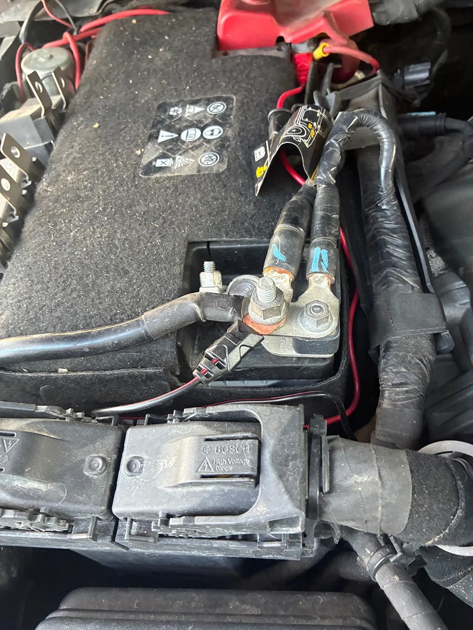

I would avoid putting terminals under clamping bolts/nuts. Your battery terminals have places to attach terminals. Use those instead.
Why is putting on the clamping nuts not good?
roaniecowpony
Dec 4, 2018
198
13,159
21,038
Retired Engineer
The little charger terminals are made from soft material, likely copper and zinc plated. When you put them under the clamping nut, it squashes and spreads them more and more each time you clamp the battery terminal. Eventually, the little terminal hole gets bigger and bigger. As always, I'm sharing this because I was stupid and the advancement of mankind (and womenkind) is based on what stupid people learned and pass along, so the next person doesn't do the same thing. Jus sayin.
And finally, your battery terminals have places on them dedicated for attaching this kind of stuff.

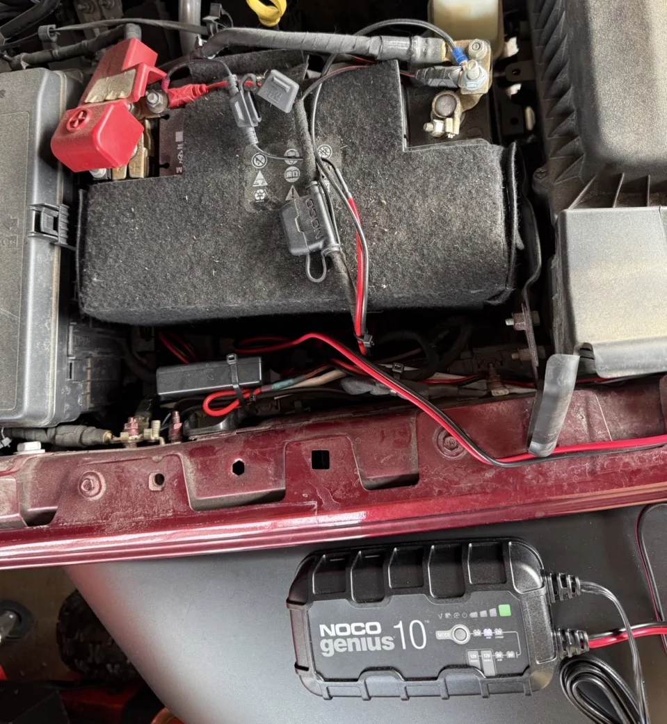

In the NOCO pic, imagine using zip ties to attach the Noco wires to the battery cables. Basically so they run together...

Mine sorta runs that way, but I wanted to store the NOCO quick-disconnect between the battery and the inner fender with an RVi Towed charger.

He's saying for the part you just ordered from amazon that will stay attached in the jeep, do like this so if you have to take the clamps off the battery, the noco adapter part doesn't make it harder

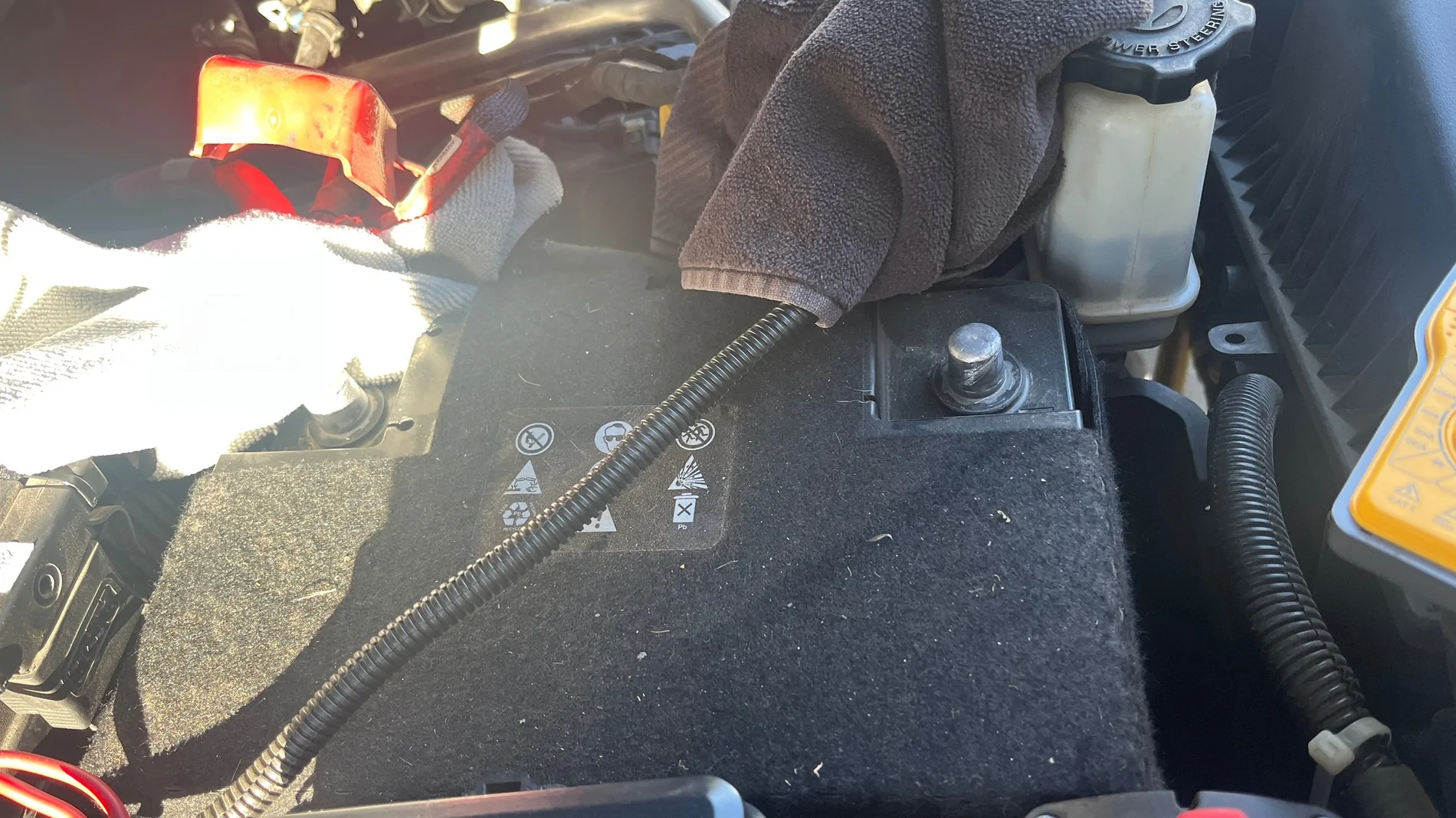

Ah so just avoid crossing the battery. Well sadly that ship has sailed. There is one negative cable that I couldn’t fit around the battery.
