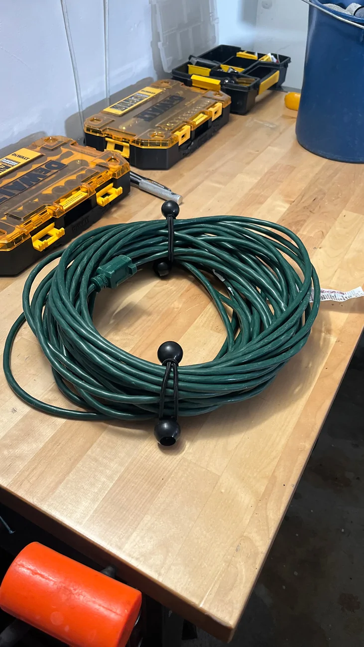

Yes, based on the picture I saw, it should work. But it could also cause a heat buildup that eventually makes the charger angry, which might explain why the failure is intermittent.
I'm also on board with the extension cord theory.

I can't really mess with it anymore tonight but I'll have all of Saturday to go grab another extension cord. Maybe something slightly shorter although I do need to have a long run from the closest outlet. This is what I was using:

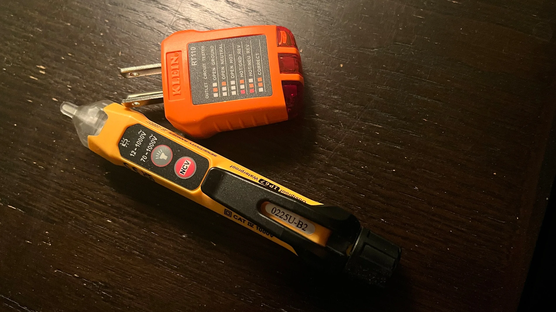

Some simple tools to test home electrical stuff.

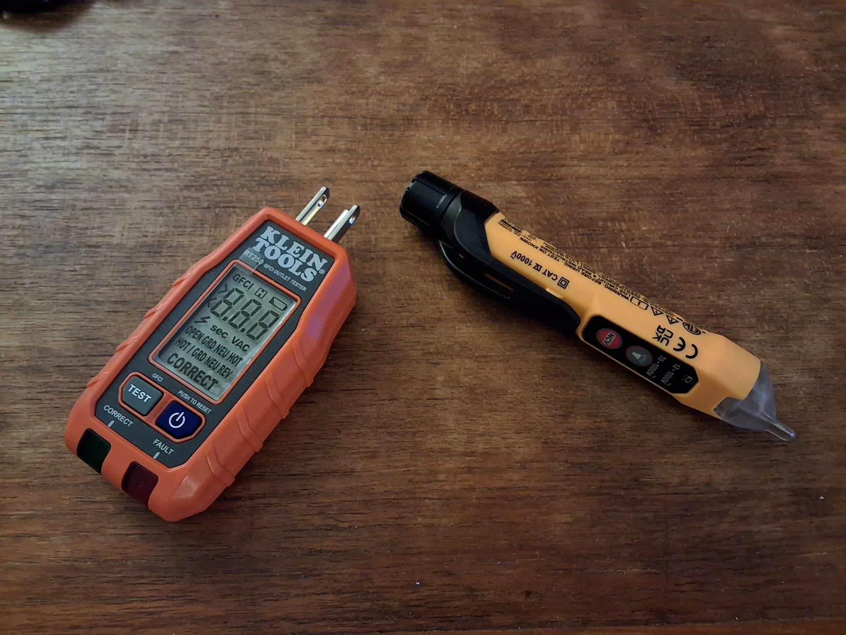

I do actually have one of those Klein outlet testers. I bought it when one of my lights went out in my laundry room and I had to figure out why. I wanted to make sure if I was messing around with switches and outlets I knew if it was hot so I didn't shock myself. 😂

I do actually have one of those Klein outlet testers. I bought it when one of my lights went out in my laundry room and I had to figure out why. I wanted to make sure if I was messing around with outlets I knew if it was hot so I didn't shock myself. 😂
The “sniffer” one? Me too, the fewer surprises the better when doing wiring. If you had the other one you would be set to test the extension cord voltage drop. But a lot of people are trying to spend your money here. 😂
