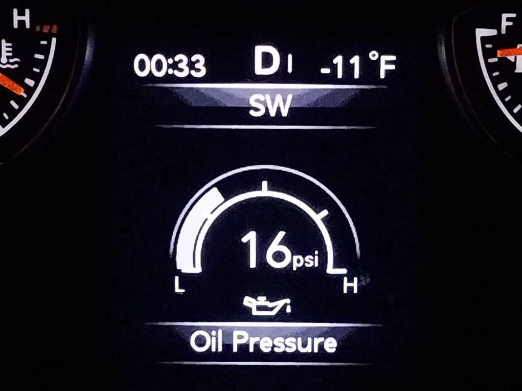

For 2.0L yes, on idle it is less than 20 psi but as you step on gas, it climbs up into 50s even at 2000-2500 rpms. unlike the 3.6l which would be at 29-30 psi below 3000rpm and goes up to 70s over 3000 rpms.
Good to know. Thanks.

Jeep Wrangler JL Transmission Temperature -11F 22nd Jan 2025
