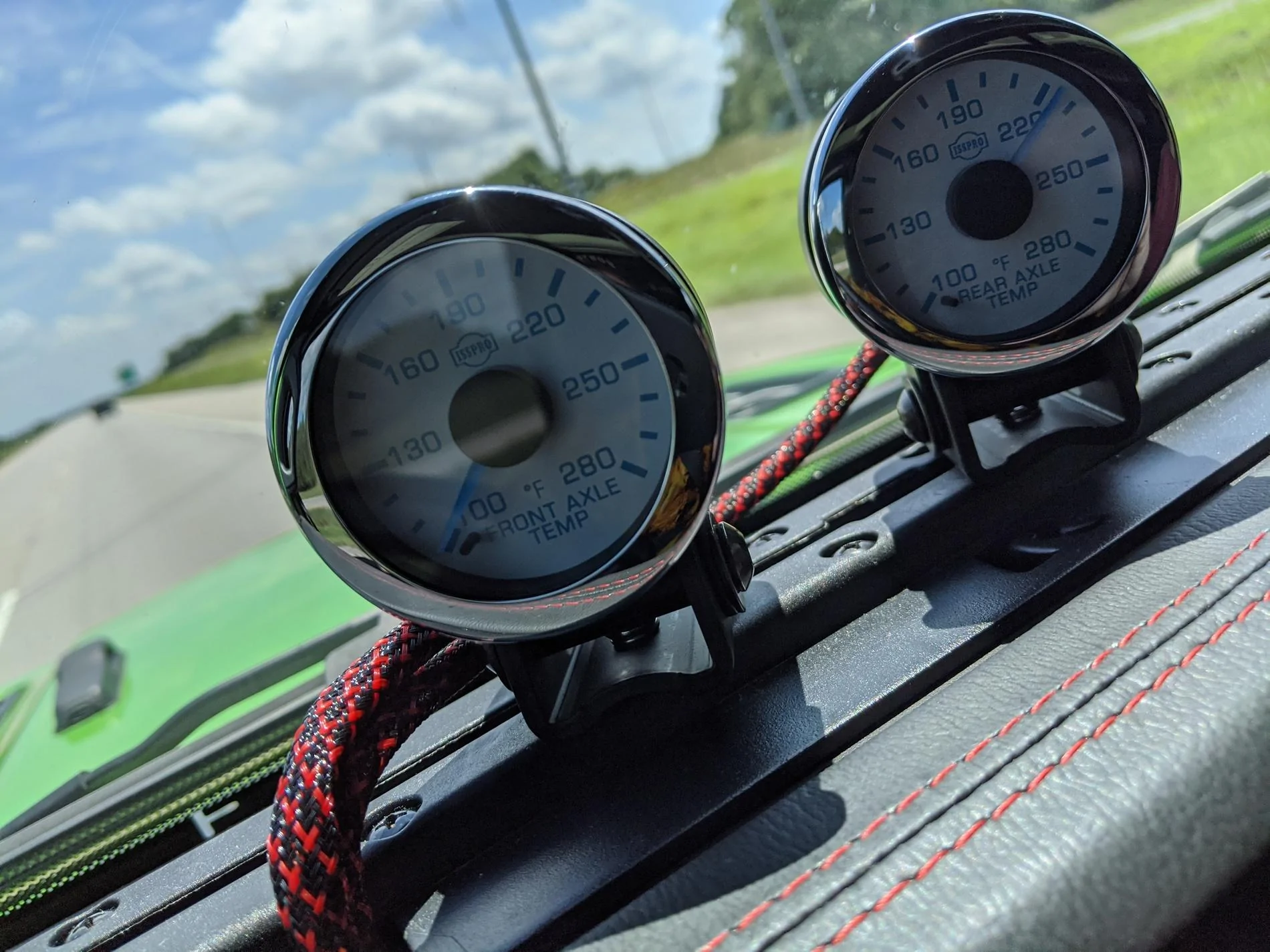

I did about 200 miles today on the open road in 95°F weather. Two passengers and unloaded driving between 80 and 85MPH most of the way. The rear axle temperature hit and sustained 222°F which is pretty warm. I am running 75W-140 in it and have about 1700 miles to go before I UOA it again.
These temperatures make me question what the temps are in axles:
1. Running lower viscosity oil
2. Are loaded down or towing
3. Have lower gears (higher numerically) than 4.10
4. Have larger tires (I am running 33")
@DanW and @rockadile - keeping you guys in the loop.
@DanW, @rockadile - tagging you both again. I have been doing some research on gearing and will likely re-gear to 4.88 at some point in the future. While looking at gear sets and kits, I stumbled across this from East Coast Gear.
It is an interesting concept to set the OCI based upon temperature and while I am sure there are a multitude of variations, this does seem to be a good rule of thumb.
At 70MPH, I see 200°F all day, at 75MPH, I see 205°F-210°F most of the time, and at 75+MPH, i see 221°F-225°F (like you see in the photo above). I am running Amsoil 75W-140 in the rear and 75W-110 in the front.
Since I believe that my axle is now fully broken in (at least until I regear), I plan to use the UOA information in combination with the temperature guide below to aid me in determining when to change the oil.
What are your thoughts?
Temp Reference Chart – oil change frequency
o 170 Deg - 100,000 Miles
o 200 Deg - 50,000 Miles
o 220 Deg - 25,000 Miles
o 240 Deg - 12,000 Miles
o 260 Deg - 5,000 Miles
o 260-300 Deg – 500-1000 Miles until Temp is controlled
That's great info! Your data is appreciated, too! I can have a reasonable educated guess as to what mine might be running, given the conditions in which I operate.
