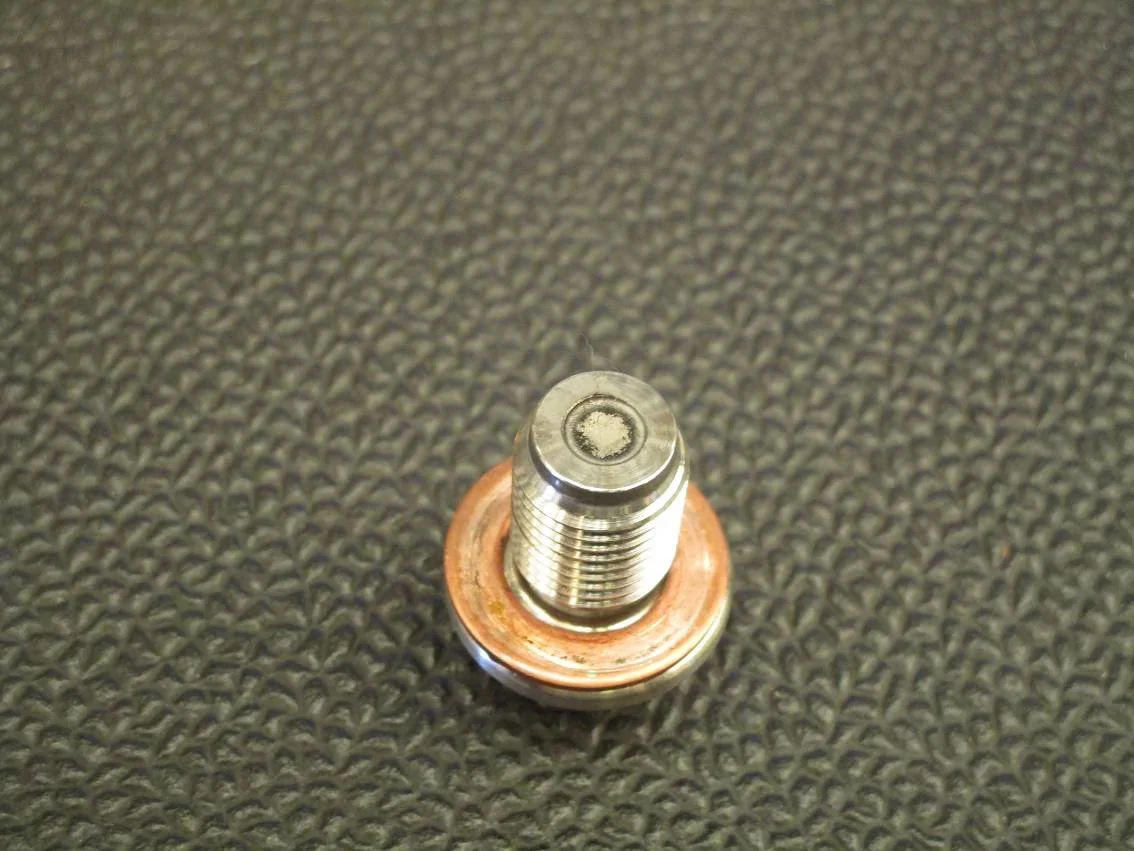

If you are going to change your oil yourself a magnetic drain plug is a good indicator that there is a problem.
Be it cam cast iron or needle bearing failing. So fare mine has been clean. :whew:
