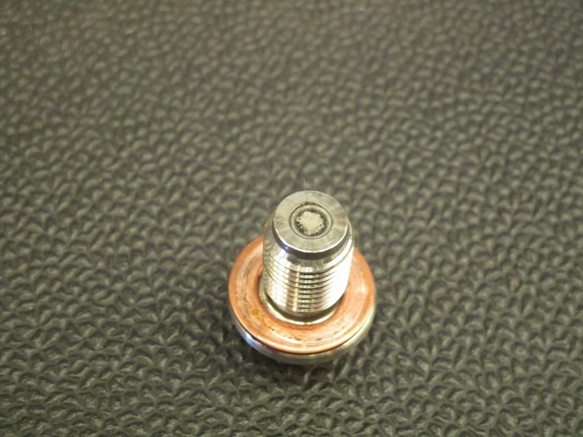

Here is what I did that I hope will avoid the cam / rocker issue.
1. Installed the RPM Extreme JL fan controller. This has lowered my coolant and most important my oil temps by 25 to 30 degrees.
2. From the very start I ran Valvoline 5w30 oil and now running Valvoline European 5w40 oil. This is what most European manufacturer use including the Maserati 3.0 v6 gas which is basictly the same as the jeep 3.6. I have not been able to find any cam issues with the Maserati 3.0 v6 gas.
Will this help with the cam issue. I hope so. To me it is common sense.
I now have 30k on my 2020 Willys 3.6. Here is a picture of my magnetic drain plug from my last oil change. No metal here.
Jeep Wrangler JL TrailRecon- Engine Failure oil drain plug
