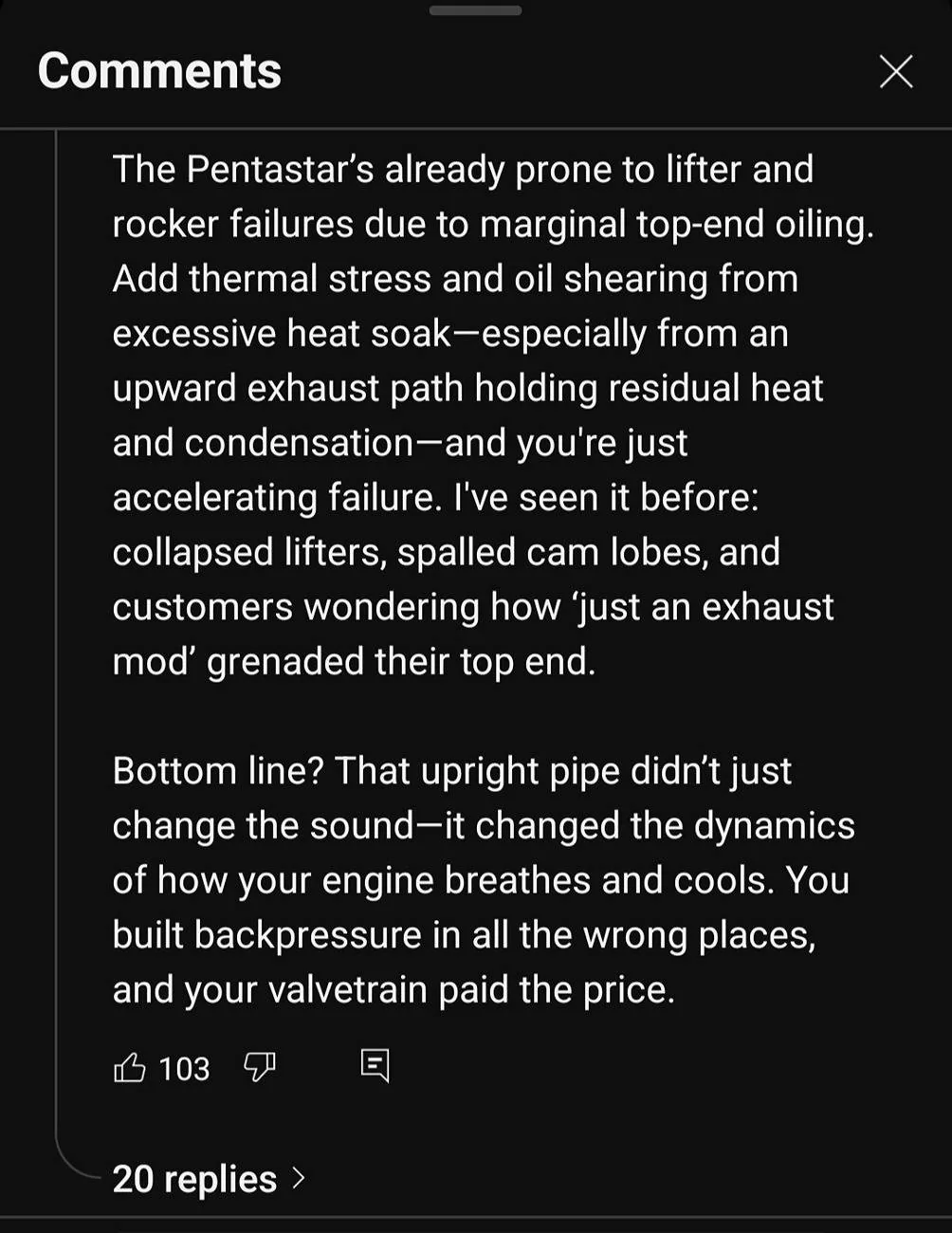

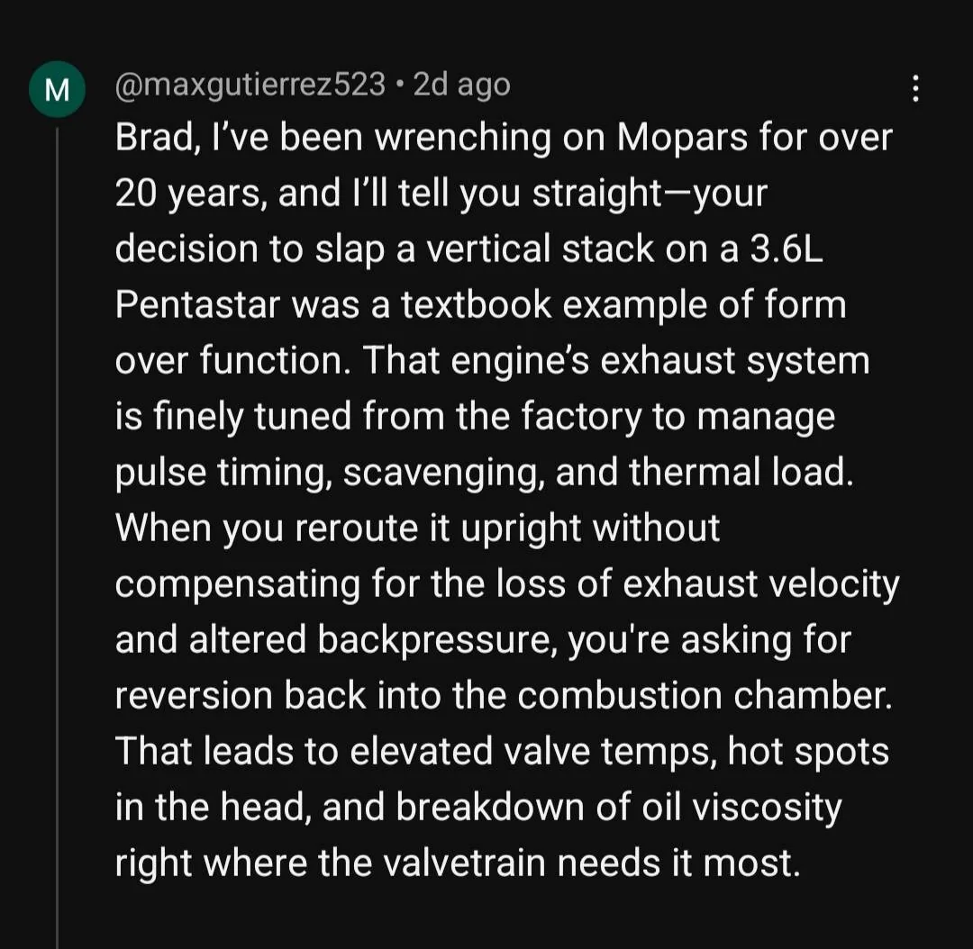

Yep, even though he clearly stated otherwise. Sticking our heads in the sand doesn't make this or other fundamental issues go away. This one, like many others, is well known.
There is a senior Jeep mechanic named Max who in the comment section tells him exactly what caused the issue. It has something to do with his modified exhaust thingy that lead to heat build-up. Trail Recon modified the engine, bad idea.
These engines are prone regardless of his exhaust. It's cat back and has ZERO to do with valve train failure.
