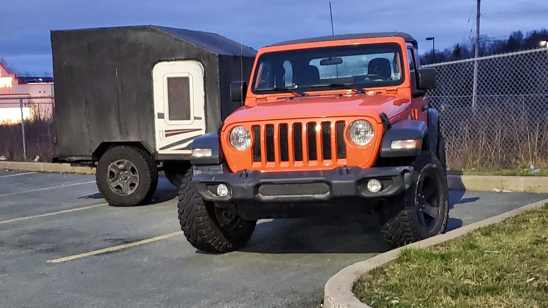

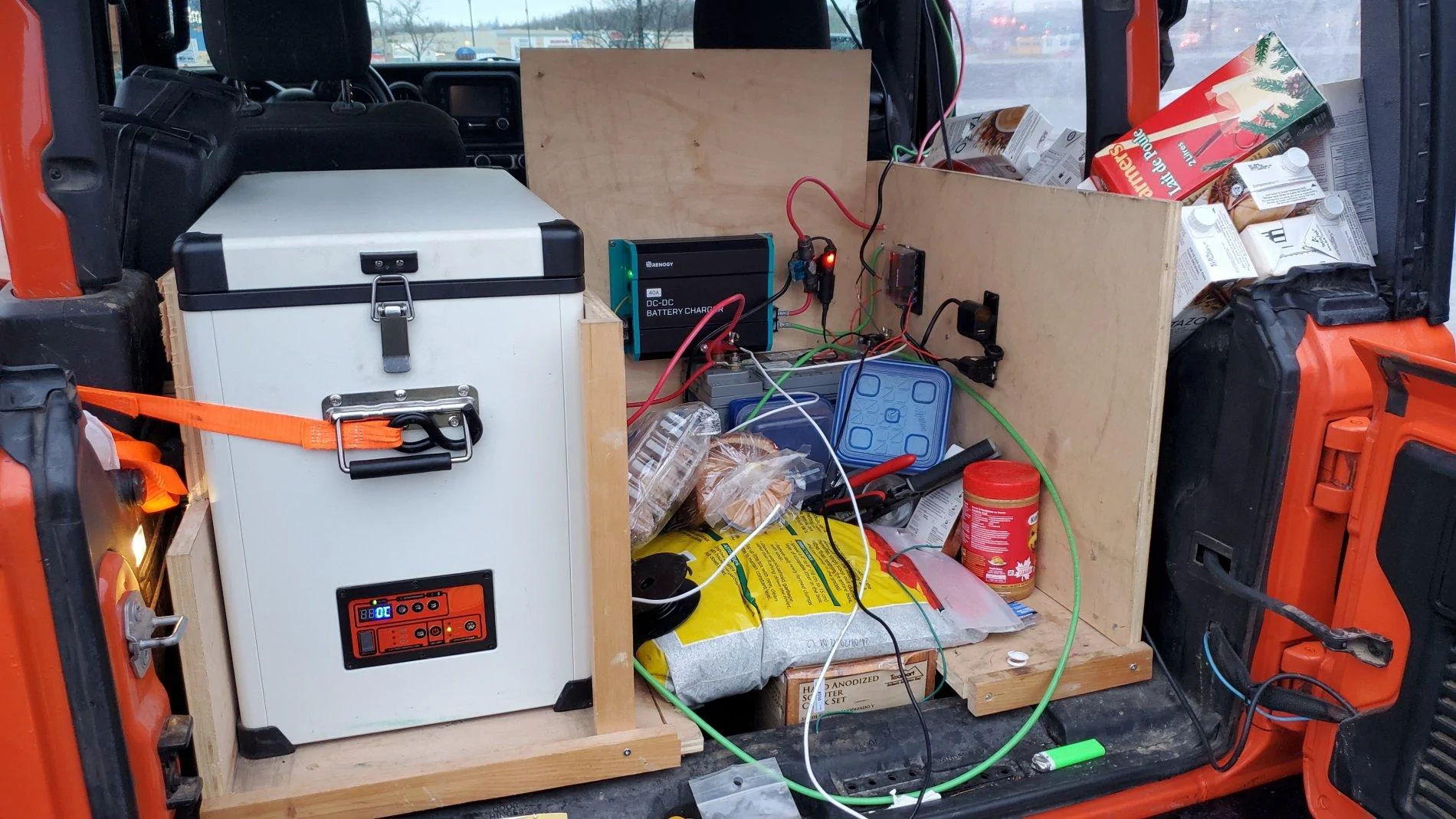

Not exactly small but i have 103ah AGM battery fed through a 40AMP DC-DC charger, 45L fridge in my jeep, have a 32AH trailer battery which will soon be 2 so i can have 64AH, all under bed storage, a shelf, a small cooler in my trailer, 32s with a 3500LB straight axle on the trailer and 33s with soon be be 4.56 gearing axle wise on the jeep
Most of the stuff has been made by me and first time doing alot of this.

I live in a more northern spot in canada (Nova scotia) so currently i get like 7 hours a day of sunlight so basically from mid sept until march we barely get useable sun for any system under 400watts, currently my plan is to upgrade crank battery (group 94) and run the cascadian system on the hood then get a 160 watt renogy panel and mount to a roof rack and get the DC-DC/MPPT hybred 50 amp model and charge house batteries that way.
Also i actually live in my jeep and trailer so the perminate bed is super nice, the only annoying thing right now is when i get clothes its all under my bed so i have to hold the mattress up as i grab undies and socks haha
My trailer is kinda light i mean i have actually more storeage then i thought i needed so it is really nice

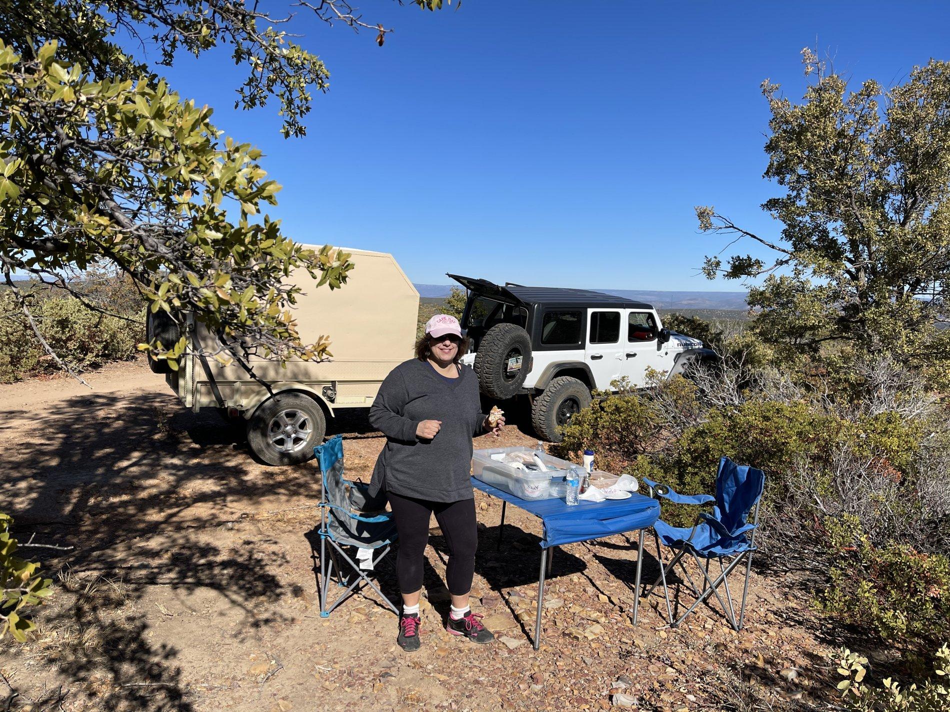

Below a quick first test ride the day after thanksgiving. Had a nice sandwich up in the mountains....turkey of course!
Found a few bugs in the setup and subsequent test rides show an improvement.
