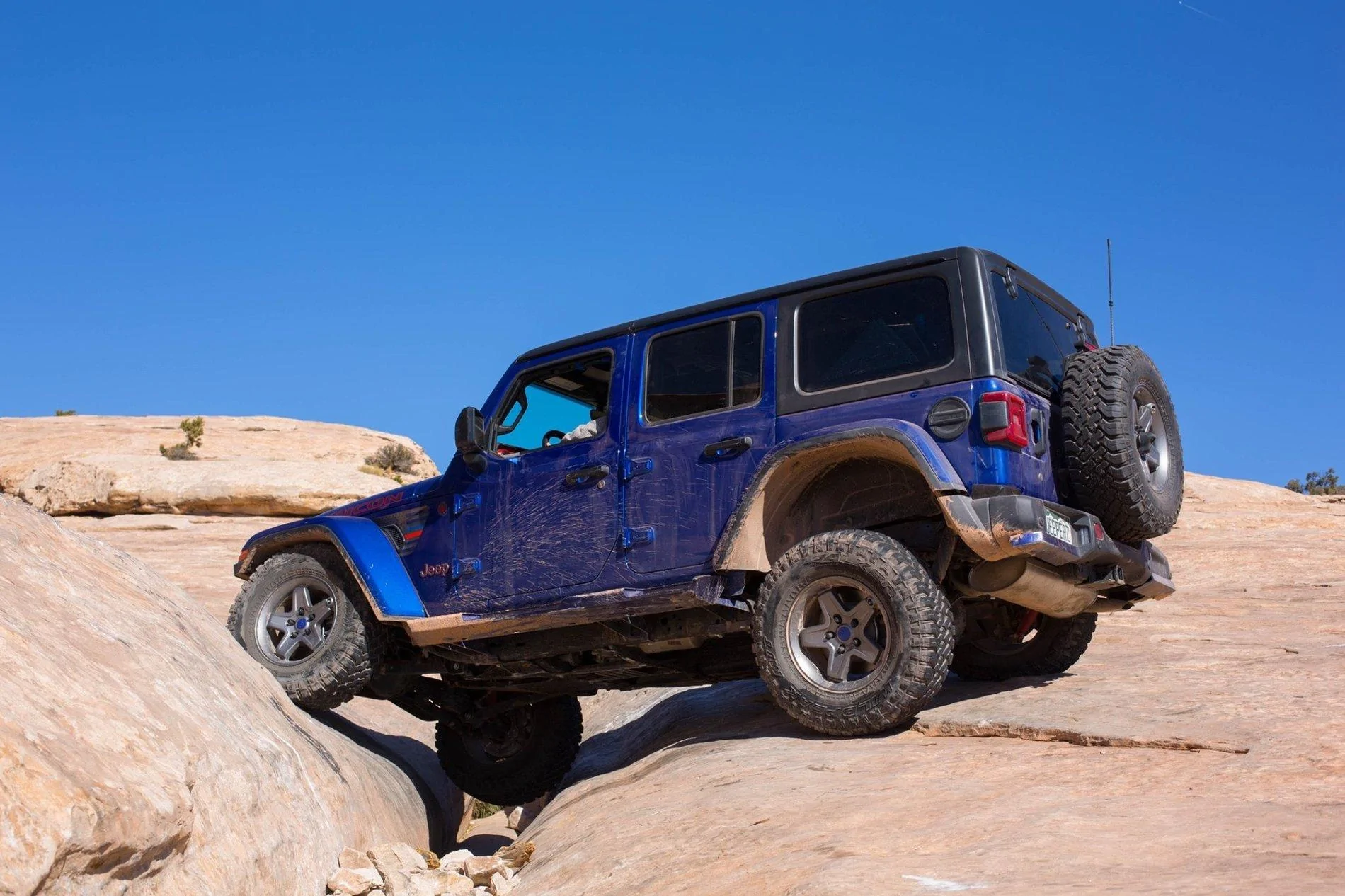

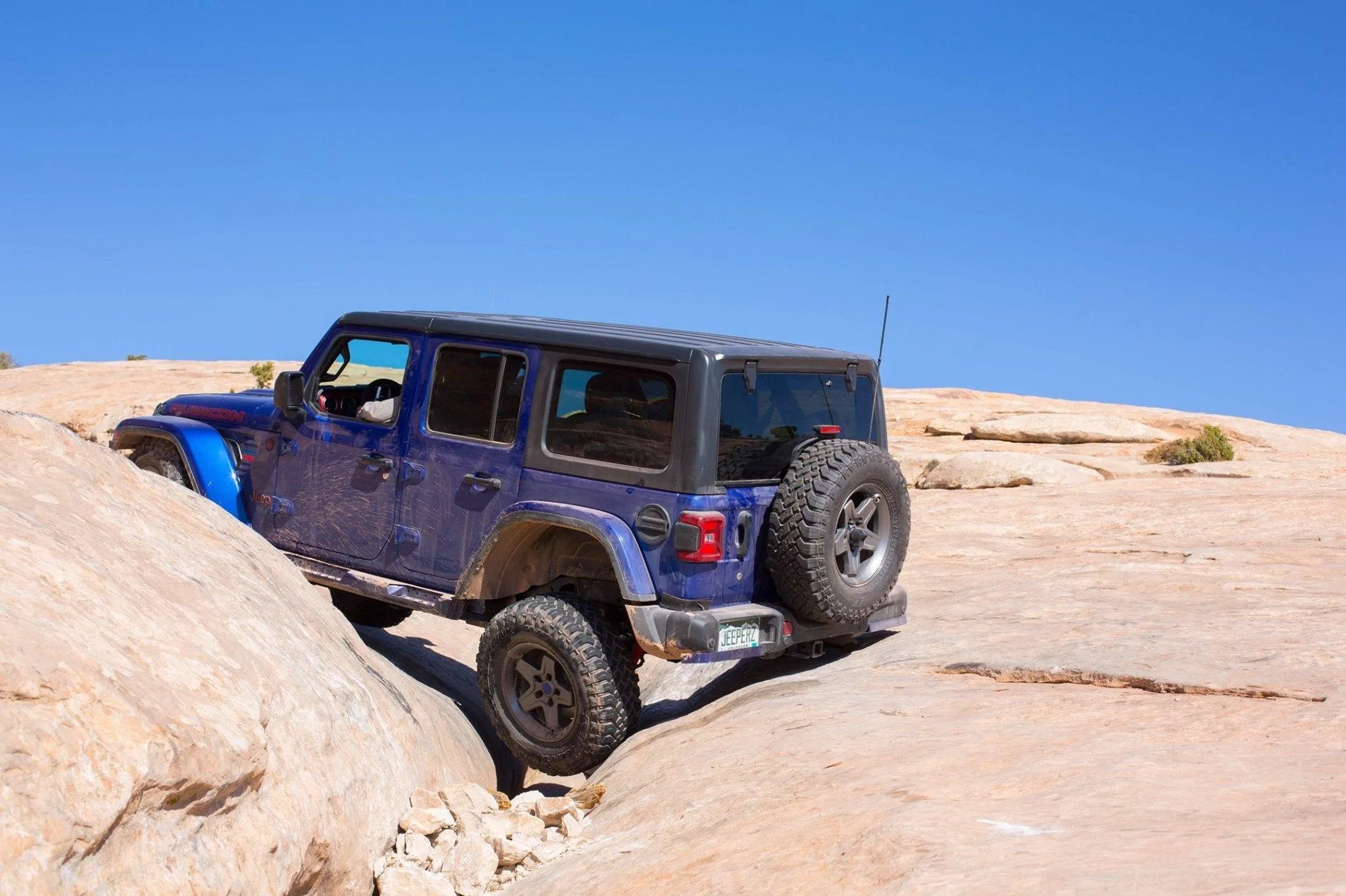

A little more on this subject for the benefit of relative newbies to the sport. If you plan to do light wheeling or mostly pavement pounding, any of the options listed here will be just fine (though I still prefer rubber bushings).
I’ve been in this sport for 20+ years and regularly do stuff like in the photos where I push the suspension to its limits. In my experience, poly squeaks and has had a tendency to not bounce back (over time) from extreme flex, eventually causing thudding sounds as your suspension is exercised (on road and off).
Rubber bushings are quieter, but over time they’ll rip up due to extreme flex and require replacement. In my experience, this was every 25-30k miles, which I always dreaded ‘cause you need to remove all the arms (and perhaps track bars) and take to a place with a worthy hydraulic press (my 12 ton Harbor Freight press is not worthy) to have your bushings pressed out and new bushings pressed in.
Because of the above, I’m very interested in Metal Cloak’s screw-together bushing which should ease eventual replacement. But I’m more interested in TeraFlex’s non-binding bushings as they should hold up to my abuse a lot longer and thus not need replacement as frequently. I am trusting that TeraFlex has done their due diligence from a durability perspective, otherwise I’ll be back in the bushing replacement business.
