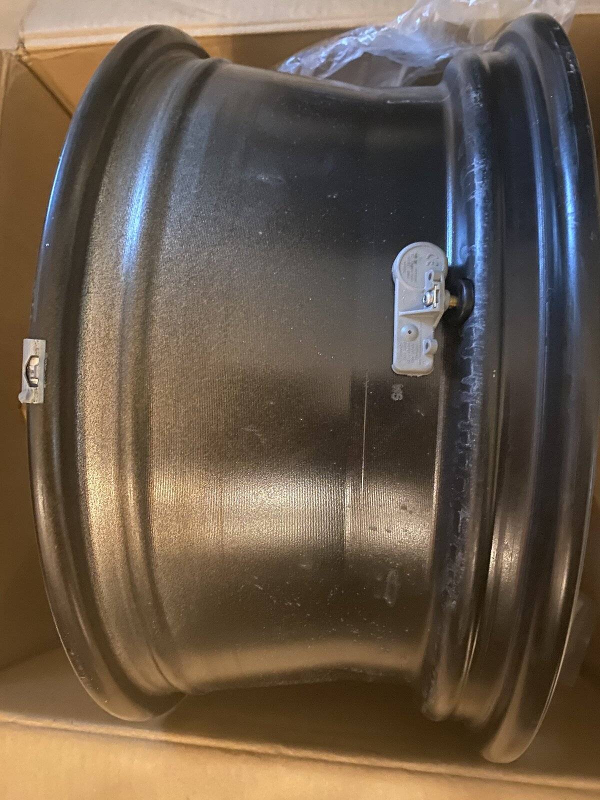

Pic of a TPMS on a JL wheel:
Yes, your JL knows exactly which rim is where, usually within seconds of a tire rotation for example. Yes, It's all done automatically.
The JL, does have a TPMS sensor in the spare, but it is not read by a chassis sensor/ considered by the computer until it is placed in one of the 4 tire positions.
