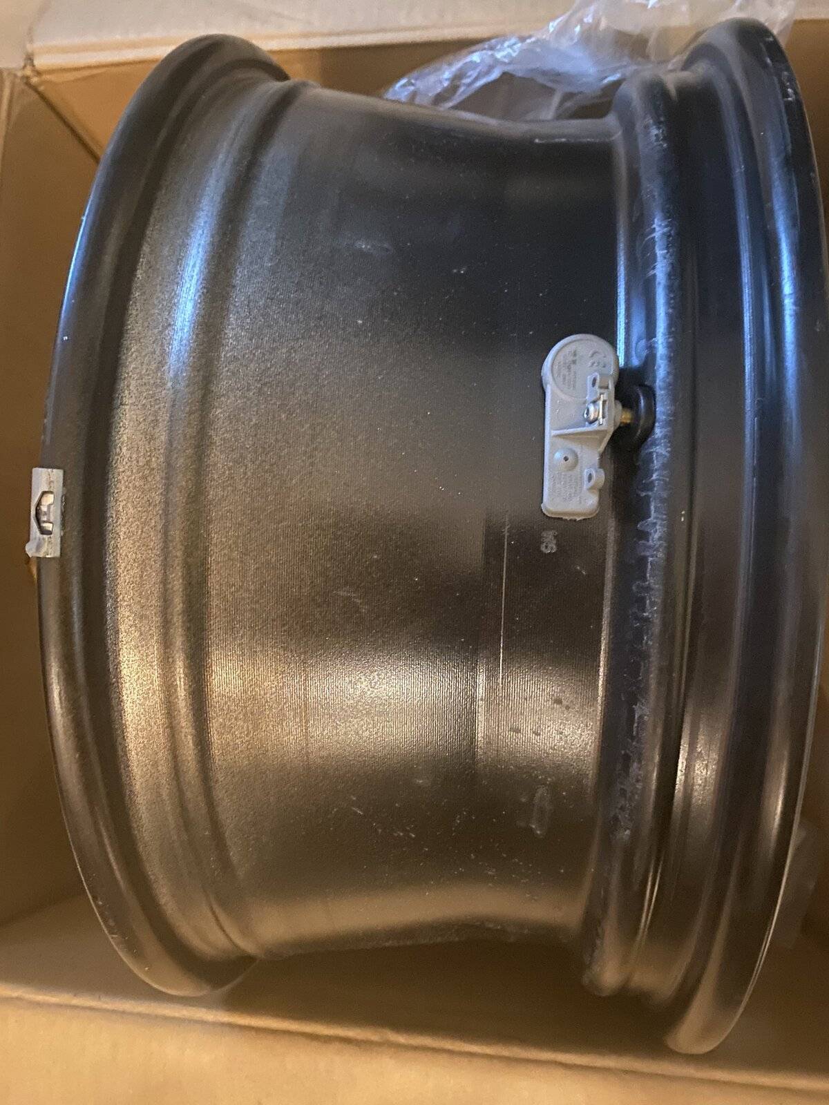

DO , do listen to @Goin2drt ! ..... and do, do, in regard to your 2021 JL... keep your stock TPMS's and have them transferred to your new wheels... or you may truly regret not doing so. Get new valve stems only
Here is a pic of a wheel with the TPMS installed.. installed just like on your stock JL wheel.
