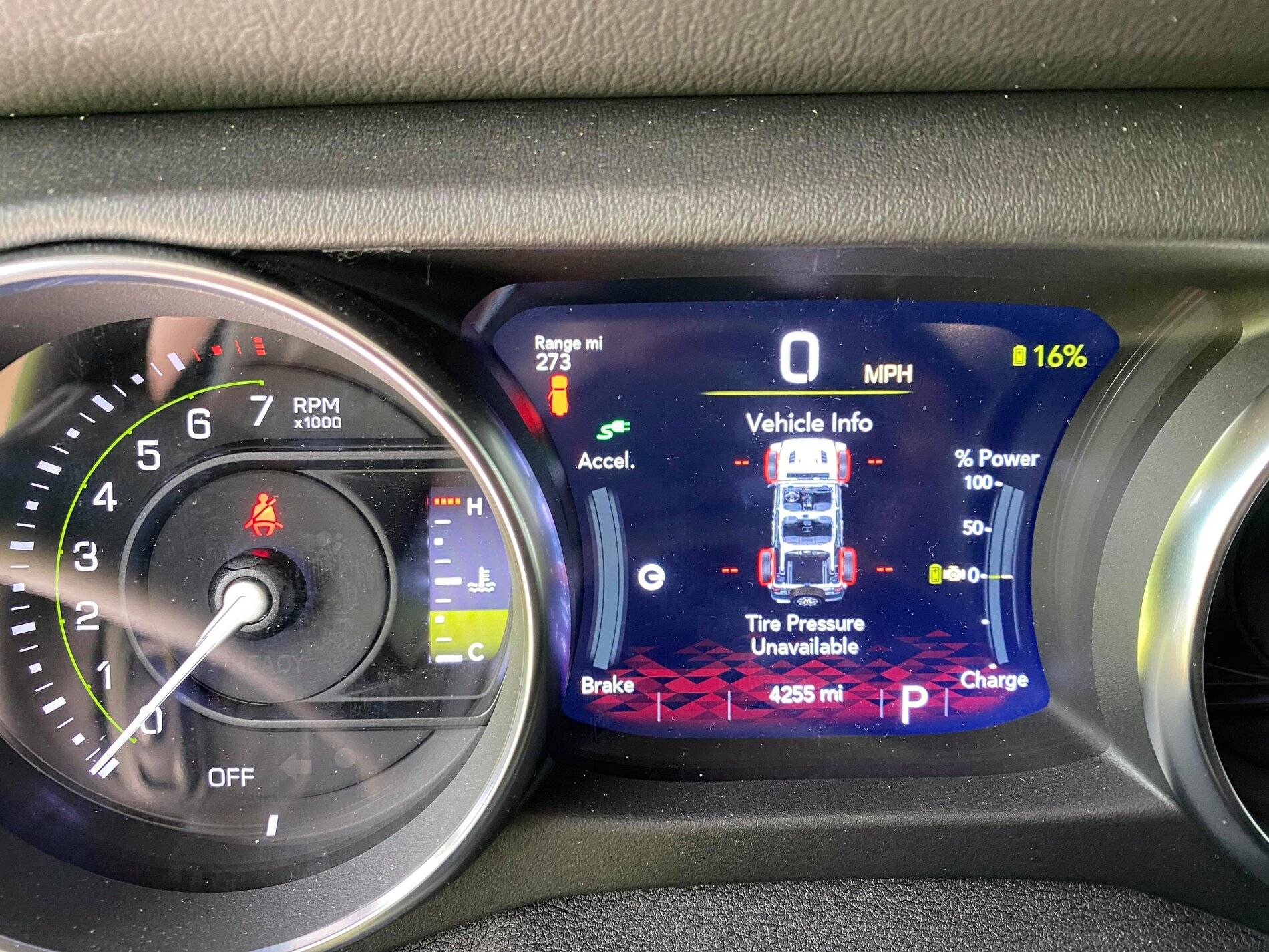

So, it sounds like there are two different frequencies that stock sensors on Wranglers might use? Are the OEM sensors able to switch frequencies? Is is possible that switching sensors from one frequency to the other causes an issue?
The dealer was... less than helpful. They said they cleared the codes and the TPMS error went away and stayed off. I picked it up, TPMS error message still showed, but the warning light was off. Still no pressures showing and 5 minutes into my drive home the warning light was back on. I won't be going back to that particular dealership.
I'll drive around this weekend, deflate, inflate etc., and see if it clears things up.

Okay, so these still aren't coming on. Went for a longish drive on Sunday, today I aired down to 25 psi, drove 4 miles or so, filled back up to 36 and drove another 15 miles. Still nothing.
These are the original tpms sensors in stock 392 wheels that came off with around 100 miles on them and sat for about 3 weeks before I picked them up and swapped them over. No other wheels/tpms sensors are near my Jeep.
Other than giving it a few more days and driving around, do you have any suggestions?
Original part# from my 4xe was 68510382AA, so is it the 29093 I want to order if these dont start working soon?

So, i didnt get these from the dealer. They haven't done anything except, 8n their own words, try to program them. They told me that the tpms sensors arent the right part number and vin'ed to the 392.
Also, the guy was kind of an idiot as I asked them to tighten the ball joints and instead they tell me I need new hubs and didnt even look at the castle nuts, just did what the decision tree said based on the clicking when you turn at low speeds. So i have zero faith in them.
The wheels came straight off a 392 from a woman near Hollywood FL, sat at her friends shop for 3 weeks until I picked them up. She ordered new wheels and tires as a package online that came with new sensors. Its possible he swapped them, but I dont see why he would bother.

ok... I was trying to type on my tablet so I thought I'd sit at the computer and write it all out:
I bought these wheels from a woman in Hollywood (FL). According to her, they came right off her 392 and her friend put on her new tires/wheels at his shop. They then sat there for 3 weeks while she tried to sell them, until I picked them up.
I'm pretty sure I got a reading off of them when I first swapped them over as my original tires were sitting at 34 psi. When I put the new wheels on, I aired them all up to 36. They showed up as the two in the rear at 36 and the two front at 37. Everything seemed good. Drove around minimally for a couple of days.
I've had the clicking from the front end when moving slow and turning and I wanted the dealer to check out the ball joints to tighten up the castle nuts. On the way to the dealer, my TPMS sensors cut out, warning light came on and it's stayed that way ever since (see pictures from previous post).
Dealer said they were vin'ed to a 392 and they couldn't program them, and that I needed to buy a new set for them to install @500 for the new sensors plus labor. I tried not to laugh at him and left.
I've also been told that the TPMS sensors were changed to a new part number in late may/early June and that I need the older model (which seemed odd). It tracks with what you said somewhere else about the initial TPMS units with the 29117 being discontinued and replaced with the 29093's but either should work.
Today, I aired down to 25 psi, drove around a bit (about 5 miles), aired back up to 36 (what it says on the door placard) and drove some more but it didn't clear up. Sounds like I should have aired down lower and pulled the spare off the mount too, which I can do tomorrow as another test.
Also, I suppose it's possible that the original owner I got the tires from got TPMS sensors in her new tires that didn't support TFA, and her buddy swapped them out for her original sensors if she had that feature on her 392, but even then, the sensors in the wheels should still work, just not allow me to use that feature, right? Unless that happened, the sensors in my wheels should be as they were from the factory as it's still the original wheel/tire combo that was original to the 392.
