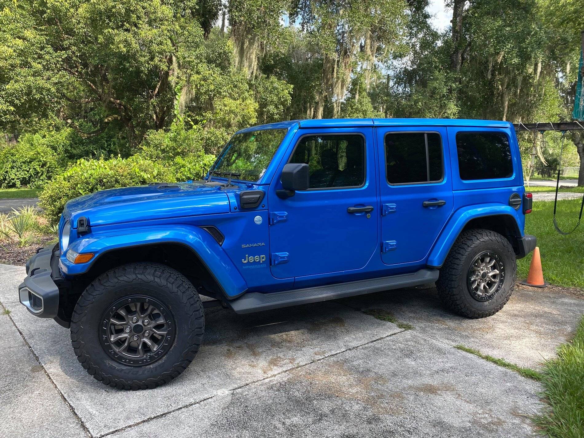

I see the stock 392 wheels and tires as new take offs all day on FB for $2500. I contacted a couple sellers and they had no interest in negotiating on price and one guy said he has sold 5 sets so far at that price point (from various people he's swapped out new wheels/tires for on their new 392s).
I waited. Found someone about 3 hours from me who had posted hers for sale but didn't want to sit on them since she had no storage space and they were sitting at her friends tire shop. $1800 is what I picked them up for, though I will also say they had no TPMS sensors so it also cost me a little time and a set of sensors from TPMS Bargains (thanks again for the help @Goin2drt )!
Still a good deal though, and a great look...
