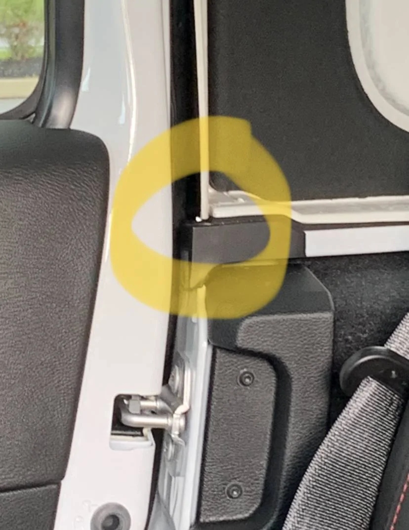

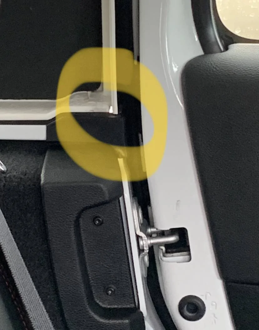

....same same but mine sprays through the rear doors at the point where the hard top and body align.....I am going to discuss this with the dealer but my JK never did such shenanigans.....
This is probably the spot, on my new 2023!

Mine is at the dealer right now checking this out.

So it is not the hard top to body. Apparently it is that corner of the hardtop. They put a little silicon in that hole, will take pics. The other response was, don't go through a car wash. Yeah... ok.

Silicon as a "fix" may work until it gets cold out. Unless I don't understand how silicon works in hot vs cold ?
