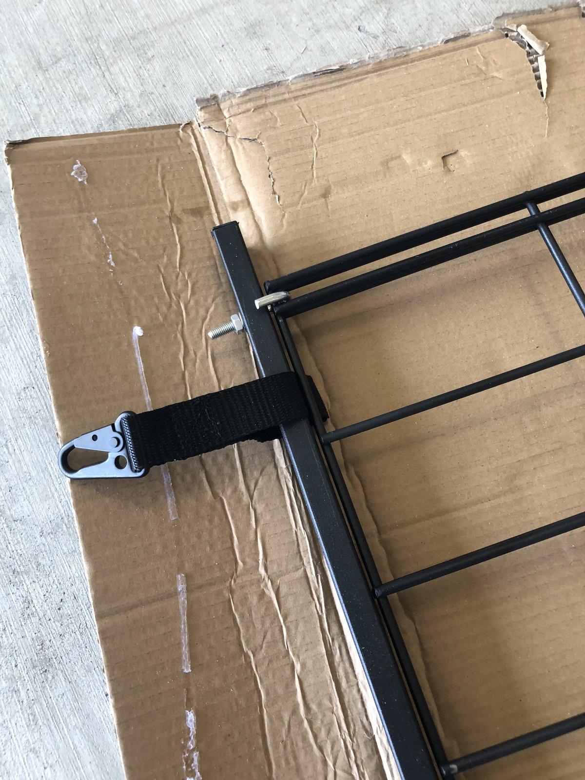

Using my Topsy brackets with my homemade hoist and rig.
That's what I'm talking about. Kinda what I had in mind. Make a frame to attach the clips/straps to, and then devise a hoist for that frame. Any details on your hoist method?

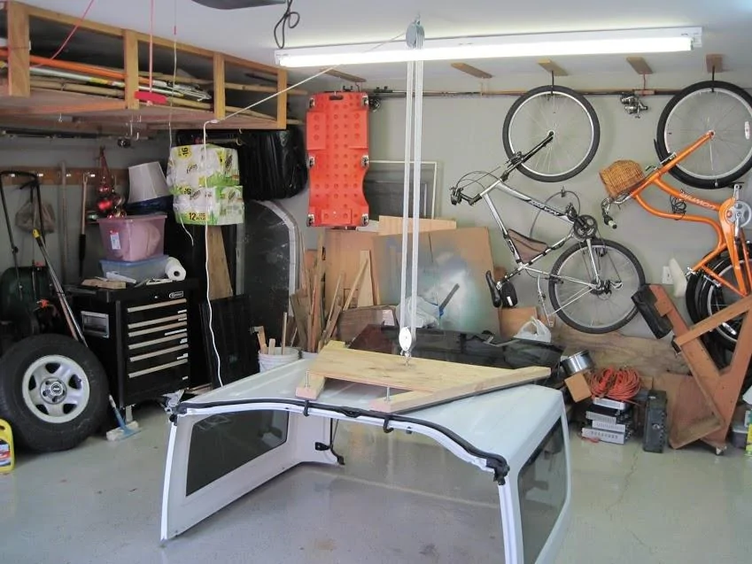

Mine is based on this man's design. I used it with my 2014 JKU Sport and had to modify it to work with my JLUR. I switched to using the Topsy brackets for the rear(can keep rear glass closed!) and the I had to balance it out(the JLU's top is more front heavy).
Excellent, thanks for the info. I actually happen to have that same block & tackle. I had bought it for a one time job, so I think it may have just found a new use.
I've been going to order a Topsy kit, but was waiting to decide if I was going to use an overhead lift or find another method. I'll design mine to work with the Topsy hooks, and strap (the $50 kit, not the hinge bracket only kit).
Like the guy in the video, I'm going to be guessing at the center point. Any measurement on yours to get me close to the balance point?
Have you had any issues with getting the cover on/off since it can spin around on a single point?
I guess I could put some guide wires on the frame to keep it from spinning to much, or so I can guide it as I raise/lower the top.

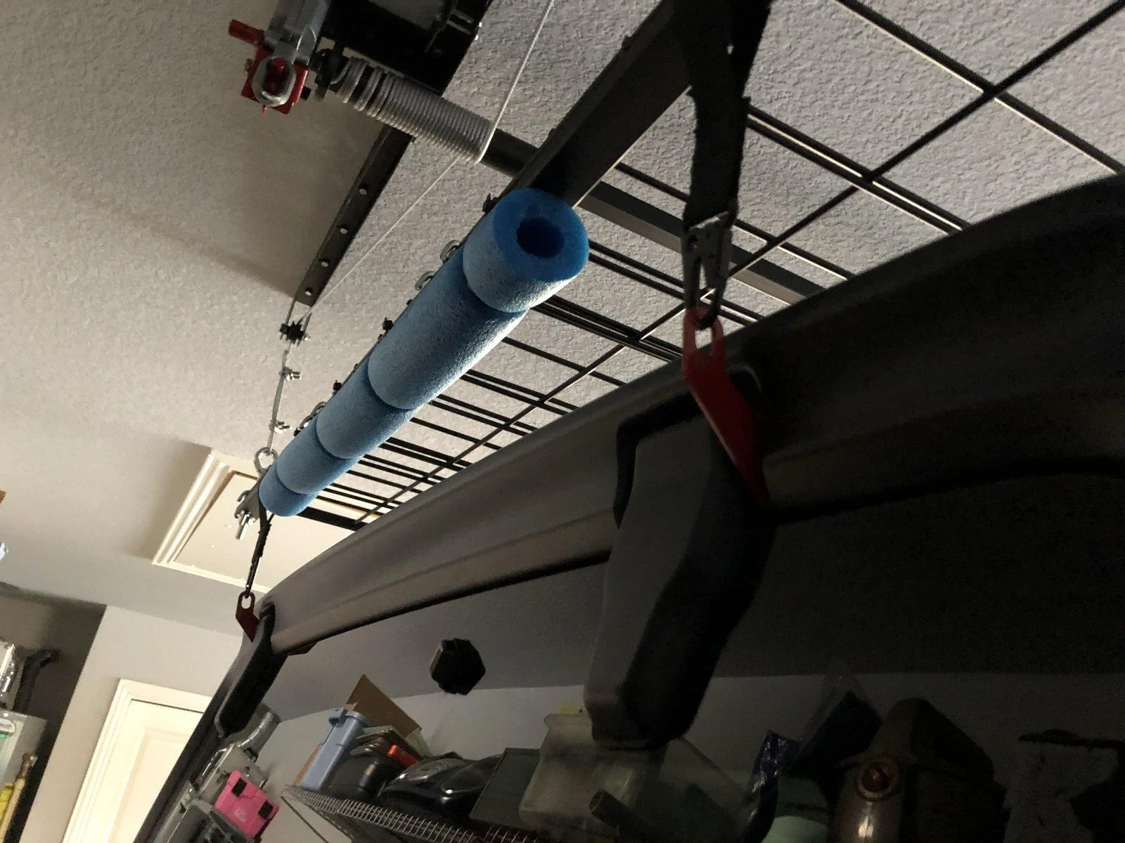

If you put them on the support beam, they can slide. You want that. You won’t always back your Jeep in exactly perfect. And you don’t want it to swing.
Here’s how I attached mine.

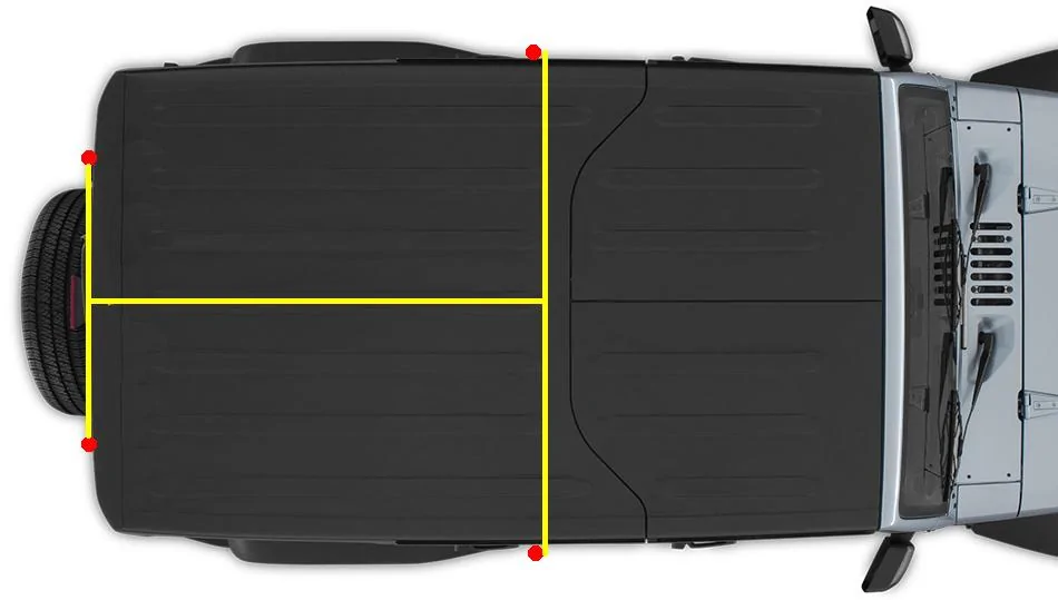

@STLYoungblood - I greatly appreciate it. My drops from the ceiling will be where the red dots are on the attached picture. If you wouldn't mind, could you shoot me the dimensions of the yellow lines? Thanks a lot for your help.
I'll do this tomorrow morning before I start work (working at home tomorrow). Got some family nonsense keeping me away from it right now.
STLYoungblood
May 21, 2018
131
171
St. Louis, MO
2018 Wrangler JLU Sport S Ocean Blue
No rush - totally understand!
Ok, I was alone, so the measurements from front to back and front side to side aren't perfect, but they're pretty close:
Hinge Bracket to Bracket: 34 3/8 ish
Front Top Side to Side: 59"
Front to back: 95"
Hope that helps!
