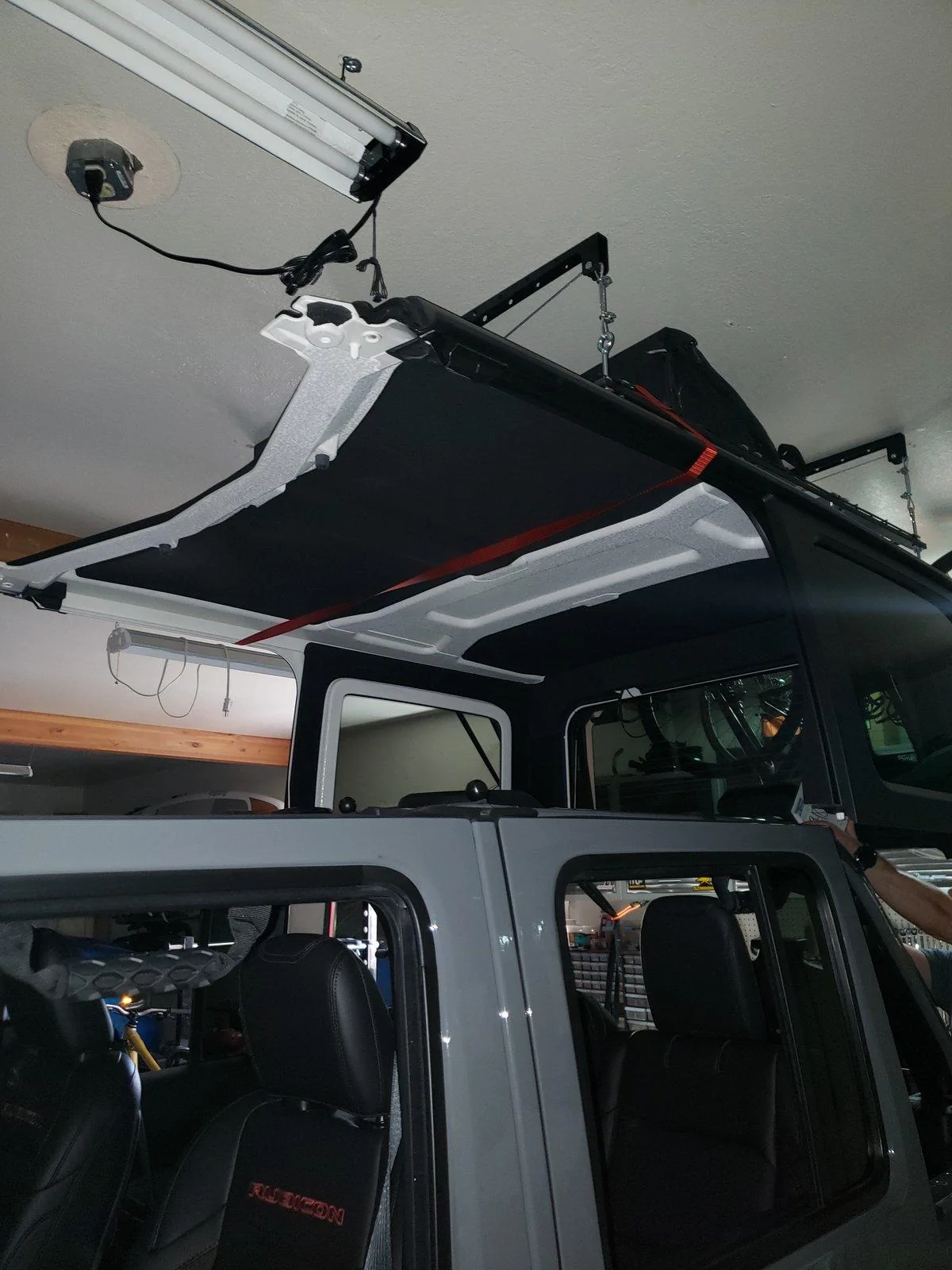

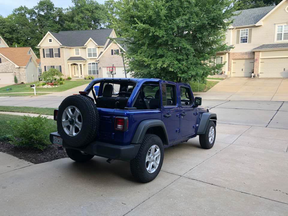

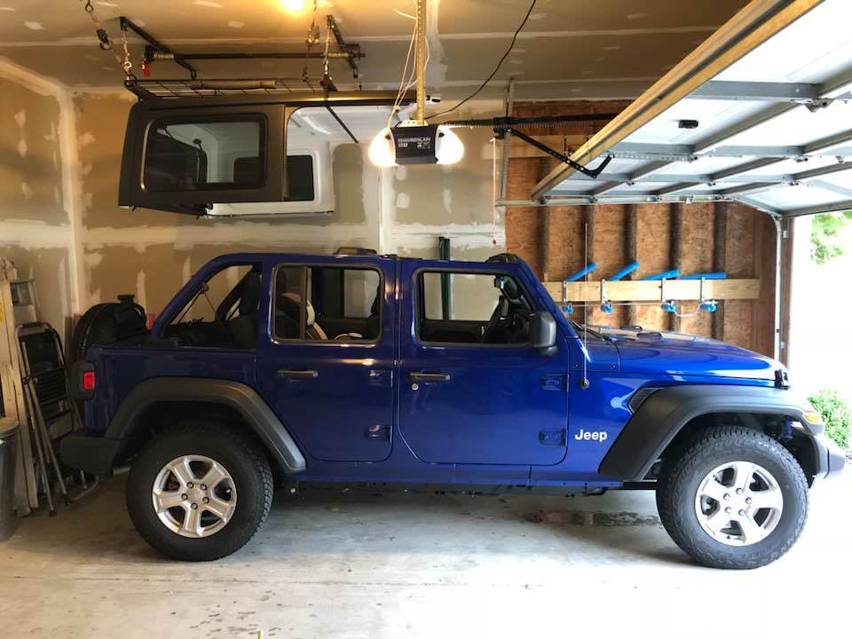

Installed my Racor Lift and yanked the hard top off for the first time, and took her for a spin of course.
Overall, it was a total breeze. The strap in the front could stand to be like an inch longer, so that took a bit of fenagling. You'll notice evidence of my distrust here. I installed 4 eyehooks into the joists and have a ratchet strap hooked from each to the shelf itself, not tight enough to actually do the lifting, but close in case something fails. I also swapped out 3 on each side of the 2.5 inch lag screws with some 3.5 inch that were a bit "girthier" lol. I don't trust it, so I over engineered it.

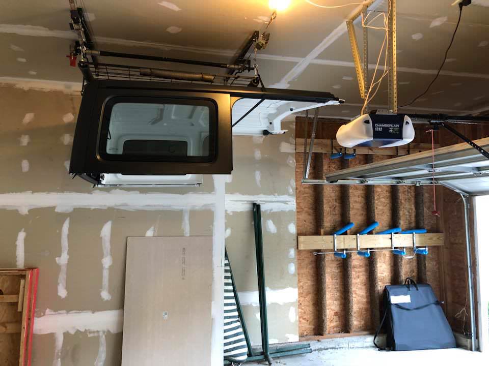

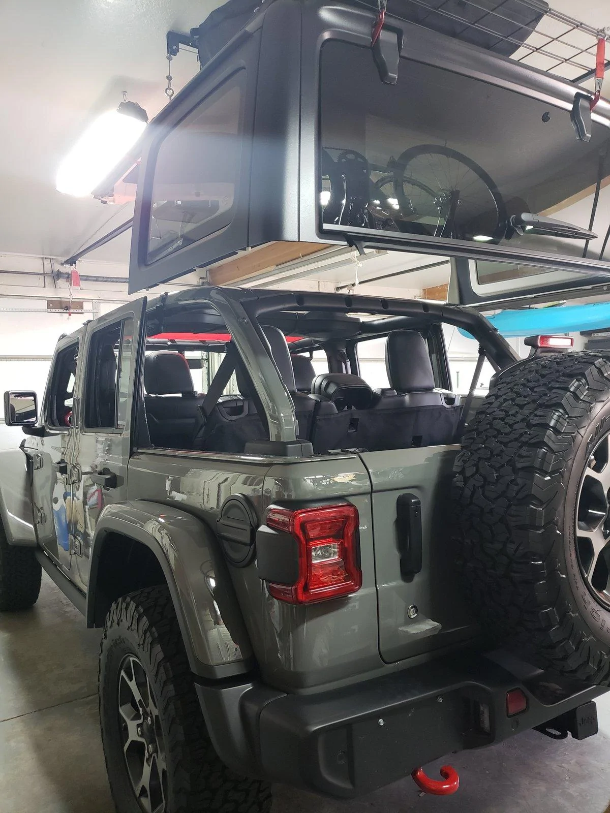

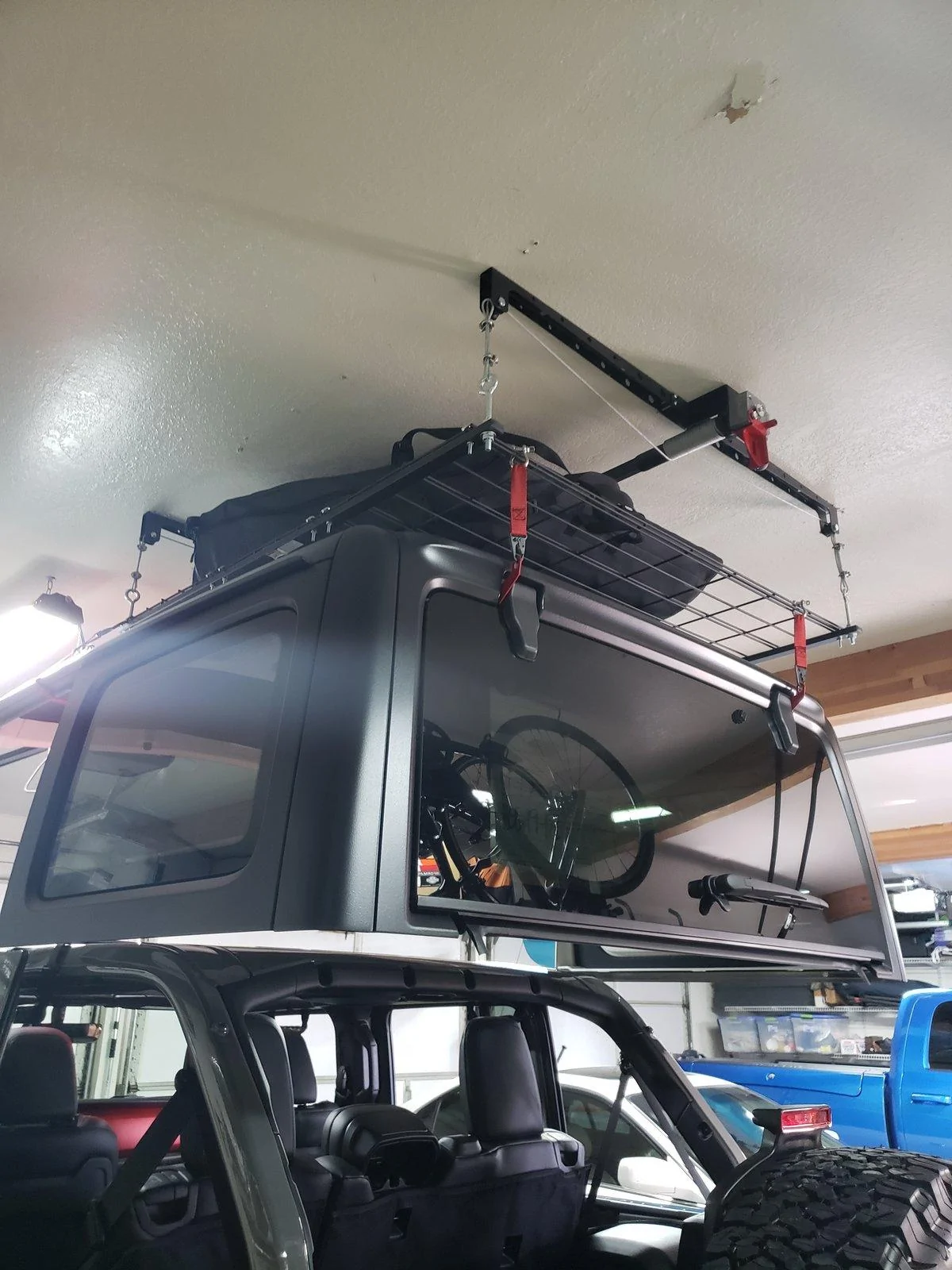

Just installed the tospy kit with a storage rack from Amazon..

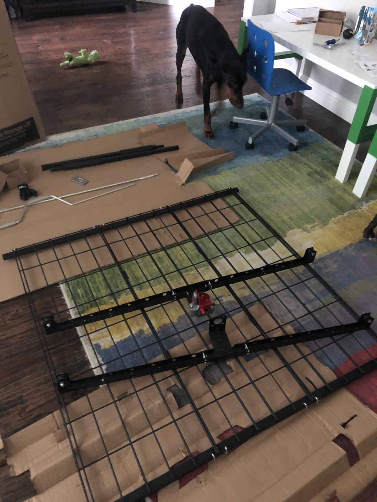

Goes up tomorrow morning! (Dog pictured is not helpful...)
