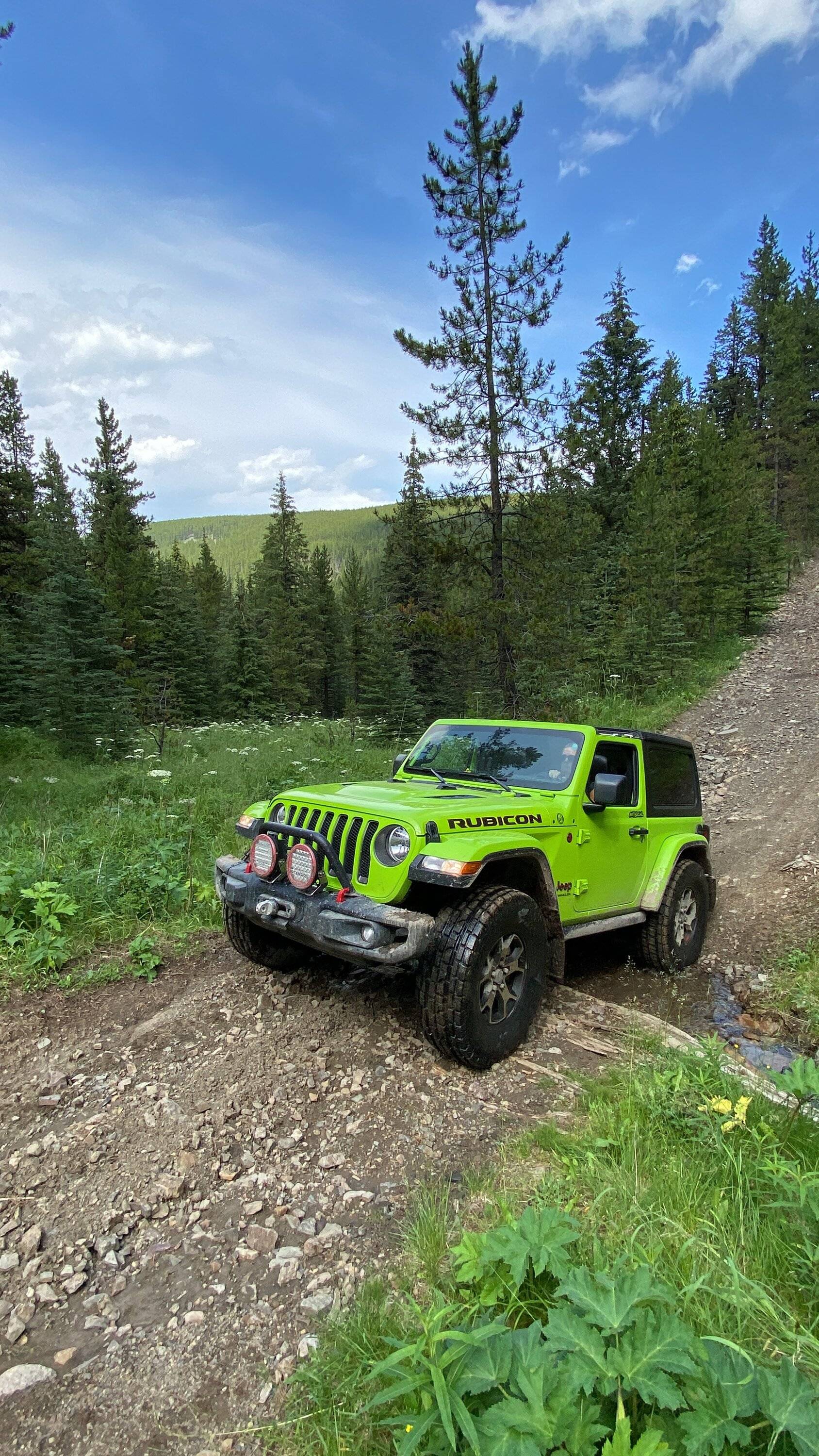

If you’re looking for a set of snow tires, nokian hakkapelittas come in a 315/70/17. Find someone’s take off rubicon rims, and mount these up. They’ll fit that rubicon, no issues. I’m running a 35x12.5-17” toyo MT on our JL rubicon. I'm in alberta, and understand why you need winter tires there, lol! Done the coq many a time in the winter, and the connector as well. That one gets nasty at times!
