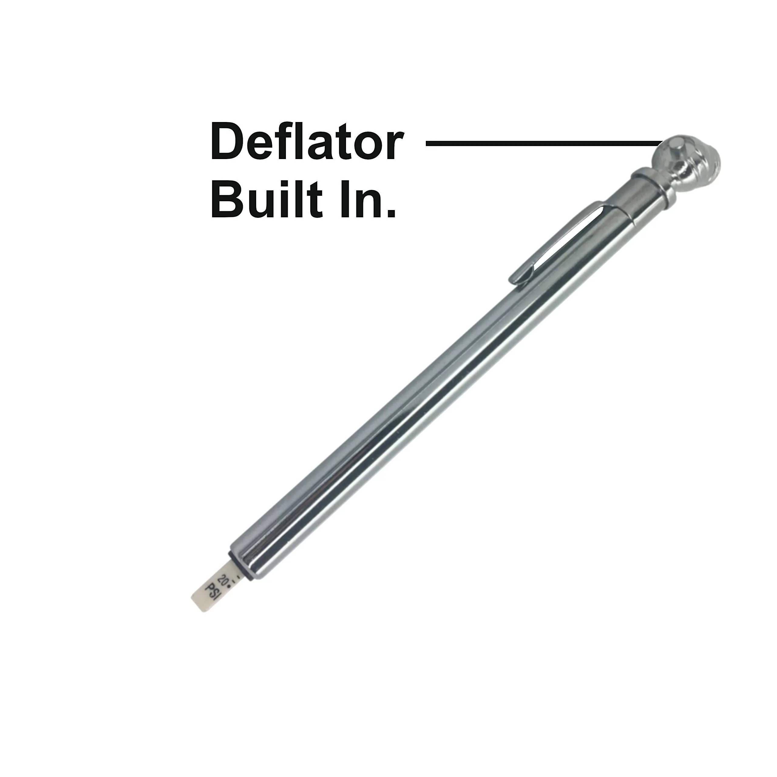

Am I seriously the only psycho here that uses the back of a tire gauge to drop pressure?
I can't fathom dropping pressure being this big of a deal. I'm on 37's so maybe the peeps with 39's and 40's that big fancy deflators make sense for. ?‍♂
I've been doing by depressing the schrader, but it's slow and you have to squat like a Chinese worker counting parts in a valve stem factory.

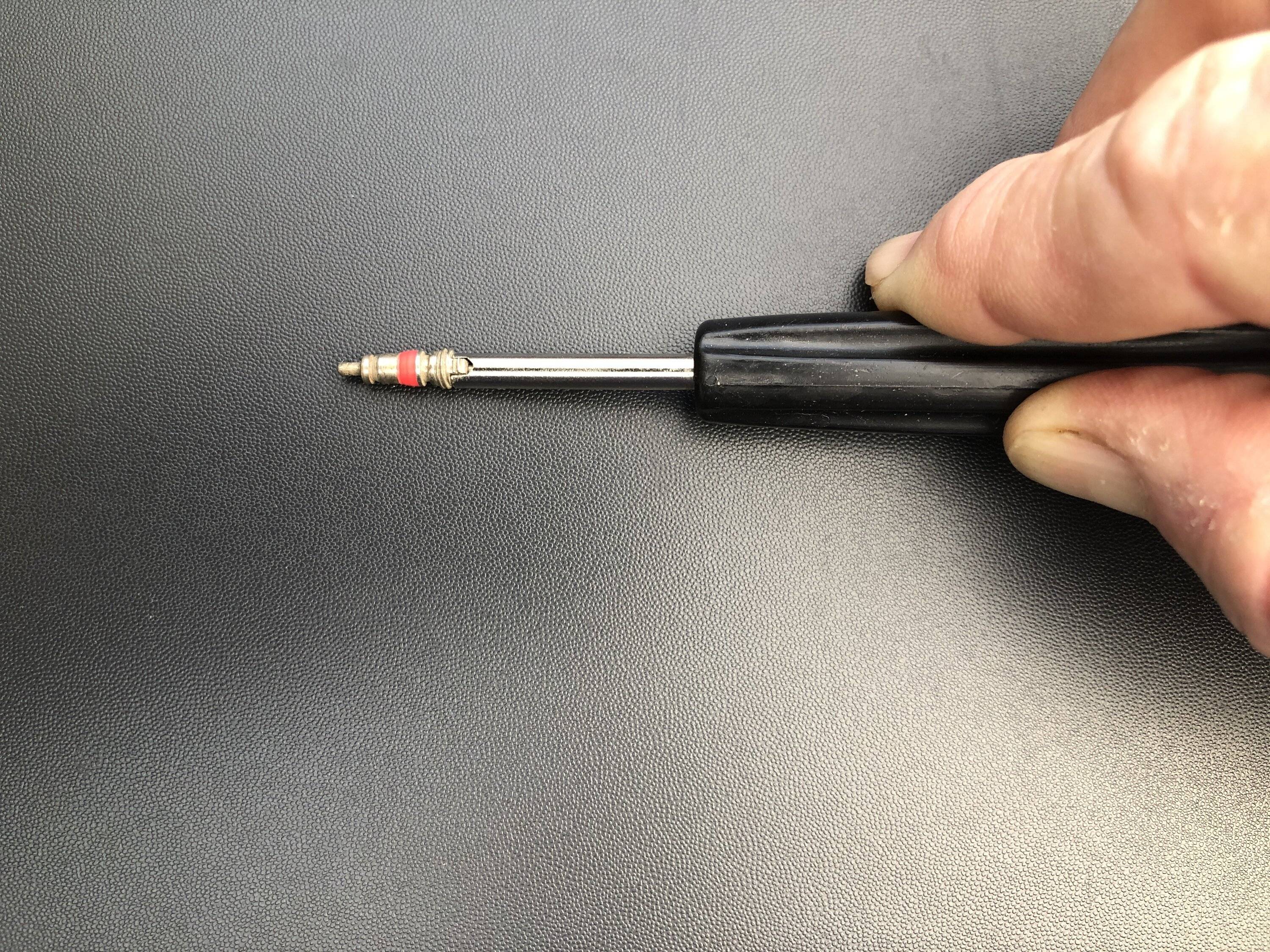

I think this is one of those things that so many people complicate unnecessarily. I have a core extractor and a simple pen pressure gauge. I spin the core out. Takes about 3 seconds. I pinch the core on the end of the extractor as it comes out so I don't lose it or drop it in the dirt. In the other hand I have the pen style pressure gauge. I check the pressure as the air is rushing out a couple times and when it gets to about where I want it (15-18) I screw the core back in. Done. Couldn't be easier--or faster. I have some extra cores just in case but have never lost or even dropped one. Keep it simple. My wife suggested we get another extractor and pen gauge. Then, she could do one side of the Jeep and I the other. Twice as fast. Probably under a minute and a half to do both sides.

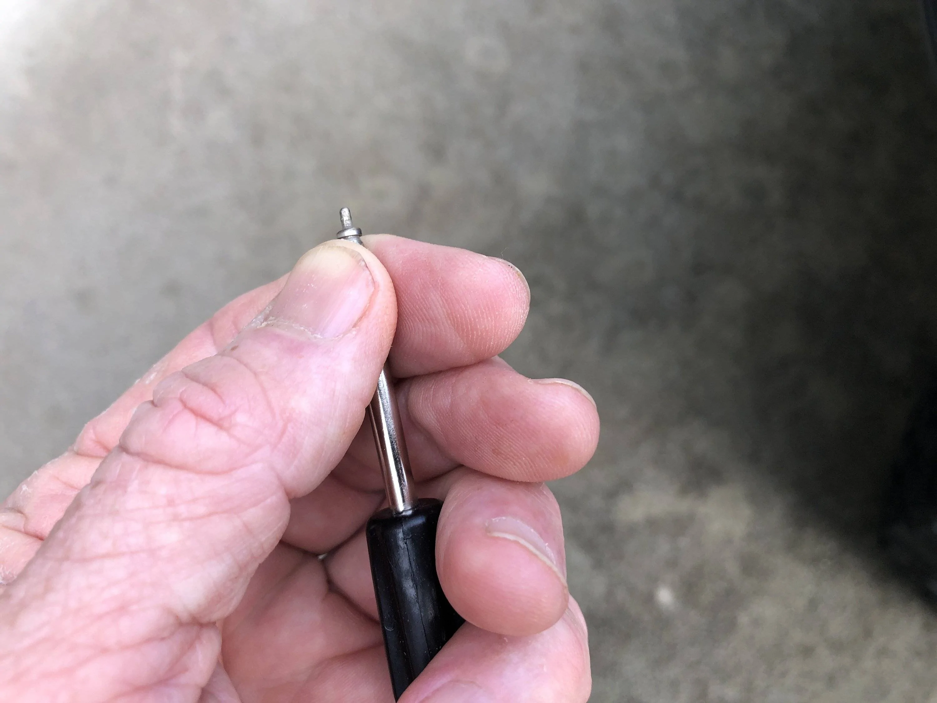

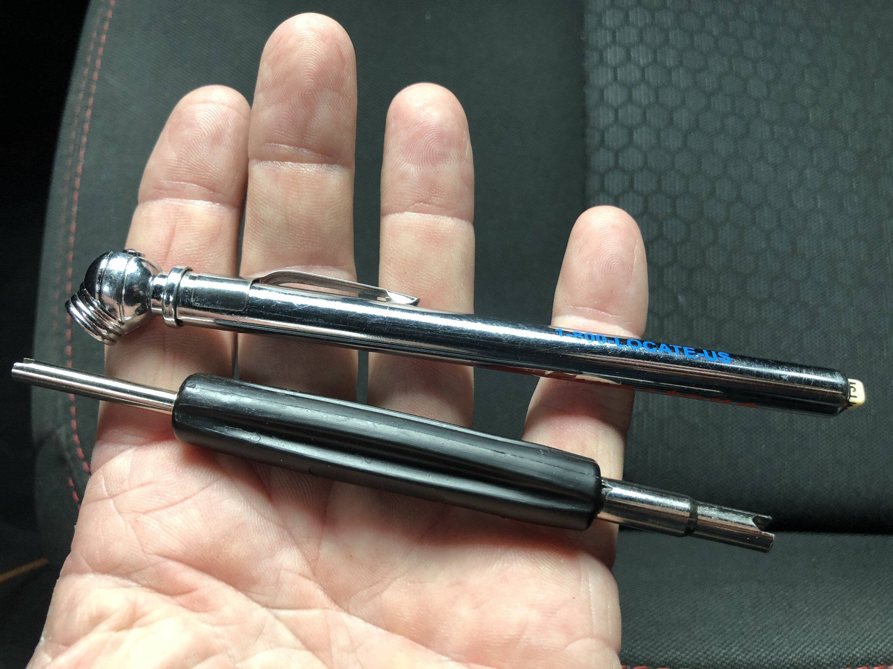

Well, in theory I suppose you could get contamination on them. In reality, not likely.
The threads on the core are always buried under your finger pads. you never remove the core from the end of the extractor. The threads are not exposed to the elements. You hold it like that till it's reinstalled. You don't hold them lose in your hands. If you dropped one in the dirt you can install a clean spare. But I have never dropped one. No dirt can get in the threads in the valve stem either because the air is rushing out.
There is no faster way to deflate a tire that I know than removing the core. That's all an ARB deflator is doing by the way. But the core is contained inside the apparatus and I am suggesting it's not necessary unless you are prone to dropping things.
It's a technique that's fast and simple and doesn't require more money or more gear. It follows the KISS rule. But by all means, everyone should use the method that they are comfortable with and gets the job done.

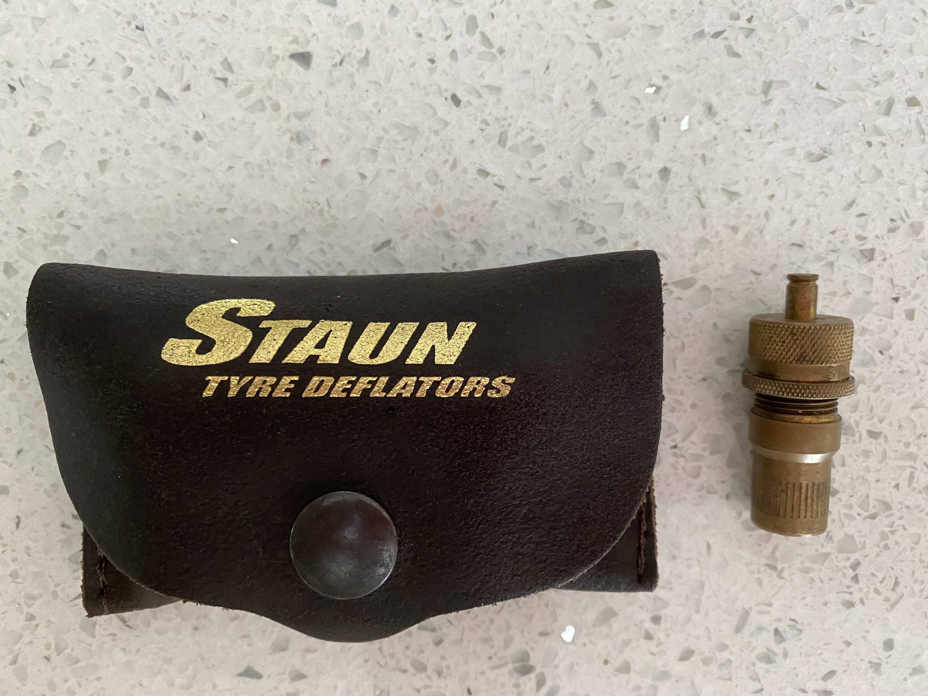

I like the buy once cry once mentality, but for as little as I'll use these, I'm wondering if this is a case where the brand name is nice, but the cheapies are "good enough".
Any words of wisdom to sway me one way or the other?
I use my deflators every time I go to the beach, so I spent the money on quality.
