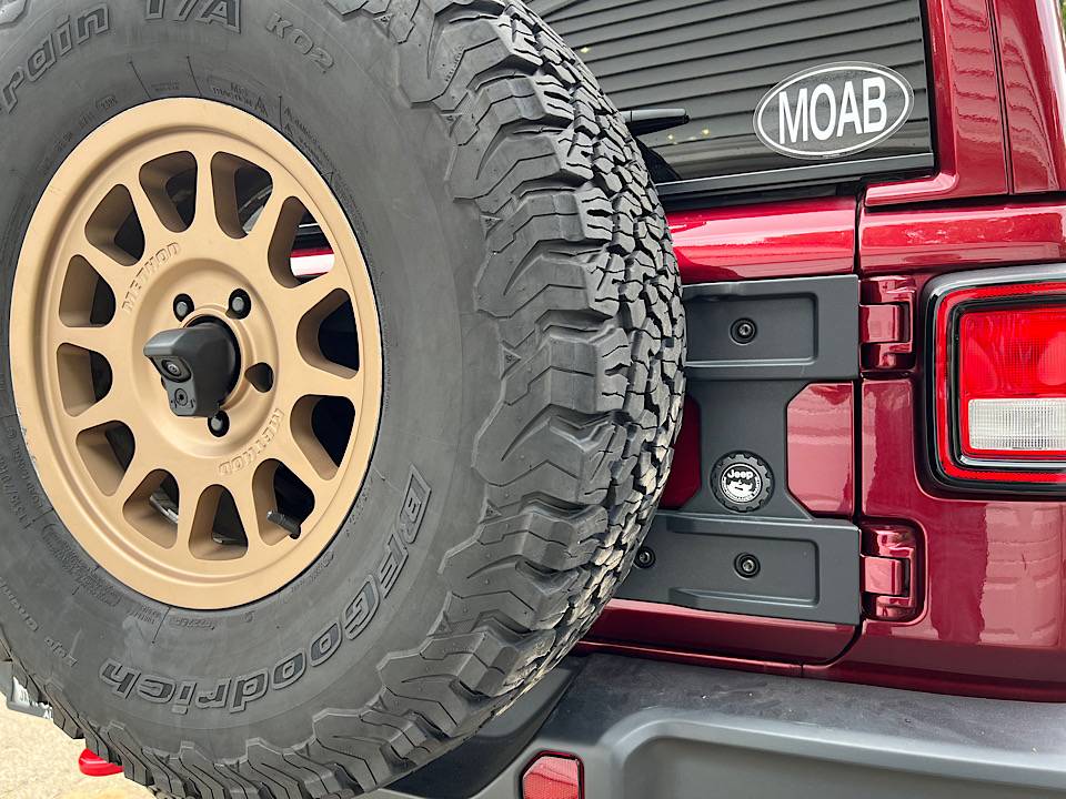

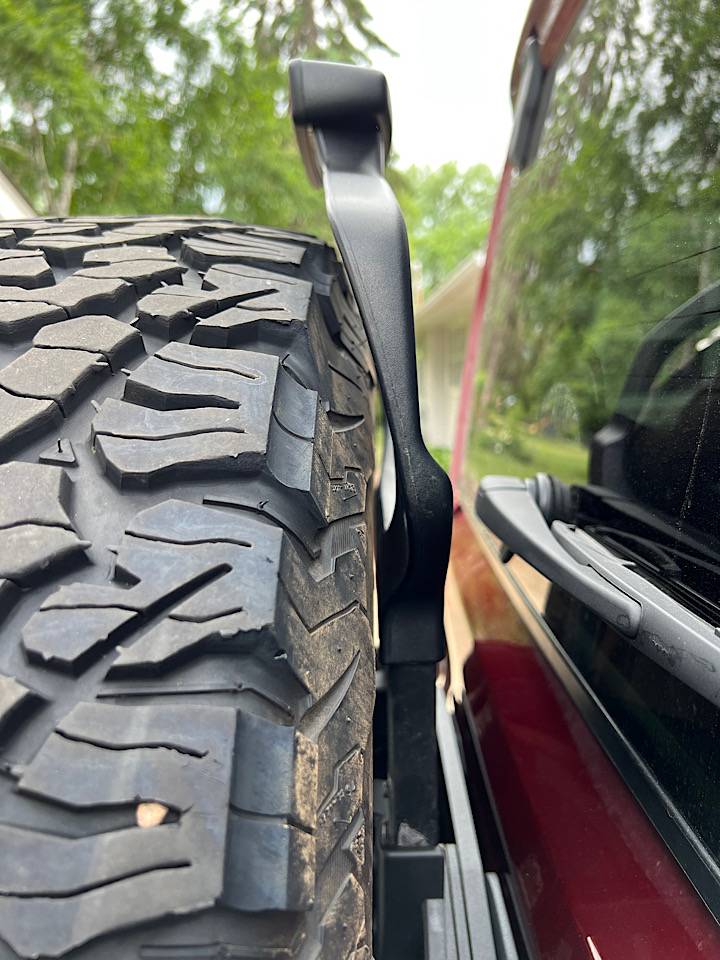

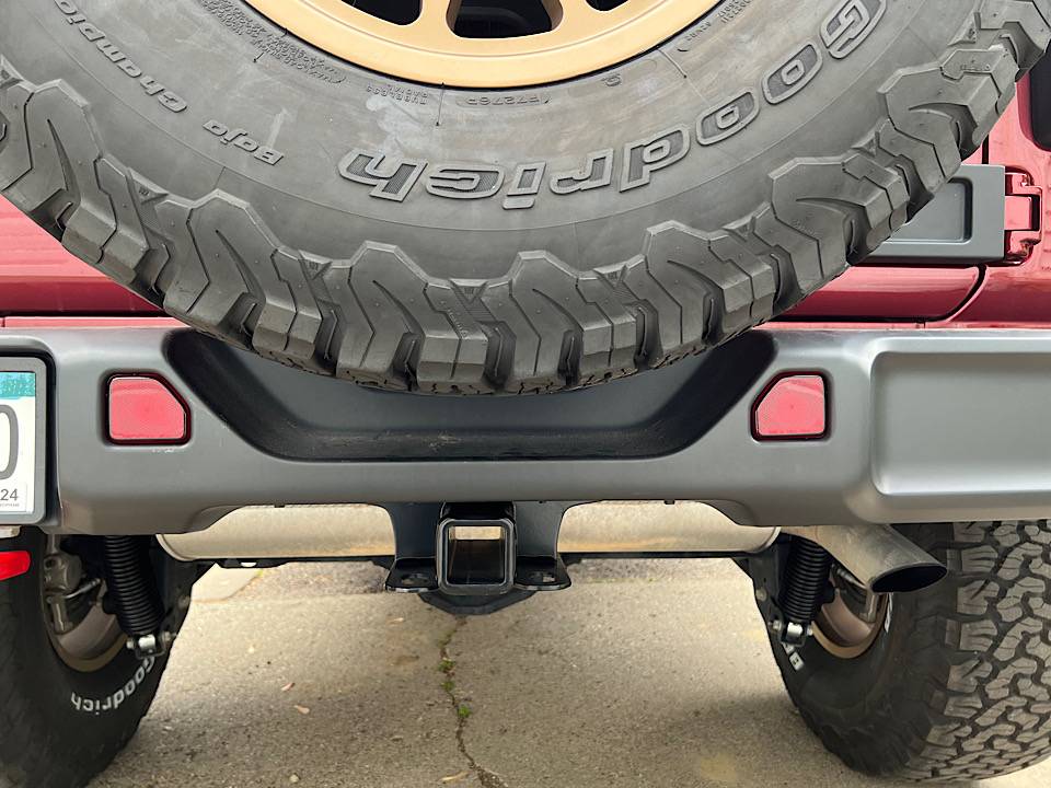

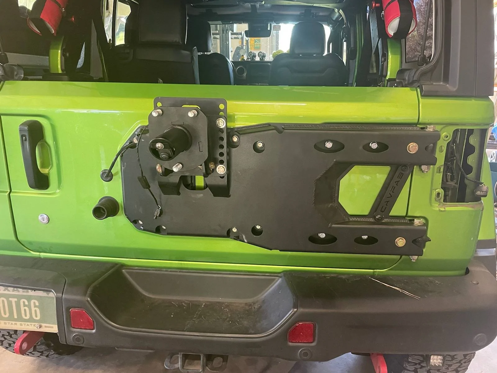

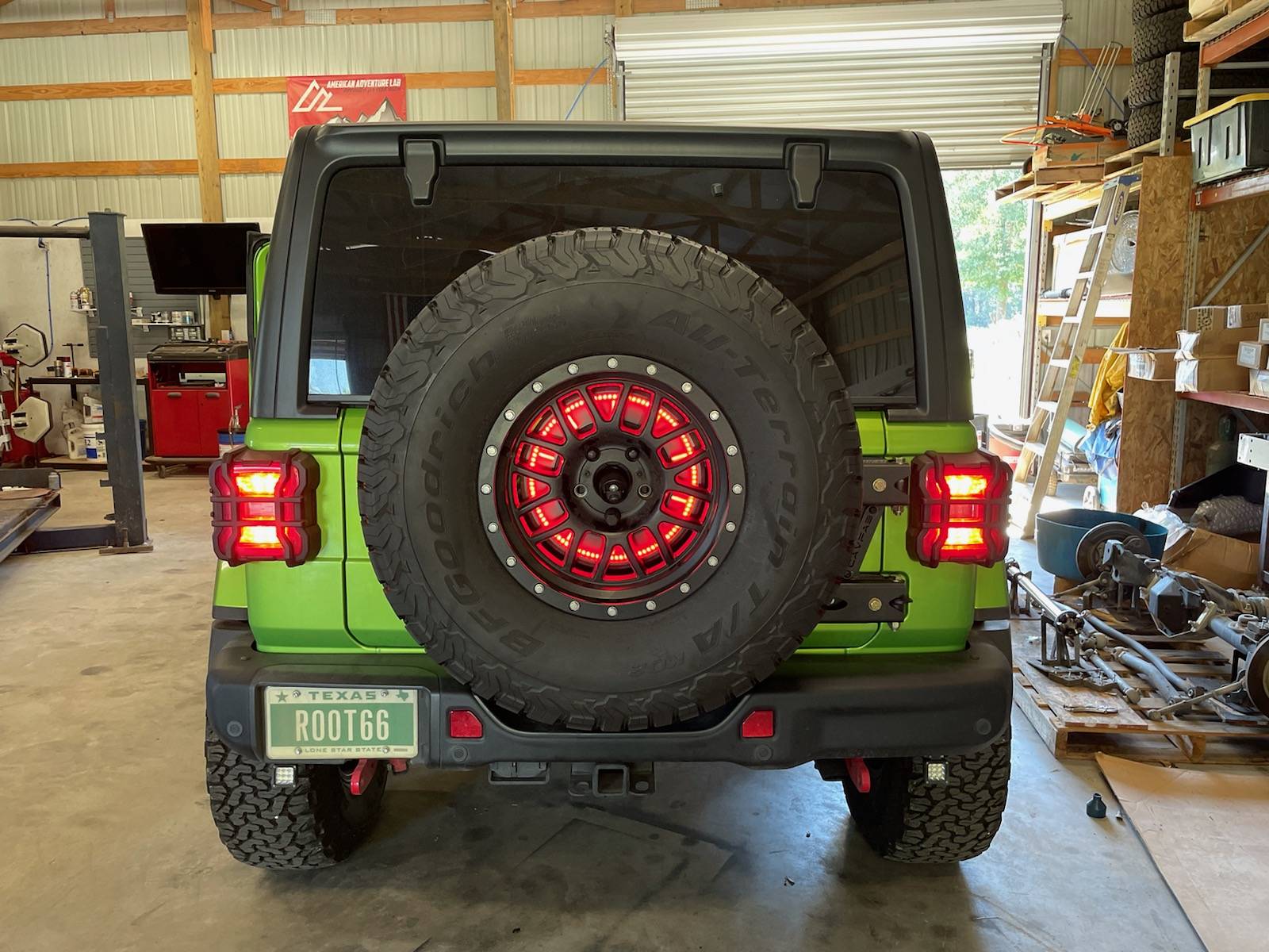

Just installed the Mopar tailgate reinforcement today. Been running 35s (KO2) for a year on the stock tailgate without issue.
Have 37 (KO2) now so wanted a bit of reinforcement and also needed to raise the spare a bit.
I can now go buy a 5th 37 for my spare to match the 4 others. Will see how it does long term.
(35 pictured).

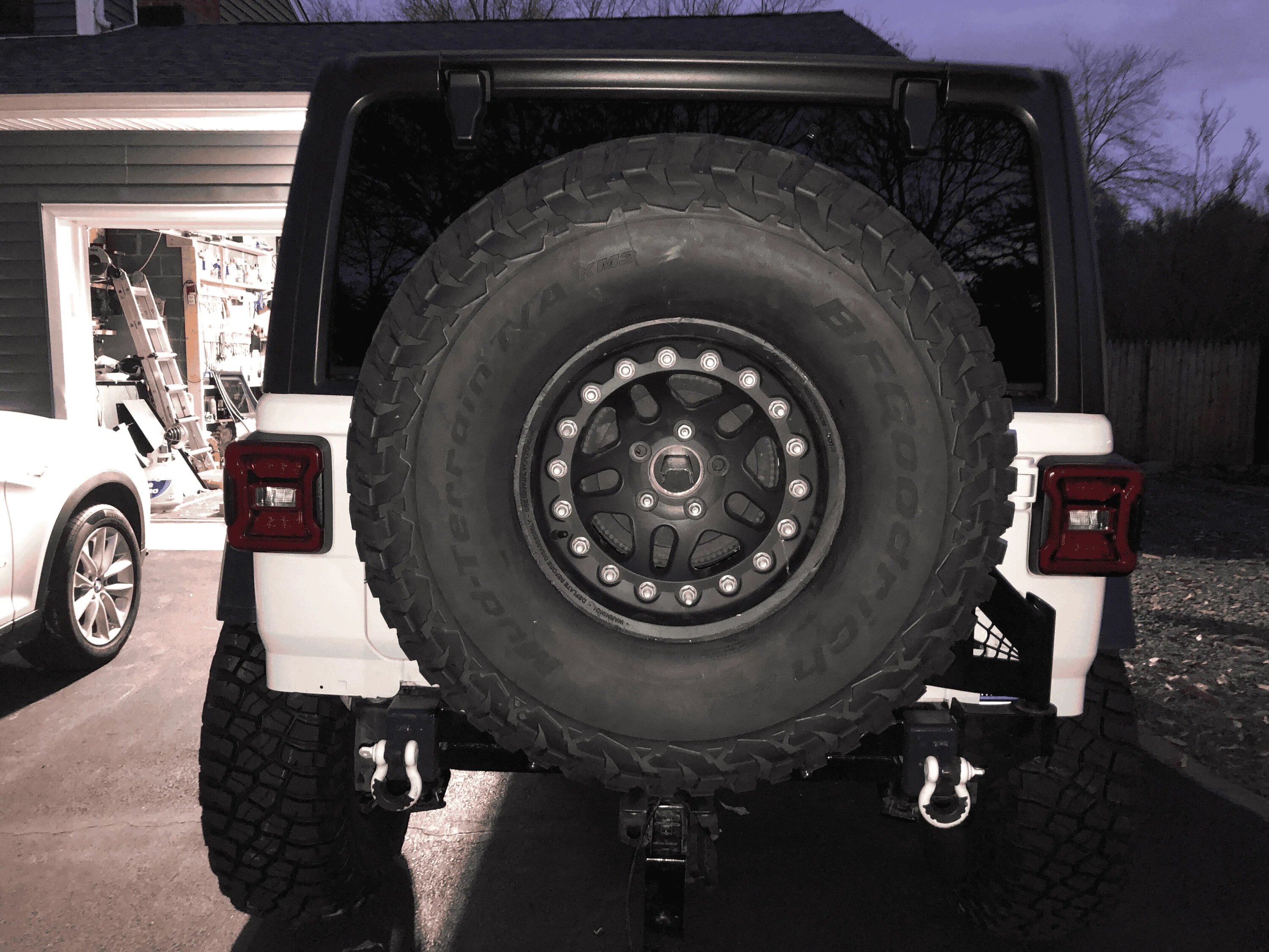

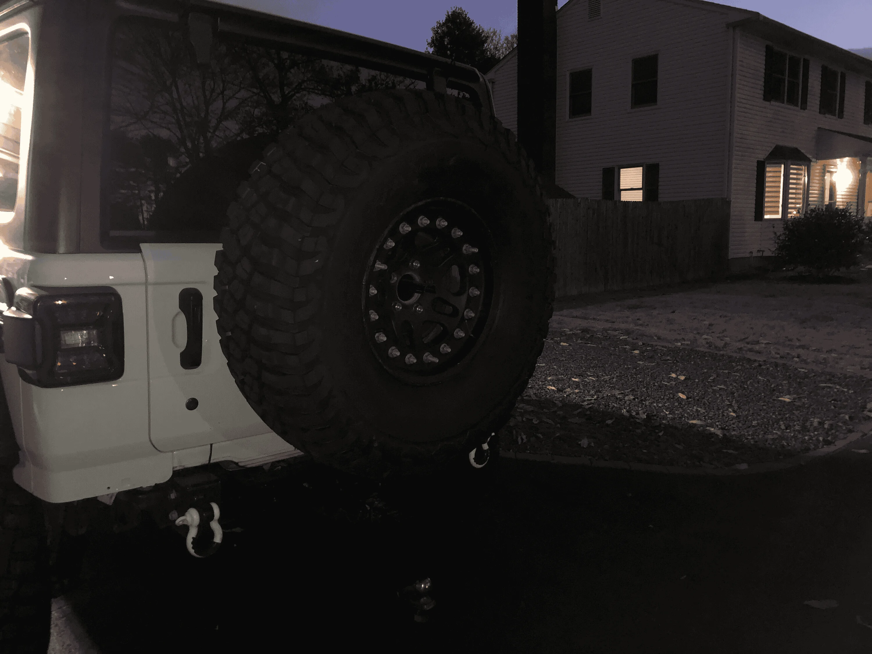

I went with the Poison Spyder frame mounted swing out tire carrier for my 39s. I have modded it a few times because of my heavy tire/wheel combo (138 lbs)
I will be welding a frame brace this week and if that fails, I'll think about removing the tailgate and doing a "pre runner" type bed carrier. ?‍♂

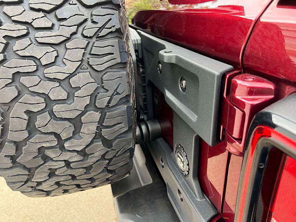

I just installed the Rusty's tire carrier.
It's pretty nice. The tailgate opens and closes better than stock.
The install isn't bad if you don't drop your rear view camera.

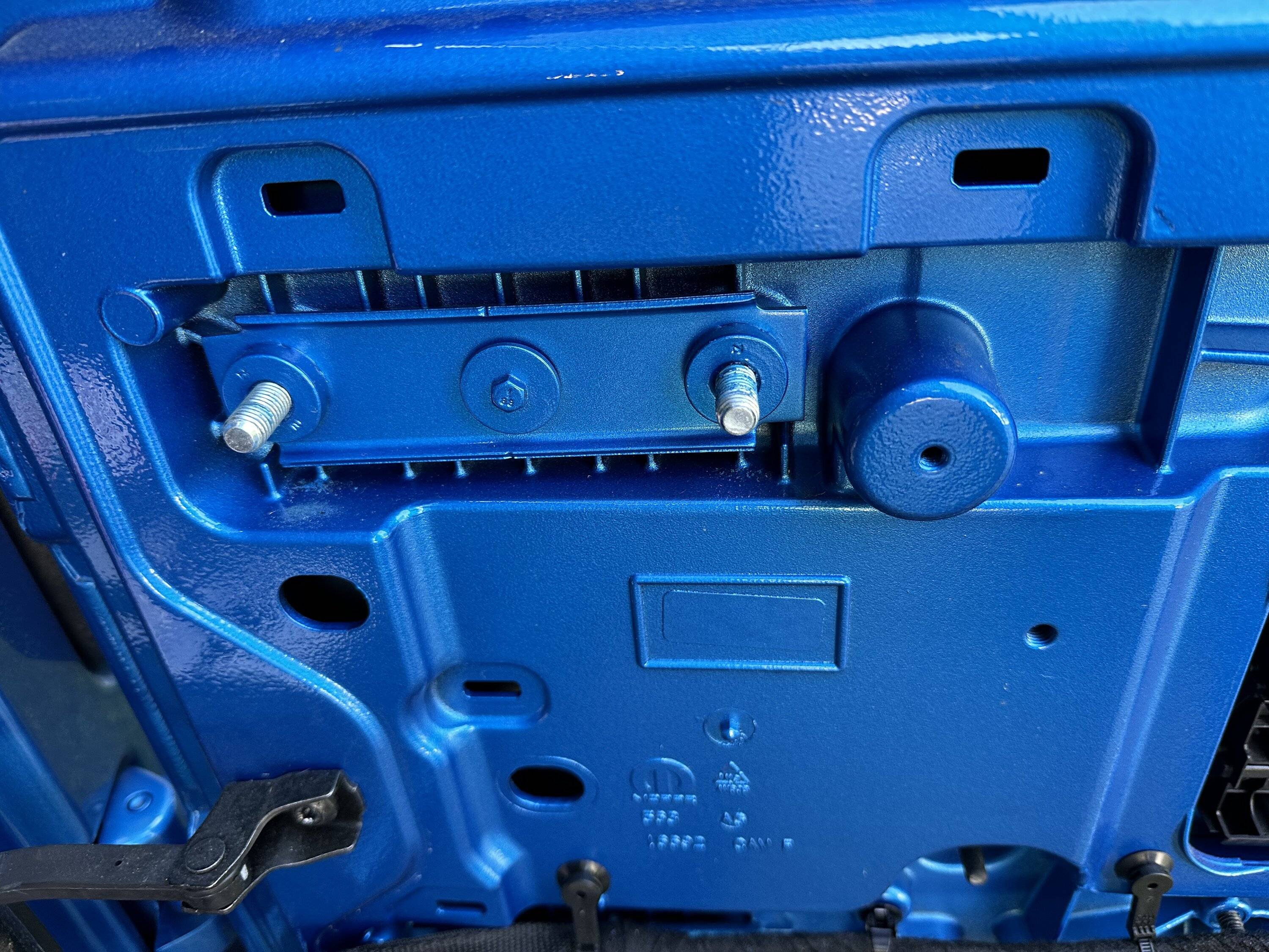

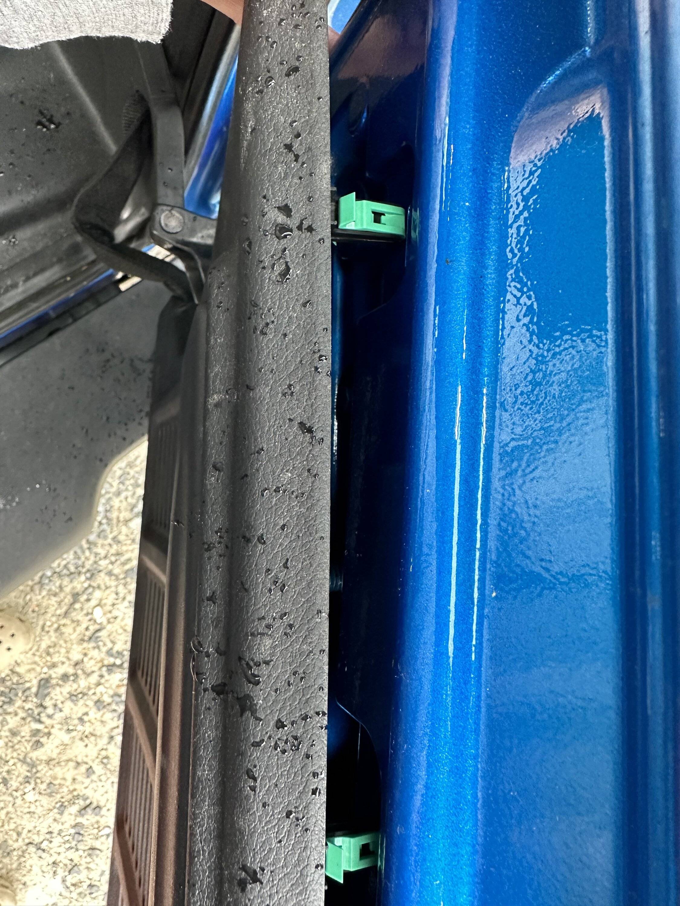

I have the RC reinforcement plate and relocation piece. I’m running 35s. Probs 100lb. And isn’t worth the money.

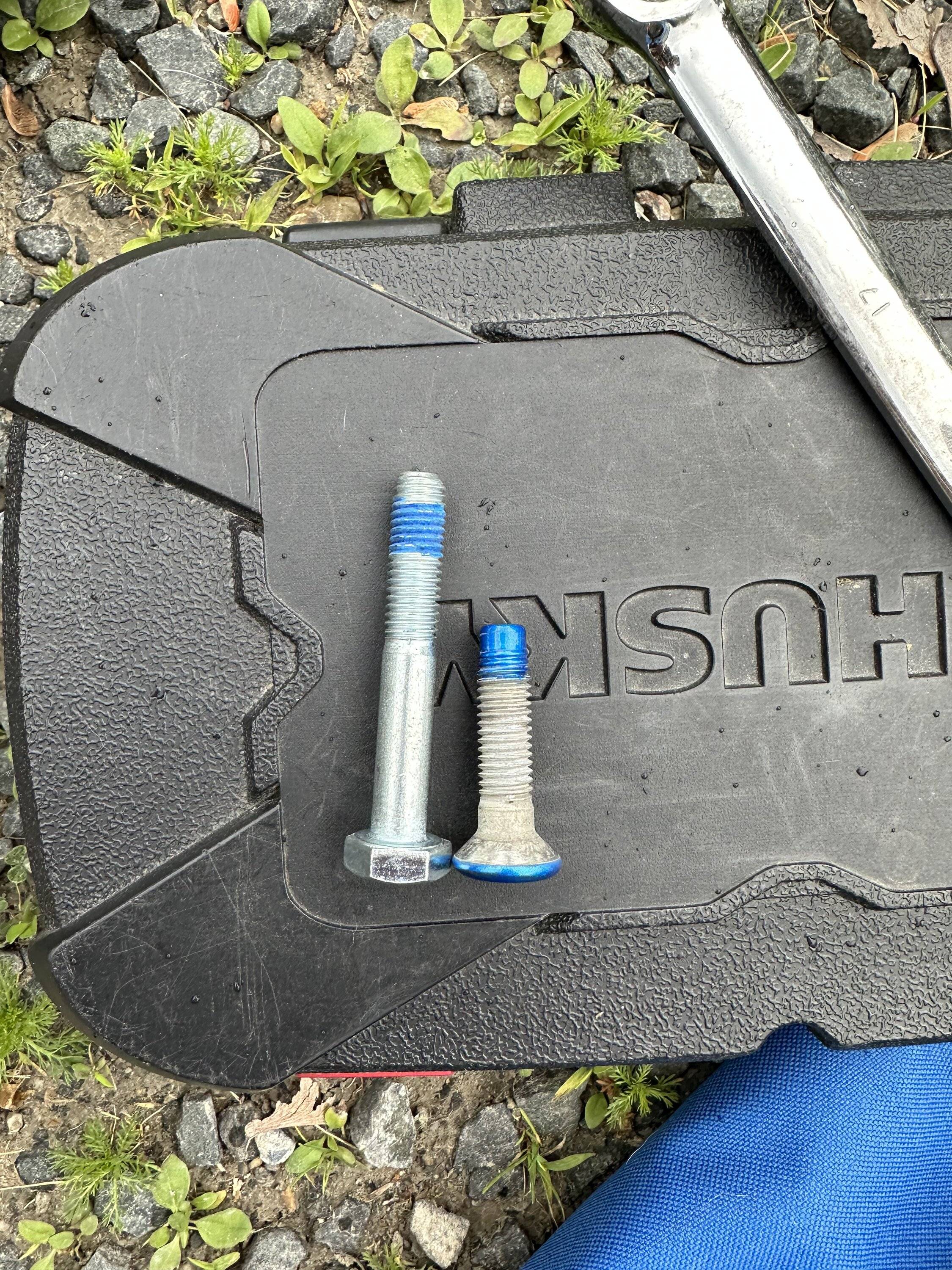

The reinforcement plate that bolts into the hinges comes with hinge bolts that are too long and they push the trail ready plastic piece right off the inside of the gate. It rattles even though everything is tight. Had to cut bolts down 1/2”. For it to actually work.
They half coated the relocation plate, so is rusting after few weeks. The warranty replacement they sent was welded askew so is unusable. I’m waiting on a third one. RC QC is non existent. The bolt issue has been going on since the JL launched and still isn’t fixed. Check any third party reviews.
you can see how it’s popped out. Also the shoulder bolts they provide only a few threads actually catch since the shoulder is almost as long as the oem bolts. Very few threads are holding your hinge plate on. Is a very dangerous setup to have all that weight held in by maybe 3 threads. I’ve sent all this to RC. They don’t seem to care.
