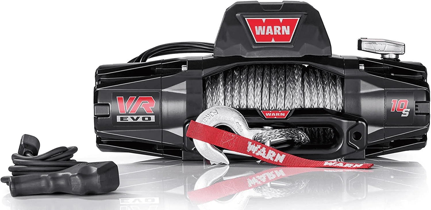

Thats a good winch, but it is really heavy. Most people are buying winches that are overkill for their jeeps. Think about it, you dont need the most powerful winch you can afford. Think about how much weight have you added to your jeep before purchasing a winch.
I did think about it and I was torn between this and a lighter winch but when I was reading recommendations for the Rubicon Trail today I noticed it recommended a winch rated for 2x vehicle weight. Loaded JLUR could run 6,000+. We do plan on doing the Rubicon so that pushed me over the edge.

If you look through their photos, most of the rigs on the trail don't even have winches. In 6+ trips, all of which at least 1 of us had a winch, I've never winched on the rubicon. The general rule of thumb is 1.5 times the weight of the vehicle for winch sizing in my experience. A 10k lb winch is more than enough for a JL.

Interesting, the Rubicon page I linked said 2x but if you go to the linked article it basically confirms what you said. https://www.overlandsite.com/overlanding/best-4x4-winch/ So now, do I return it to save 14lbs ... hummm.. decisions decisions.

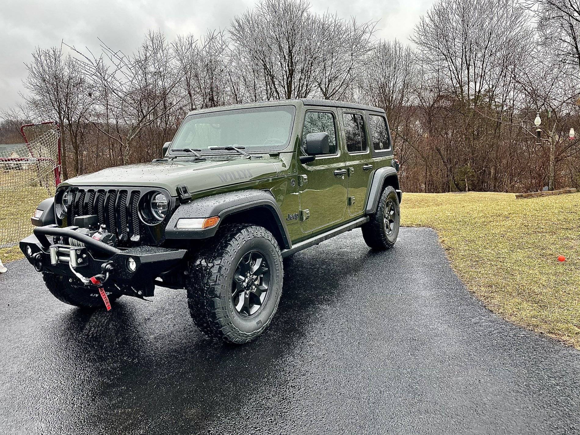

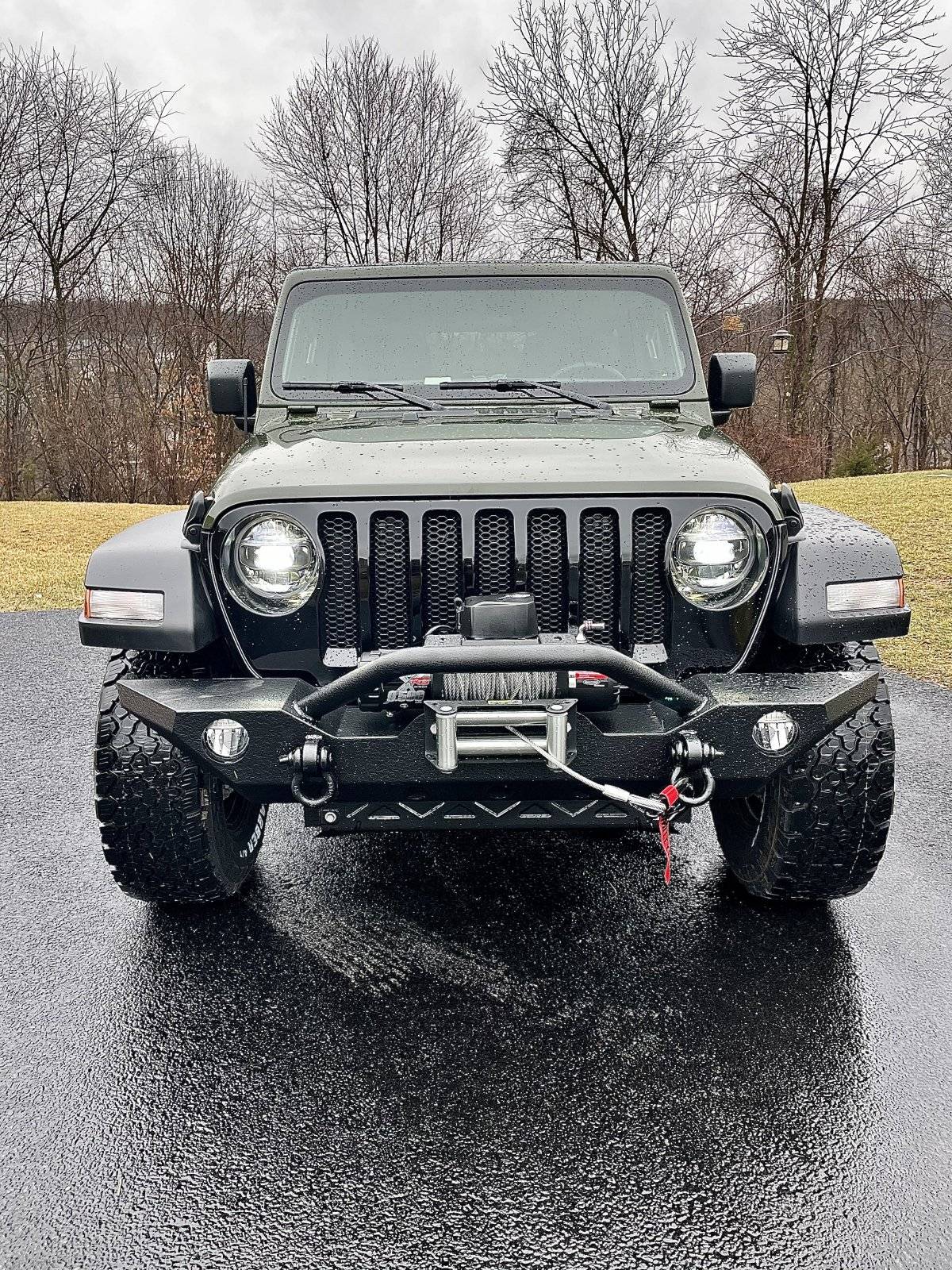

At great long last the winch is on and working! Switching out to synthetic when my hawse fairlead gets here! Thanks everyone for your help and tips!
Glad you are up and running, looks good. If you don't mind me asking what was the issue with the winch paying out the cable?
