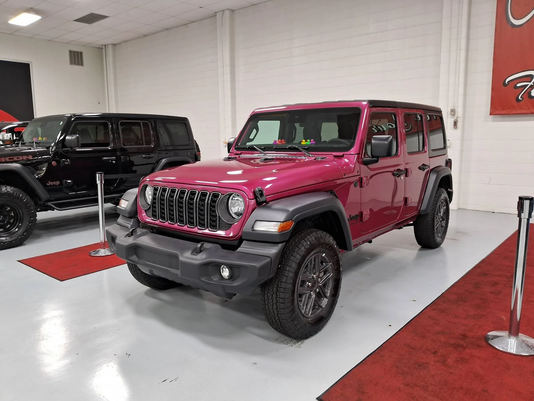

Today I got to deliver a new 2024 Sport S (in Tuscadero😁) automatic through the hills and twisties of Southern Missouri. I paid close attention to the shifting and the tach. Yep, it shifted a lot--sometimes downshifting two gears on steeper climbs. Most shifts were at about 2500 rpm, but the downshifts on the steeper hills let it scream at 3500 rpm. Wish I knew exactly which gear it was using at a given time, but I'm glad I had the opportunity to get an idea of how to manage my manual more effectively. 👍
You can check what gear the Auto is in by pulling the shifter to the left into manual mode. Then the D on the dash cluster will change to Mx, with x being the gear it is in. Just don't forget to put it back in Drive. It wont hurt anything if you leave it in manual. But the next time you come to a stop it will autmatically shift down into 2nd, but then wont shift as you speed up. You'll need to shift manually or push it back over to Drive.
