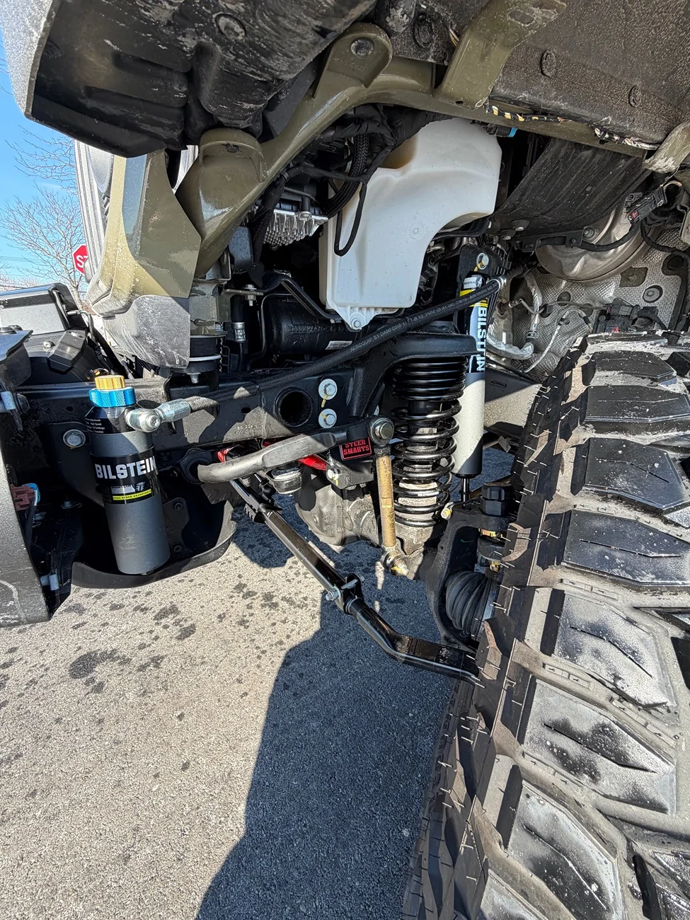

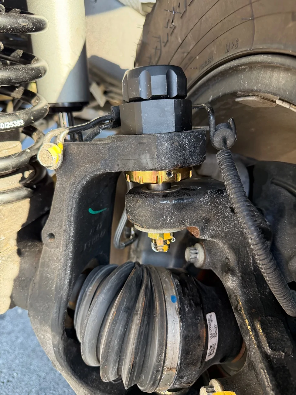

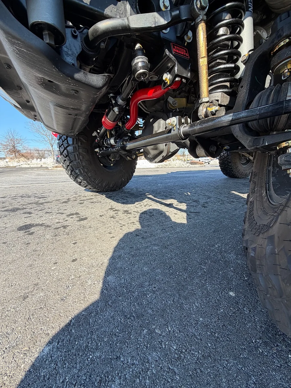

Bunch of new additions today to the rig. Wasn’t happy with how the Rocksport Red shocks rode, nothing wrong with them, but wanted something more adjustable. While I was in there, I thought I’ll also do my steering.
List of new additions and pictures attached:
  • Bilstein B8 8100 DSA full set
  • Fox Steering Stabilizer
  • SteerSmarts HD stuff:
    • Track bar
    • Drag Link
    • Tie Rod
    • Stabilizer Clamps etc
    • Sector Shaft
  • Metalcloak Stuff
    • DB3 Drop Brackets
    • HD Ball(er) Joints Set
  • Teraflex Spare Delete
  • Extended Stainless Steel brake lines
    • Track bar
    • Drag Link
    • Tie Rod
    • Sector Shaft
  • Metalcloak Stuff
    • DB3 Drop Brackets
Heck yeah! Those stinkin ball(er) joints are sick! I test drove a 4dr today for my wife and it had the AEV 2.5ā€ lift on it with the bilsteins I can’t remember if they were 5100s or the 8100s without the resi. But it drove so nice man. It soaked up speed bumps like a dogon prerunner. It was a 2.0 hard top and it was so noisy. More so than my 3.6 with no muffler.
They cut through road impurities like a knife through butter. I was so happy with how they rode as some people said they can be stiff due to diameter. My Jeep now rides like my Raptor used to on the Fox Live Valves.
Steering is also as tight as it can get with everything on now.
can’t comment on noise. The 2.0 is lawnmower but I put sound deadening all throughout the cabin so it’s not that bad.
