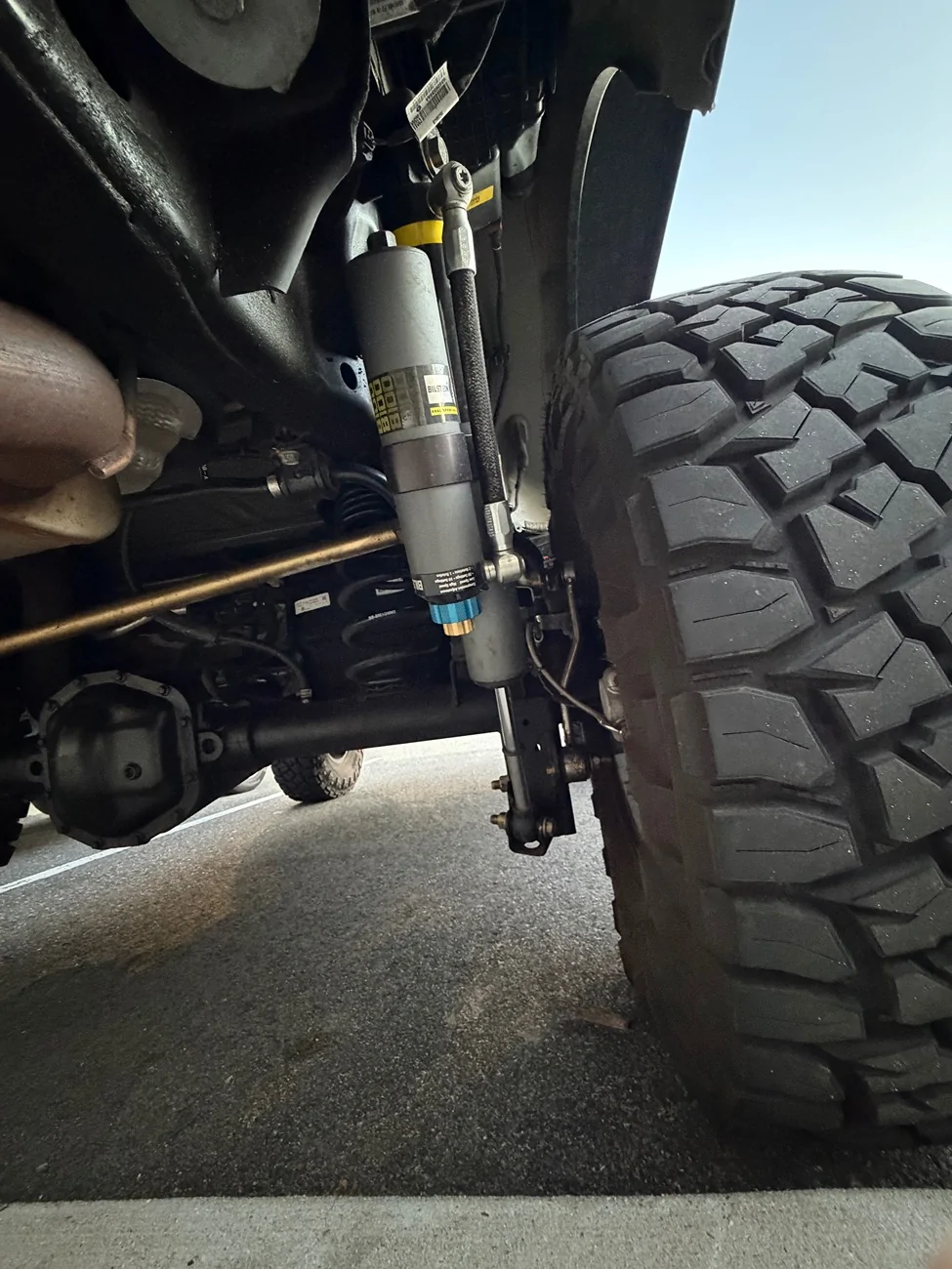

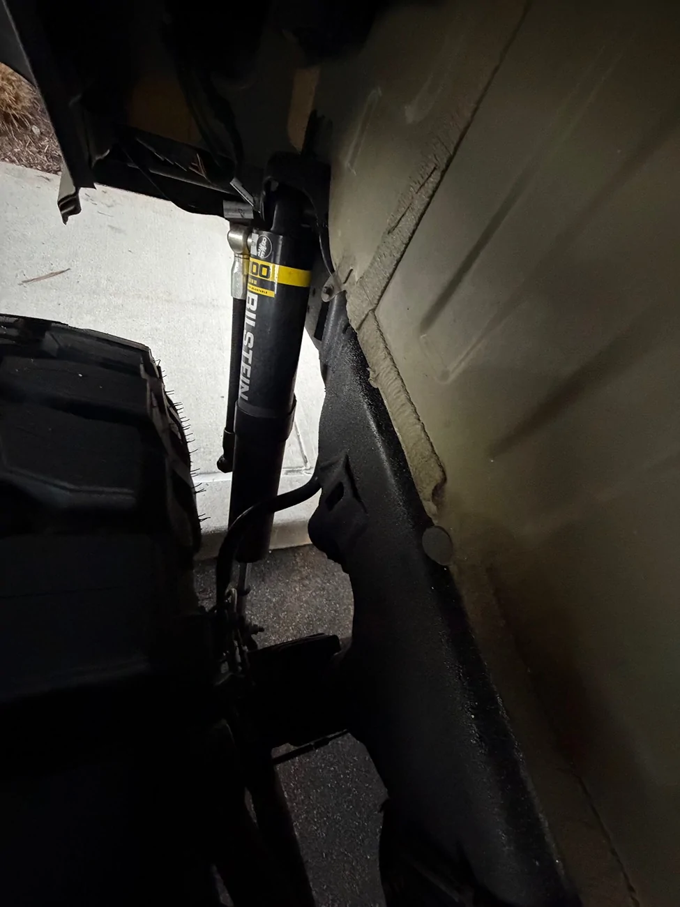

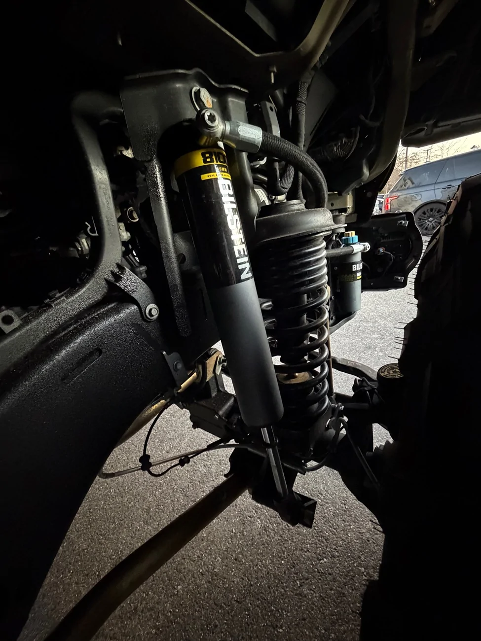

Thanks, I can't tell in your recent photos but did you use the Bilstein shock bottom relocation parts to move it outside the stock mount point?
Sorry for the delay - see attached pictures on how front and rear are mounted. The Metalcloak DB3 rear control arm drop brackets don’t fit MY24 and up.

I really appreciate you taking the time to post up those photos. That was exactly what I was looking for. I like the concept of the Metalcloak mounts that turn the eyelet 90 degrees on the front and was wanting to see what the Bilstein version looked like mounted, how far it stuck out, etc.
