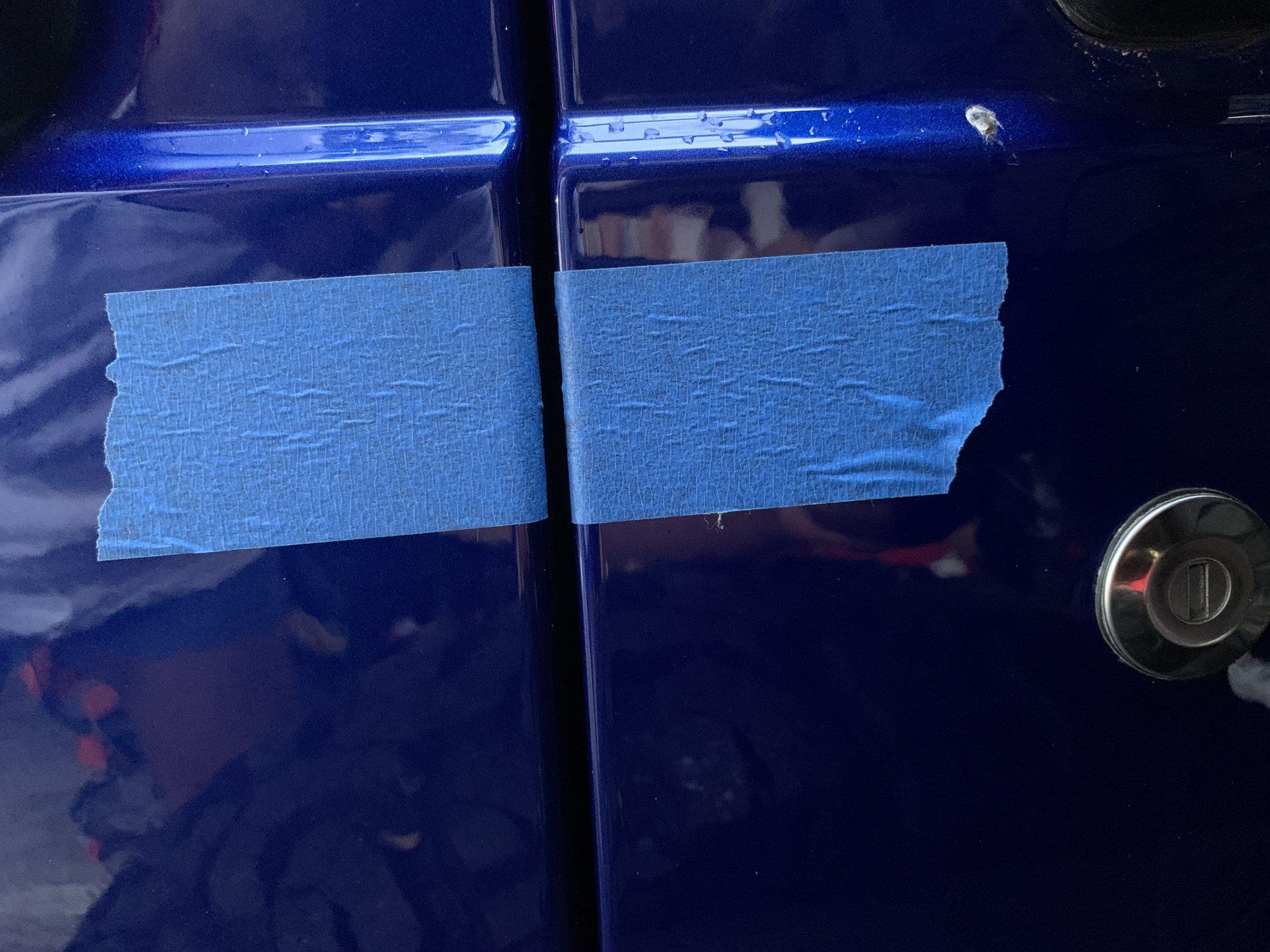

Any of you using anything to cover the gap left by the removal of the stock hinges? I saw some foam tape as one suggestion on another thread but just curious what the three of you are doing as I’m leaning towards this carrier to replace the Mopar set up + hockey puck hack to better secure the 37 spare. Any feedback on having the whole thing powder coated before install? I know some said rattle can spray might be better for easier touch up.
@Motobilt
Any suggestions on what to use to cover the gap left from the install?
I haven’t used anything to cover the gap either.

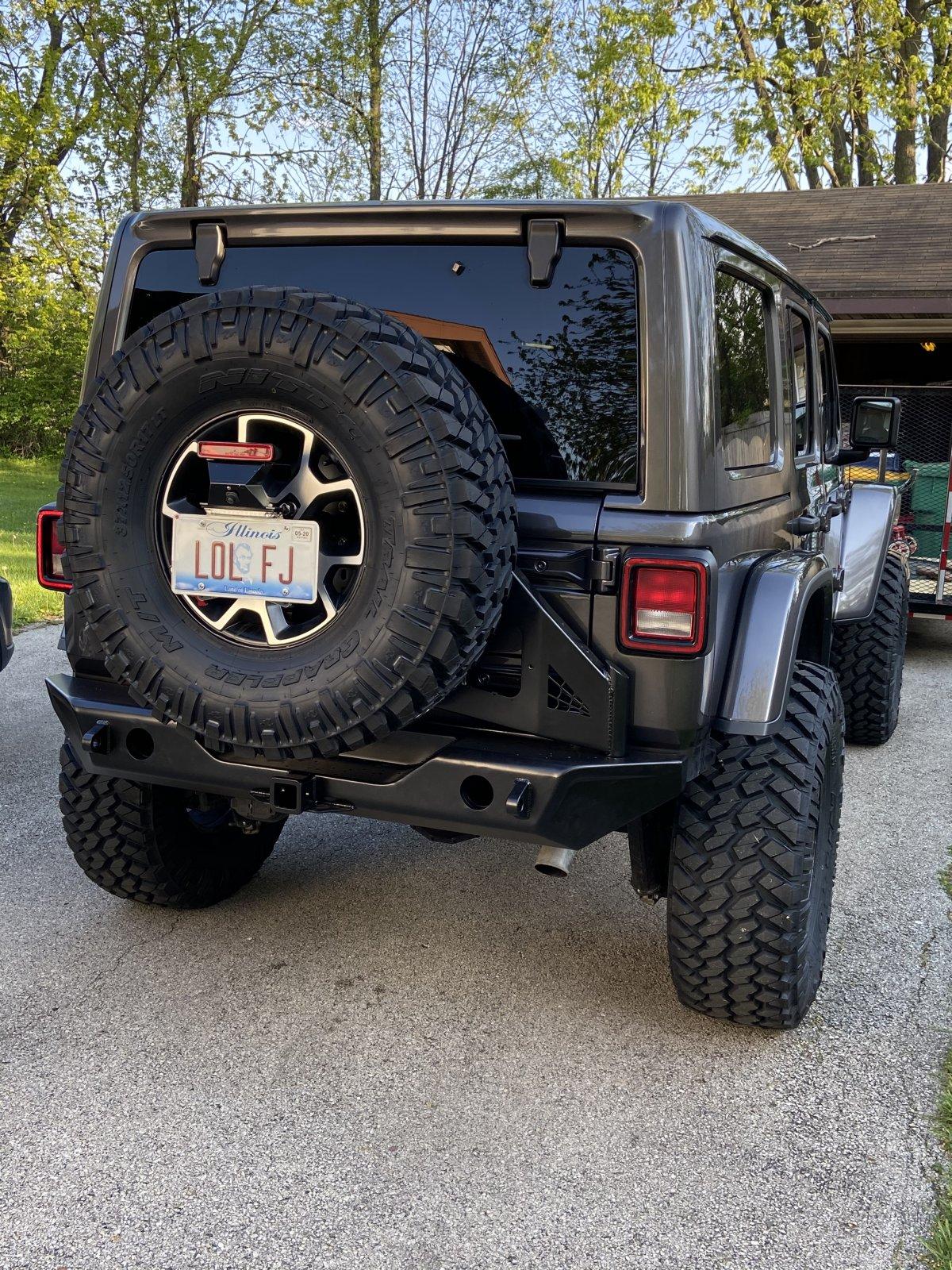

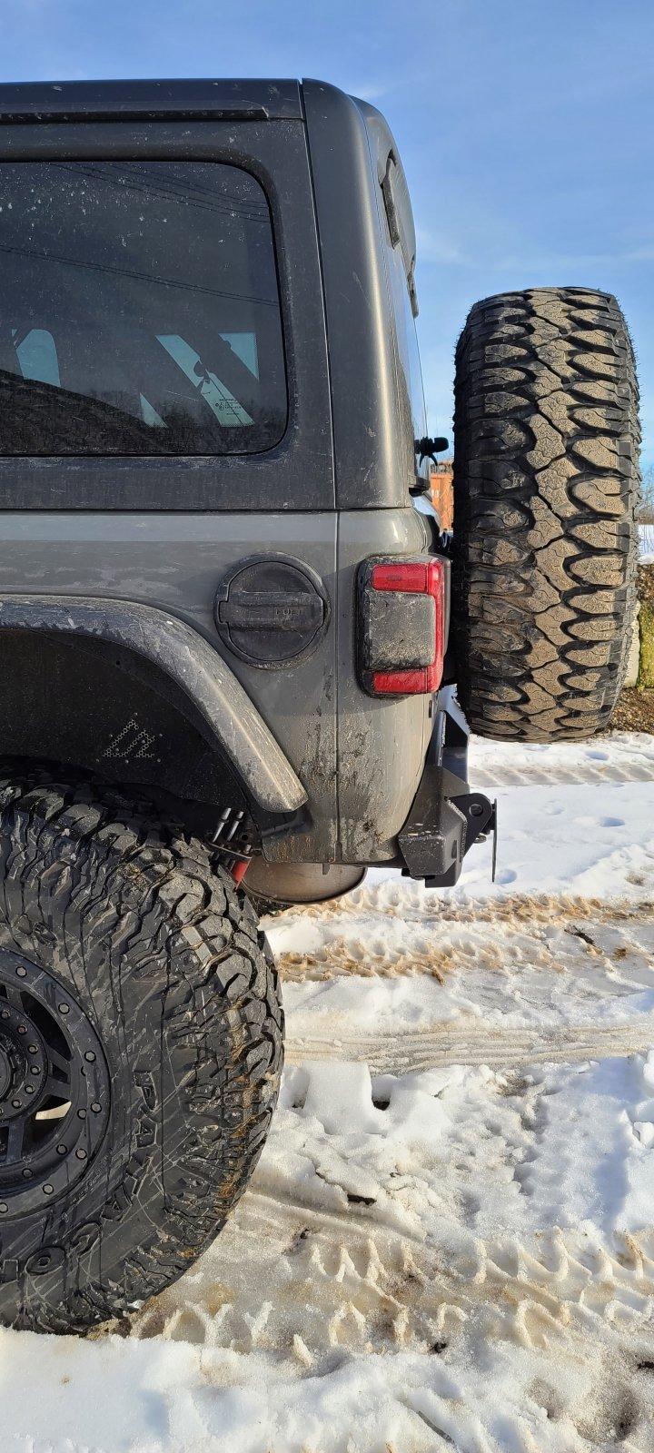

Just pulled the Teraflex Alpha HD carrier, because I can no longer wait for them to release the hinged tailgate reinforcement. I went with the Cavfab Elite complete unit, and had it powder coated to match the Mopar steel front bumper. The Jeep no longer notices the 38x13.5 spare. It's solid as a rock. I highly recommend their products. I also installed their Ultra High Clearance bumper at the same time. I opted for the highest setting, to favor drop off clearance.

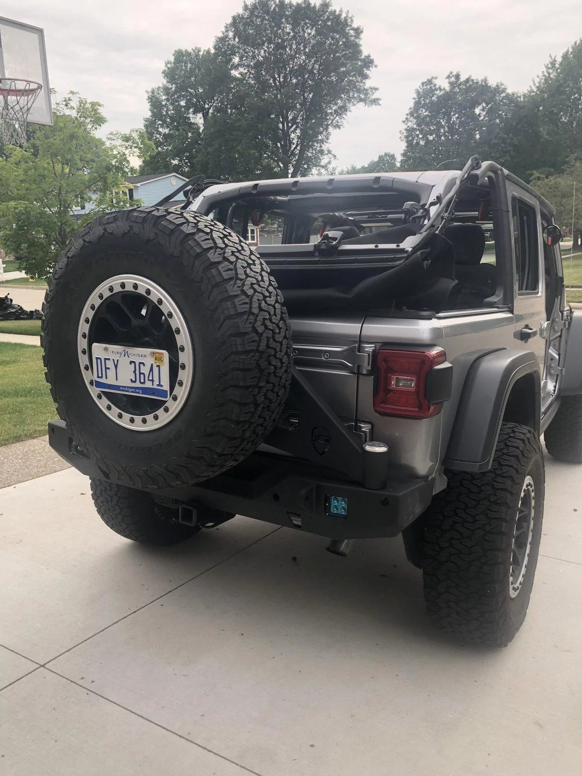

Anyone else with the poison spyder carrier have an annoying thumping noise when going over bumps at slow speeds? The tires tight on the carrier and everything is bolted down tight. I can’t seem to pinpoint the source of the noise though. Going over small potholes on a gravel road at like 15 makes the thing sound like it’s going to fall off.

Mine started quiet, then slowly started making more and more noise. Tightened up the turnbuckle a little and it's silent again. It won't feel like it's loose when you push on it by hand, but take that 100lb wheel and give it a good jolt going over a bump and it will move enough to knock. If that doesn't do it, the only other thing to check would be that your pivot bolt is tight.
Awesome. Thanks man. I’ll check that today after work and see how it goes. Definitely seems like it could be the culprit.
Qjoh5510
Quinn
Nov 28, 2019
279
240
Somewhere near Chicago, IL
2019 JLUR
Operator
So I tightened up the turn buckle a little bit and it helped tremendously. It still makes a little noise going over bigger bumps but all the chatter on washboard type surfaces and smaller bumps is gone. Thanks man.
