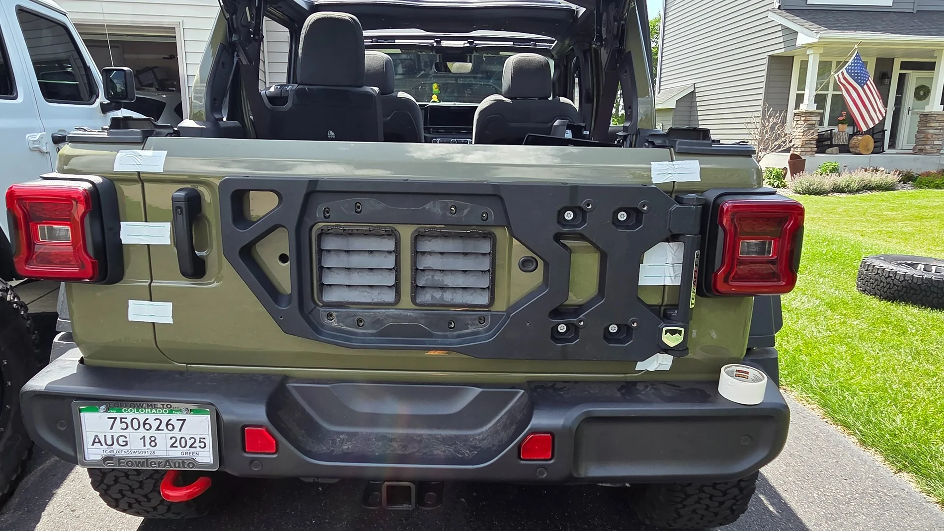

Well I was rotating the tires today and when the tire was off I moved the mount by pushing up and down. The noise definitely comes from torsion on the tailgate. I am guessing that this is why mopar made the bracket. To stiffen it up not to twist. I am guessing the alpha does a similar thing by bringing in the tire to stop that leverage or limit it.

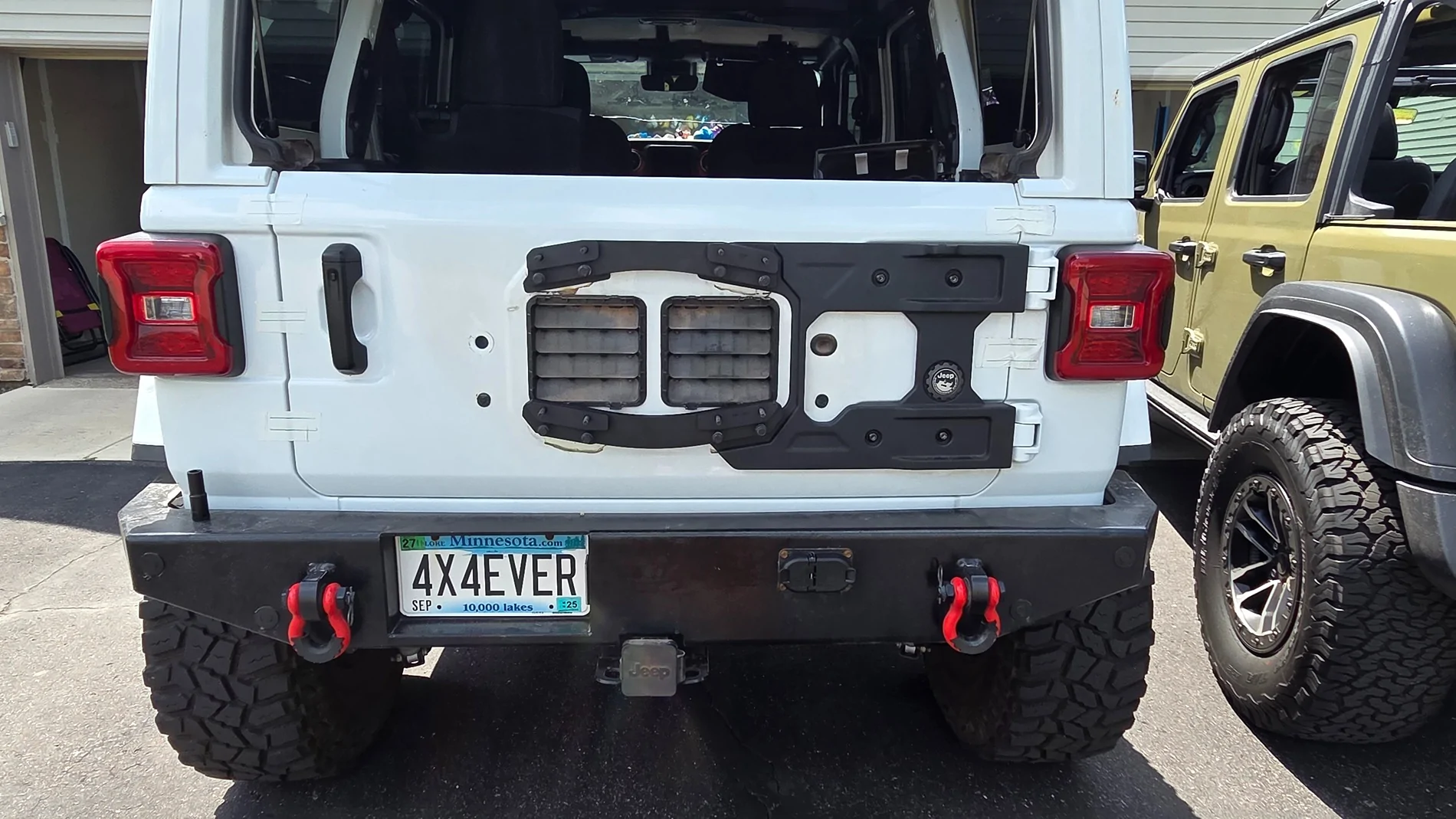

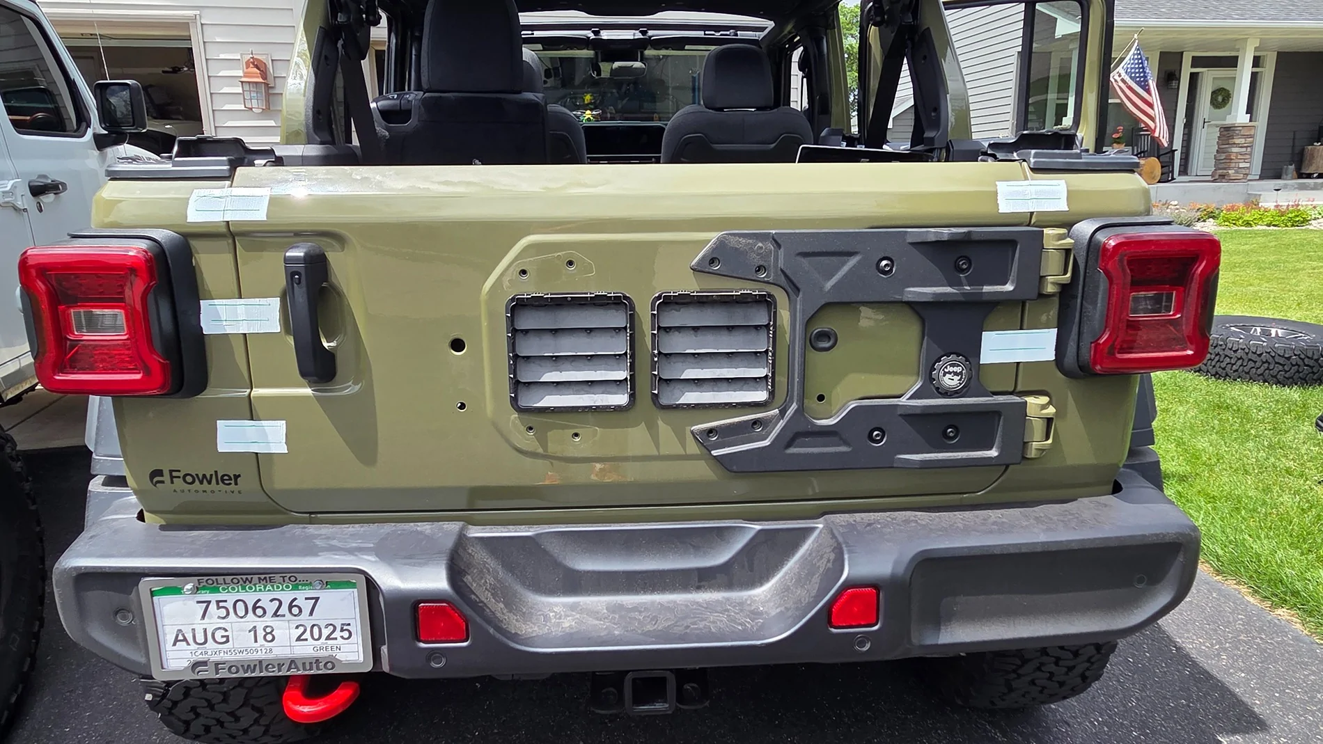

IMO the Mopar Hinge Gate Reinforcement pales in comparison to the Teraflex. I don't have a lot of experience with the Mopar, but I do currenly own both the Mopar and the Teraflex. I swapped them between my old Jeep (2021) and my new one (2025). The Mopar part addresses only the torsional stress a heavier tire places on the tailgate. It does minmal, if anything, to reinforce the hinges themselves.
The TF on the other hand addresses both the hinges and torsional stress on the tailgate. It is also much beefier than the Mopar and is all one piece that extends from the hinges, past the tire carrier itself, adding far more torsional rigidity.
The Mopar reinforcement is about half the size, and thickness of the Teraflex. The Mopar extends only to the tire carrier (first pic), and then there are multiple pieces that complete it, where the tire carrier gets mounted (second pic). But they are disconnected from the main reinforcement piece and they are really just spacers for the tire mount.
Maybe the Mopar is "good enough", but the TF adds a lot of reassurance. It is a beast!!
Jeep Wrangler JL Teraflex Alpha HD VS. Mopar Relocation Bracket 20250622_122048
Jeep Wrangler JL Teraflex Alpha HD VS. Mopar Relocation Bracket 20250622_144531
The Teraflex:
Jeep Wrangler JL Teraflex Alpha HD VS. Mopar Relocation Bracket 20250622_144538

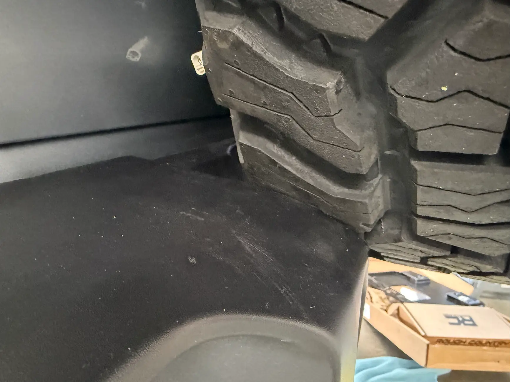

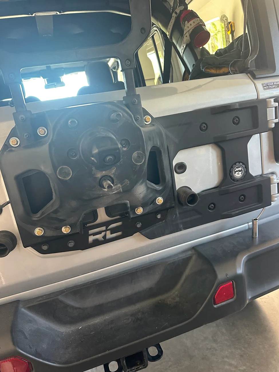

I have a mopar hinge and Rough country relocation bracket...It fits fine with that but I was hoping maybe I could get by without the relocation bracket...the rough country relocation bracket is actually well made and made in the USA. I was just hoping I could get by without the relocation bracket because it pushes the tire out an inch and up 2.25" other than that it works great.
Jeep Wrangler JL Teraflex Alpha HD VS. Mopar Relocation Bracket tempImagebBGcVh
Jeep Wrangler JL Teraflex Alpha HD VS. Mopar Relocation Bracket tempImageTf5Hd5
