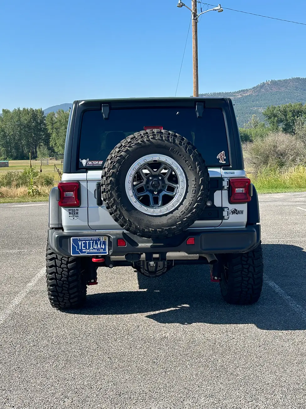

I have a mopar heavy duty hinge and Rough country relocation bracket and rock solid with a Mickey Thompson 35 and AEV wheel combined weight 108lbs. I put some extensions inside the bumps and the tire is solid..
No creaks or rattles off-road?

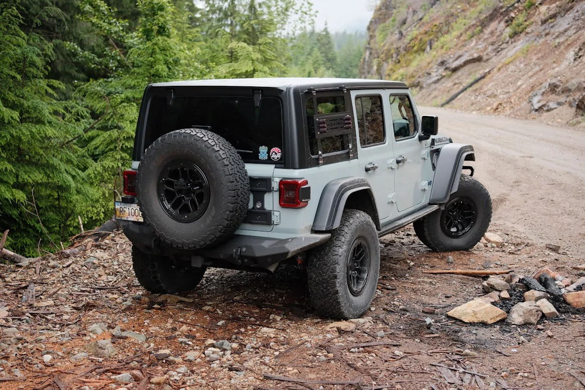

I run the mopar hd reinforcement bracket and 64lb 37s (with lighter wheel 28-30lb)
It has been squeak/rattle free
