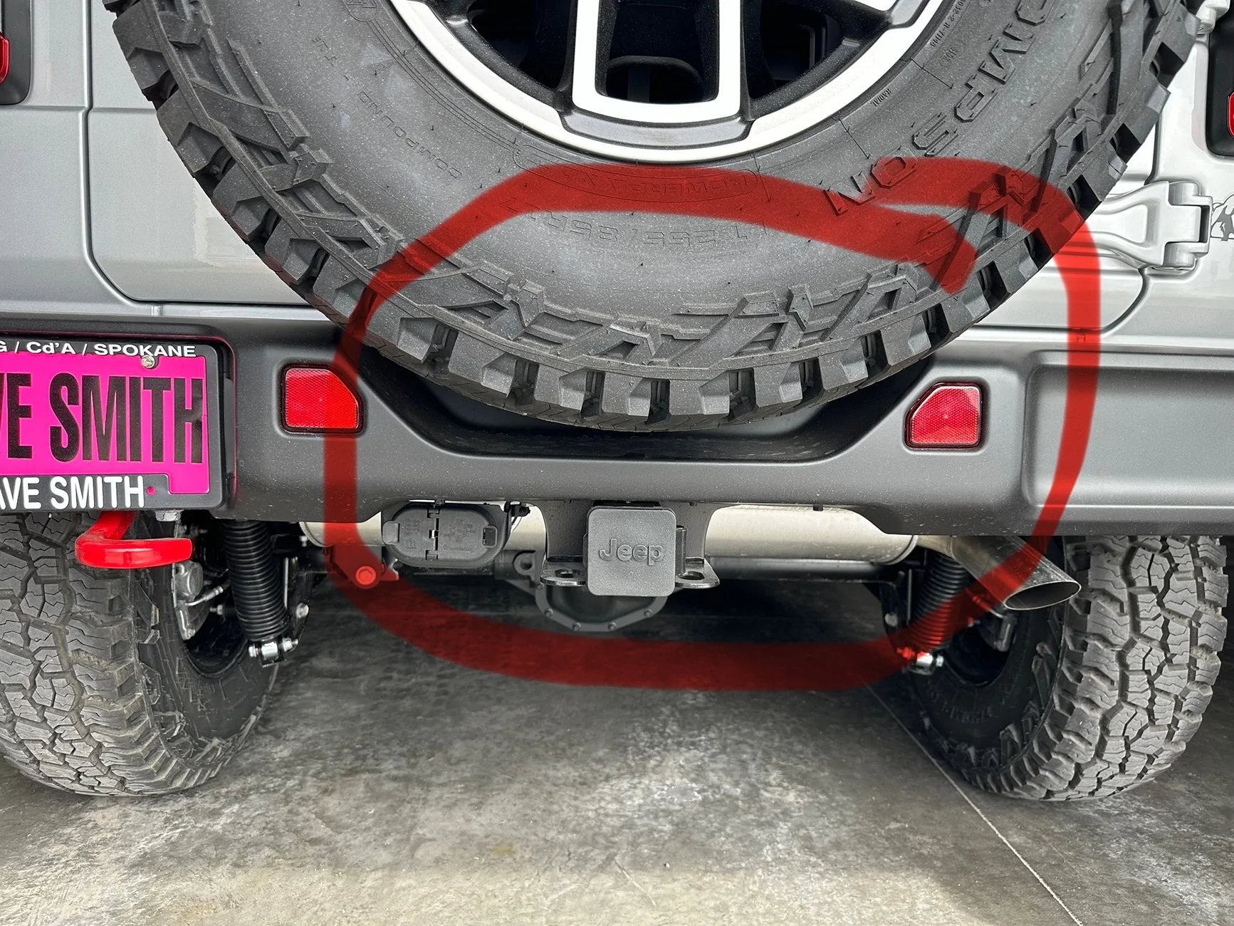

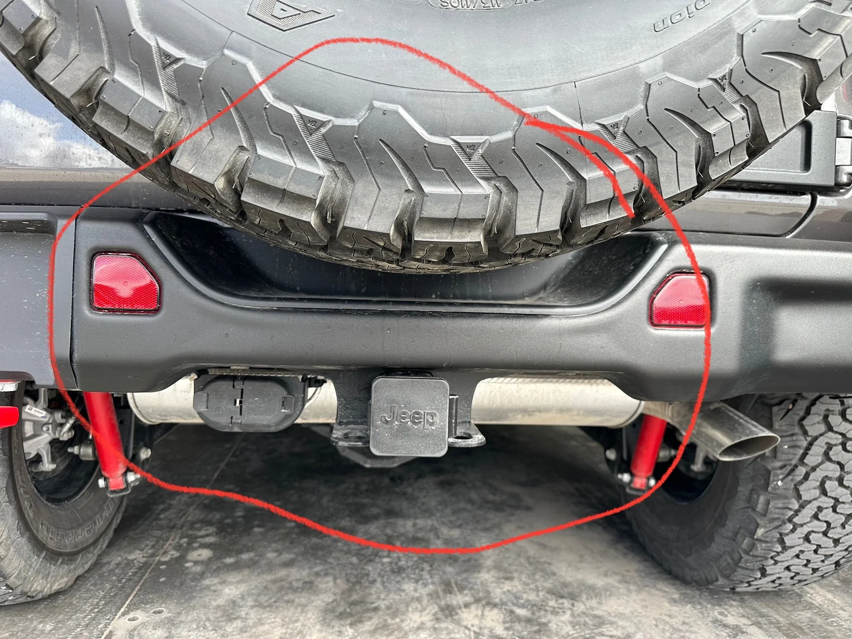

they designed it to give more clearance and breakover perhaps 🤷‍♂️
the bumpers are the same where clearance offroading for departure would be the same...it is the cut out for the spare that is thicker on the steal bumper..the lower one has stock rubicon carrier with a tall 35. the top is the XR package with 315/70-17. you can see the bottom of the bumper is the same as far as how far down they hang. just the the bottom of the cut out has more thickness on the top side..
