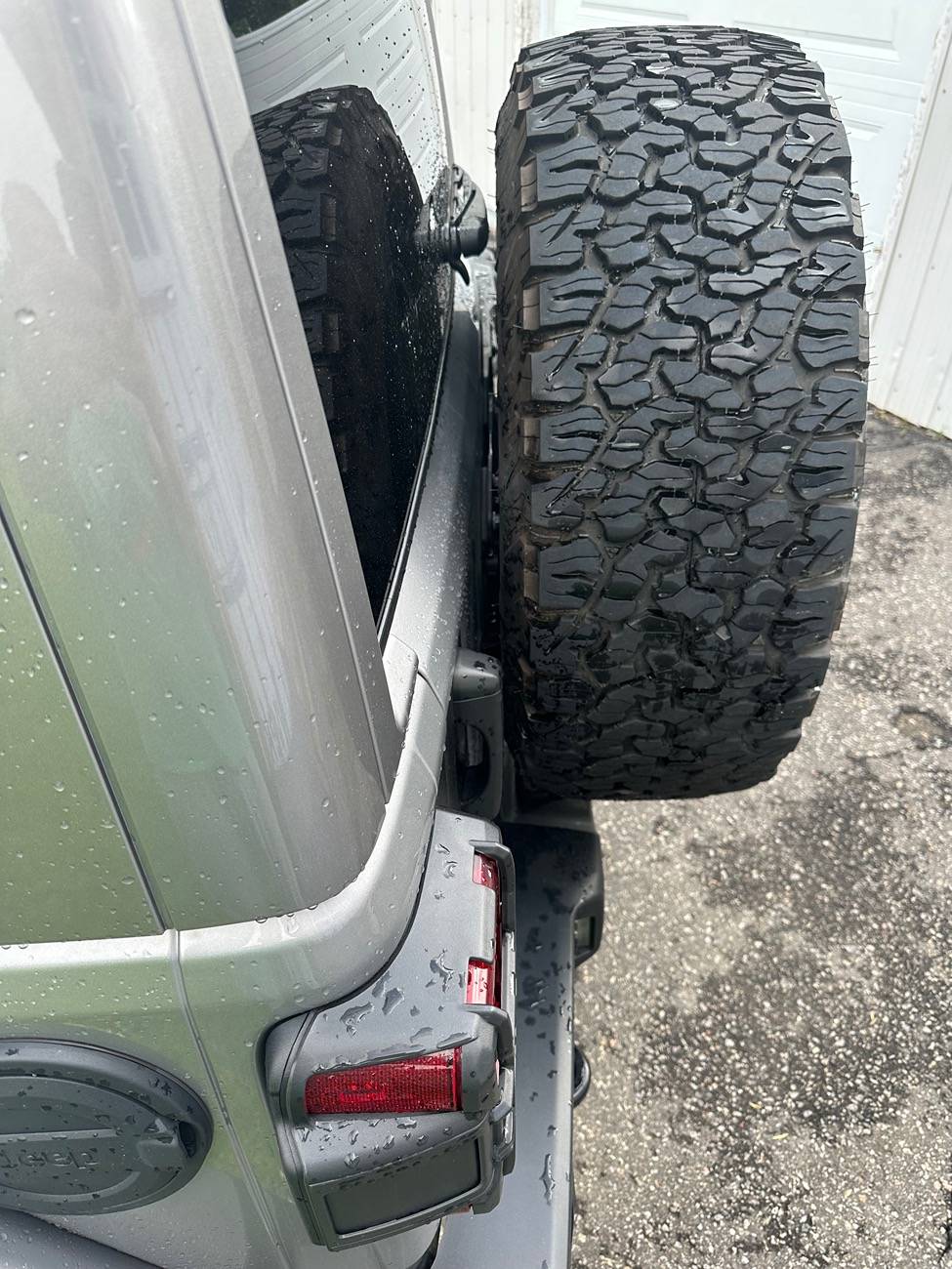

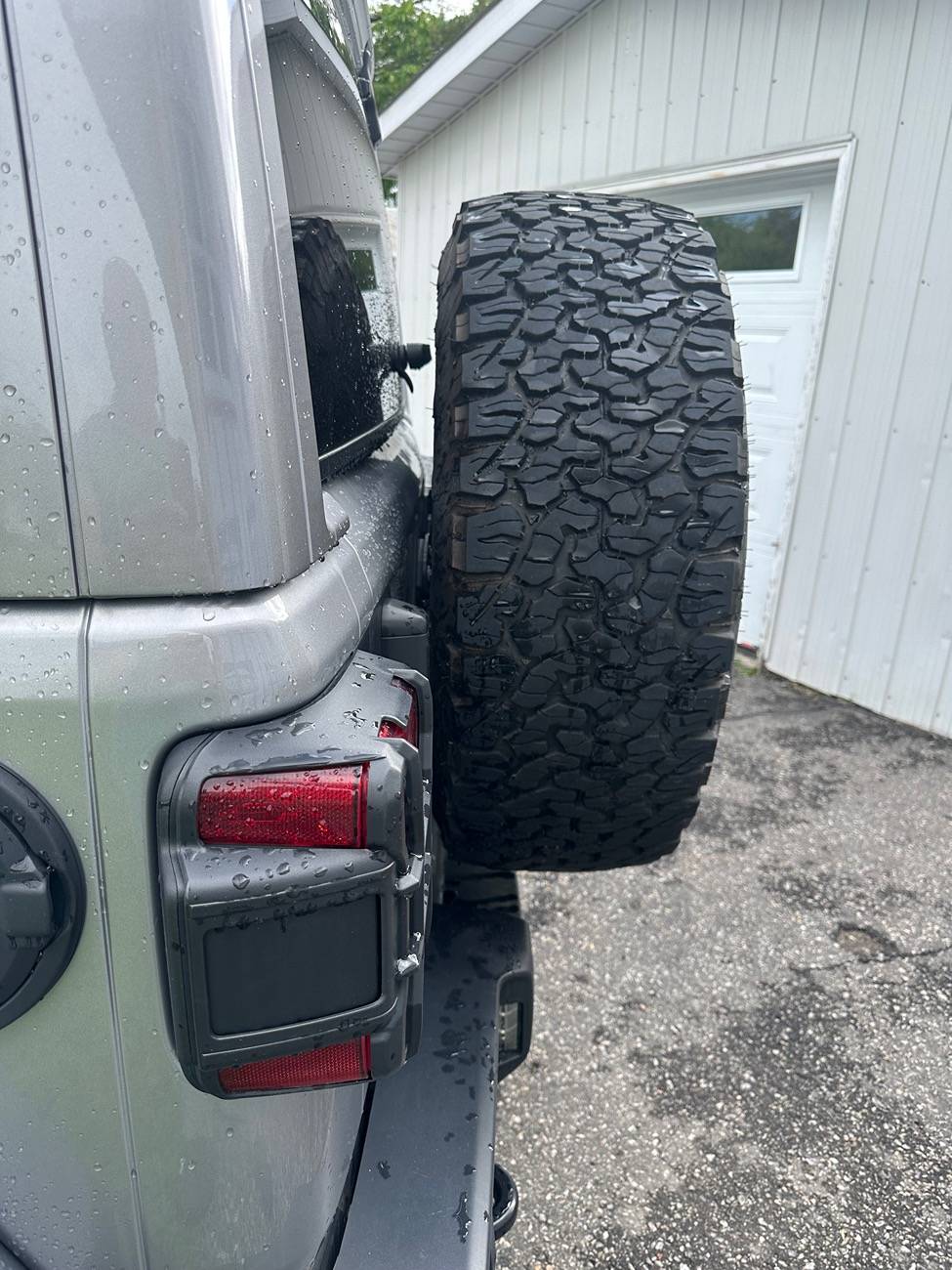

Jeep Wrangler JL teraflex alpha hd questions 20240716_190626
All this time I thought I had posted a pic of my install. And as usual, I didn't. But yeah, this was one of the smartest purchases to date.
