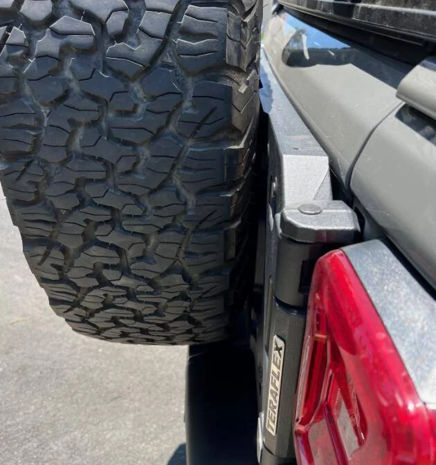

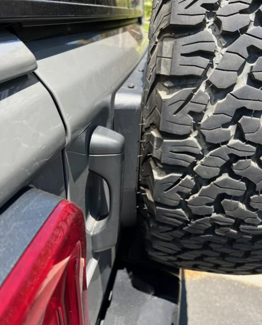

No problem! Here's a pic that shows pretty well how tight it is, and those are the OEM bumpers in there with no extensions. I had to use the uppermost set of holes to keep my backup sensors from going off, as they were intermittent when using the middle set. I liked having the tire a little lower, but since I'm planning on 37's before too much longer it'll just already be ready to go, lol. My tires actually measure out at 35.1", so I would try the middle set first depending on your tire size and just don't use the Loctite on the studs until you're sure of where you want to leave it.
I'm not using big tires. 285/70-17's. But that -12mm offset plays havoc with the park assist. Or, it did, I did rotate the wheel weights away from the sensors, and that seems to be working. I just want to make this carrier work properly, even after a rotation. Cause the only person who would be paying attention to the weights would b e me. Thanks for the pic. Clearly shows this carrier mount to do what I want/need.
