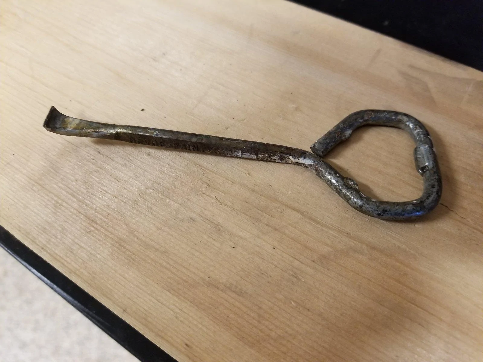

I had trouble removing the plug, so looked around the garage for something to help ... ended up using a paint can opener to remove the plugs from a Mini.
I hold the can opener such that shaft is along my thumb with the bent tip right at the end of my thumb. Use my pointer finger to depress the tab, with the bent tip catching the ridge on the opposite side. Then simply rock the plug and pull down. The bent tip provides a good grip on the plug.
You can use it to open your beer when done, too. :beer:
Paint can opener? Thats a beer bottle opener. Get your head on right man! :)
