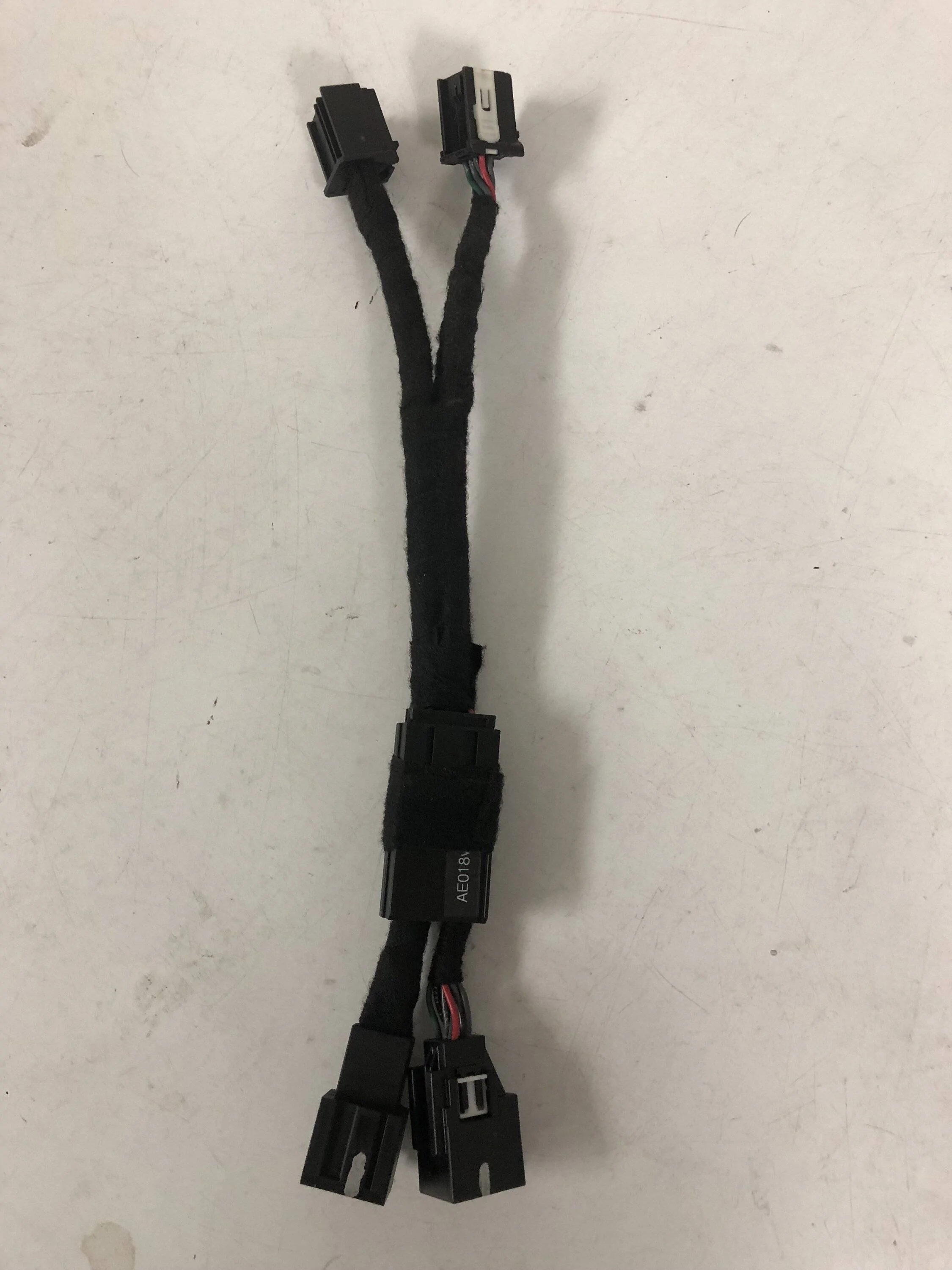

So I purchased the Tazer SGW connection cables and created my own modified cable using half of the Tazer extension cable and the autostopstart eliminator cable. I did this to avoid having another length of cable under the dash.
I’m using Jscan with the ECRI security gateway bypass with the ECRI mount from Click on PC (Etsy), and the Vgate vLinker MC+ OBD2 scan tool. Not ideal but I leave the extension cables plugged in since the autostopstart is my priority. I use the ECRI bypass only when I need to use JSCAN.
So far no “hiccups“ as @Rhinebeck01 would say. Time will tell.
